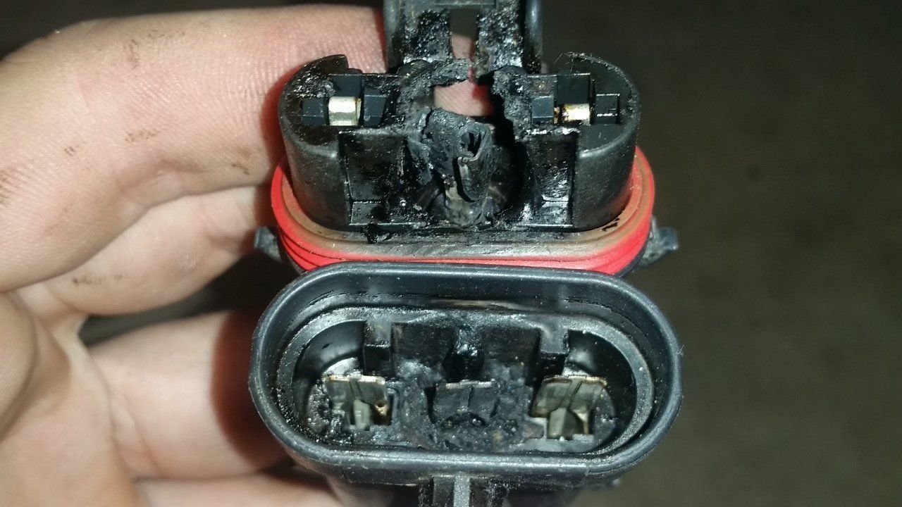

FatsWaller's Avatar
FatsWaller
Joined: Aug 2017
Posts: 4,927
Likes: 2,334
From: Etobicoke (Toronto) Ontario
Most likely this is what you’re going to find

Two very different things. C6 Corvettes do not have a fan relay.
