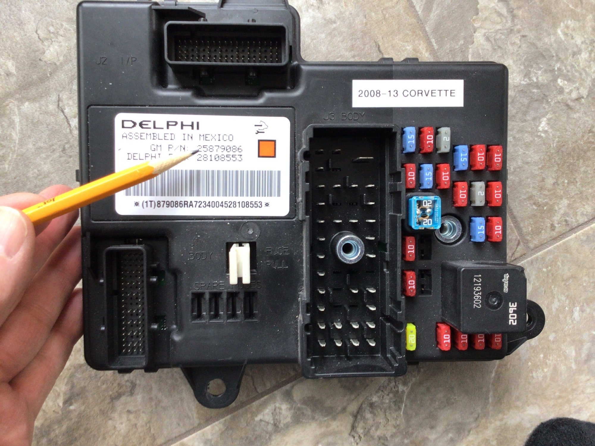

Here is a picture of one in my possession. The pencil is pointing to the identification numbers that are relevant.
I agree with taking it to a diagnostic specialist first. 👍
