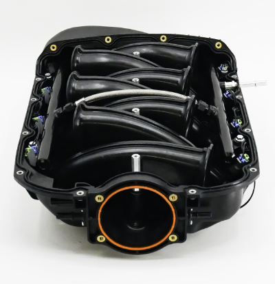

So anyone planing on trying one of these out? Everything I'm reading seems pretty positive, gains on a stock LS3, cool design, fits under a c6 cowl. Pretty cool how it hides the fuel rails too... Curious to see if anyone else is thinking about pulling the trigger on one.

Ofcourse, the price is right at $1000 too so def makes it a competitor for FAST and MSD... im really curious to see some real world testing. Looks like they may just be in preproduction at the moment.

It will be interesting reading some testing and I wonder if fuel stays cooler/warmer and if the rail location cools/heats the air charge at all.

I guess the number 8 intake runner is hidden?
Hmm just noticed that, must be under the back piece
Yes, it is hidden under the rear cap. Technically that is number 7 as the driver's side bank is the odd numbers, but I know what you mean.
If it's the furthest one away from the throttle body, wouldn't that have to be #8?
The left bank is 1, 3, 5, 7. The right bank is 2, 4, 6, 8.

The runner that's hidden is either #8 or #1. No way it's #7. You're looking at the bottom of the intake manifold, maybe?

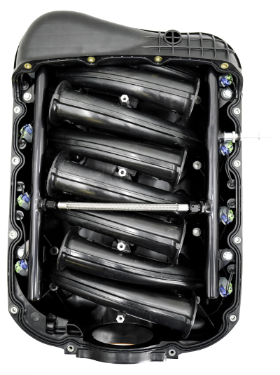

The key here is the longer runners to me
"In developing the XS intake, Performance Design tested three different runner lengths ("A," "B," and "C") and discovered that using all three mixed between the cylinders offered the best overall performance. The result is a power curve that, according to Performance Design, boosts output everywhere. The company states that on a completely stock LS3 rec-port engine the XS intake is worth 8 to 10 numbers (both torque and horsepower) over a stock baseline across the entire usable torque/power band—something no aftermarket LS3 intake has ever promised or delivered. The company also states that adding a bigger cam, better cylinder heads, boost, and a free-flowing exhaust only accentuates those gains across the power band. We'll know for sure when our test unit arrives!"

I wonder if the different runner lengths need to be changed around to suite different combinations.
