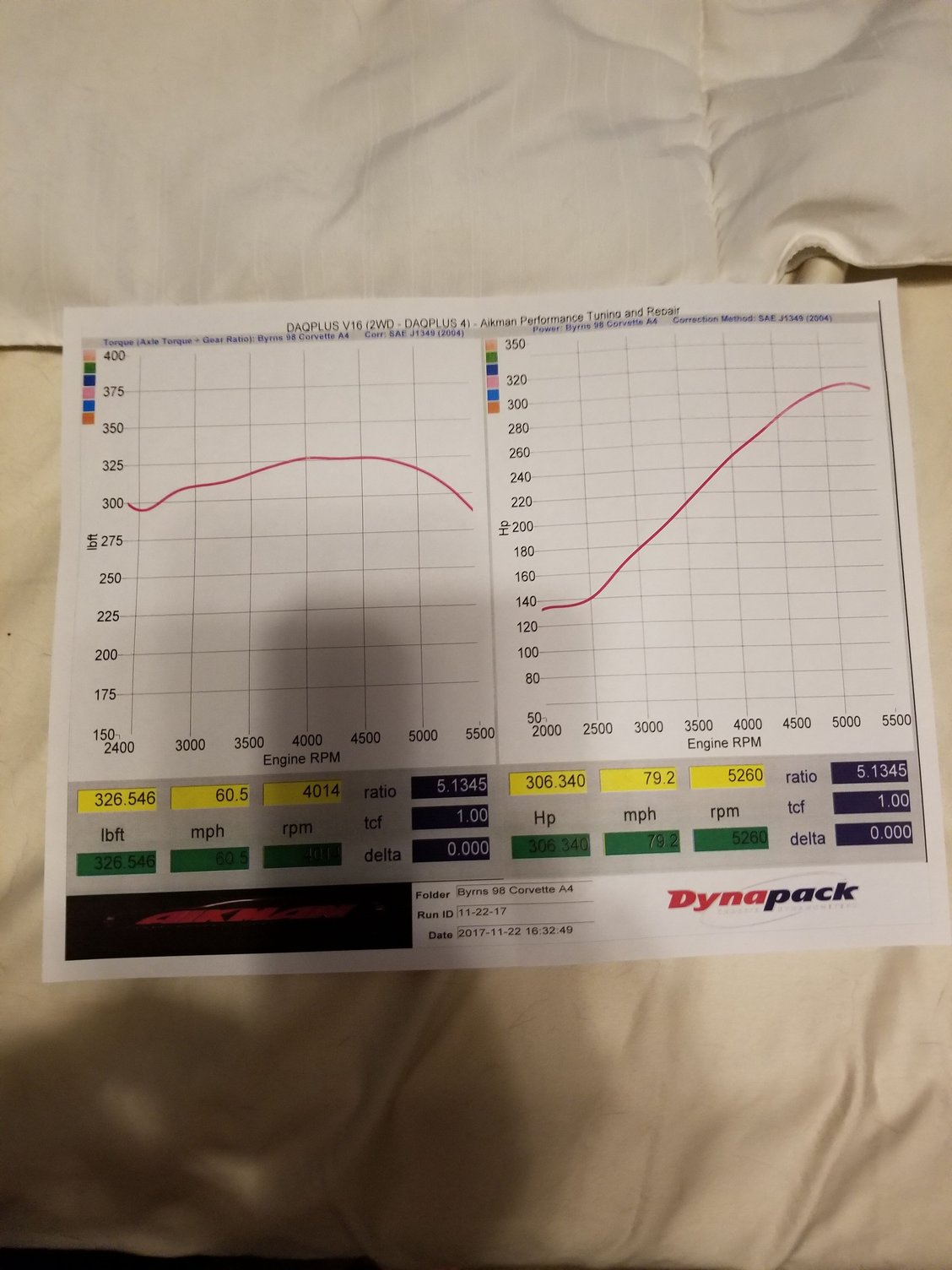

Those stock number seem low my c5 98 with no mods was 317 hp at the wheels
He has an LS2 though.....
My 2000 Z28 with long tubes and tune went 350ish RWHP....... I would figure the numbers I posted would be close and conservative.

sirdano's Avatar
sirdano
Posts: 2,290
Likes: 231
From: Round Rock Texas
