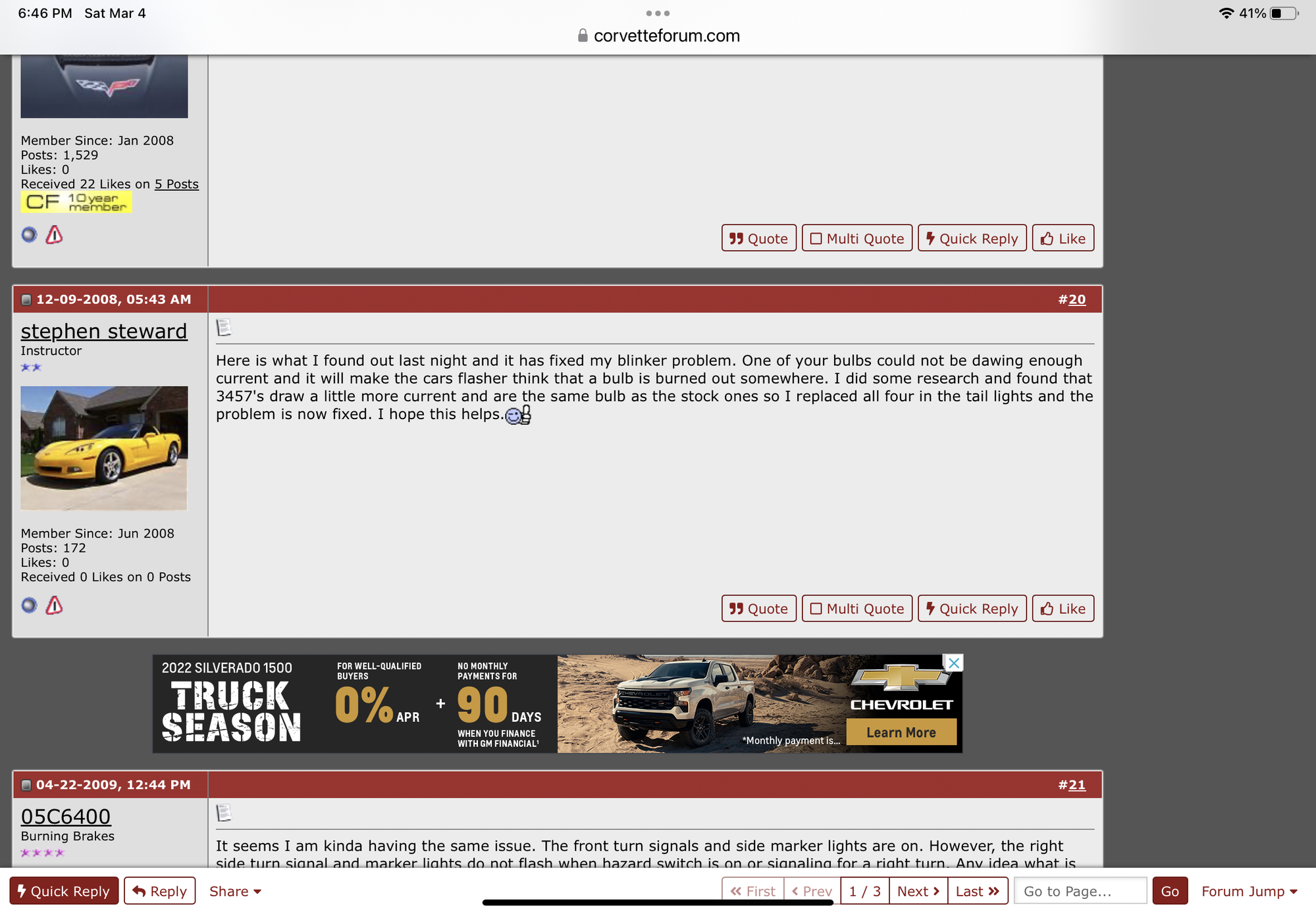

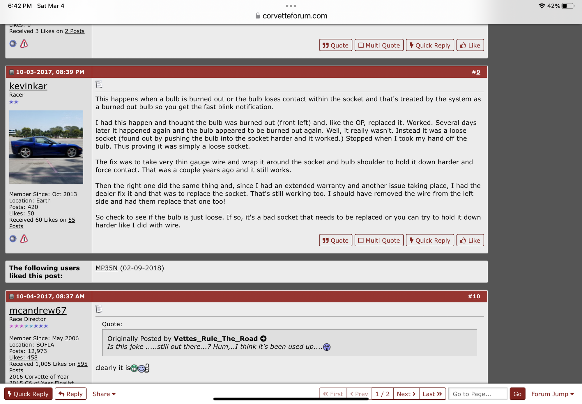

Saw this. Hope it helps.

Great information. Going tomorrow to buy all new bulbs front and back to replace the old ones. I'll let you know. Thanks
