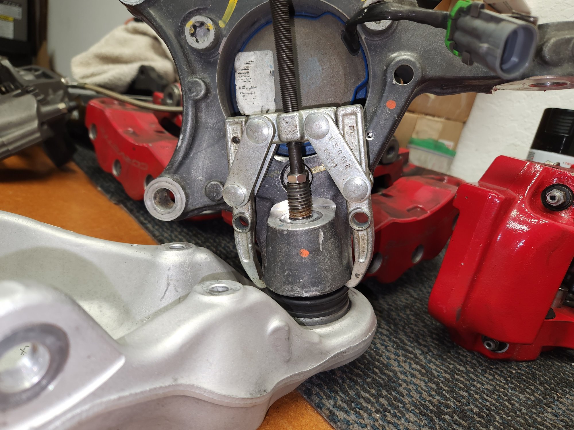

Next time try a simple 2 arm wheel puller. It always works for me.
Notice the nut that protects the ball joint hex key socket.
