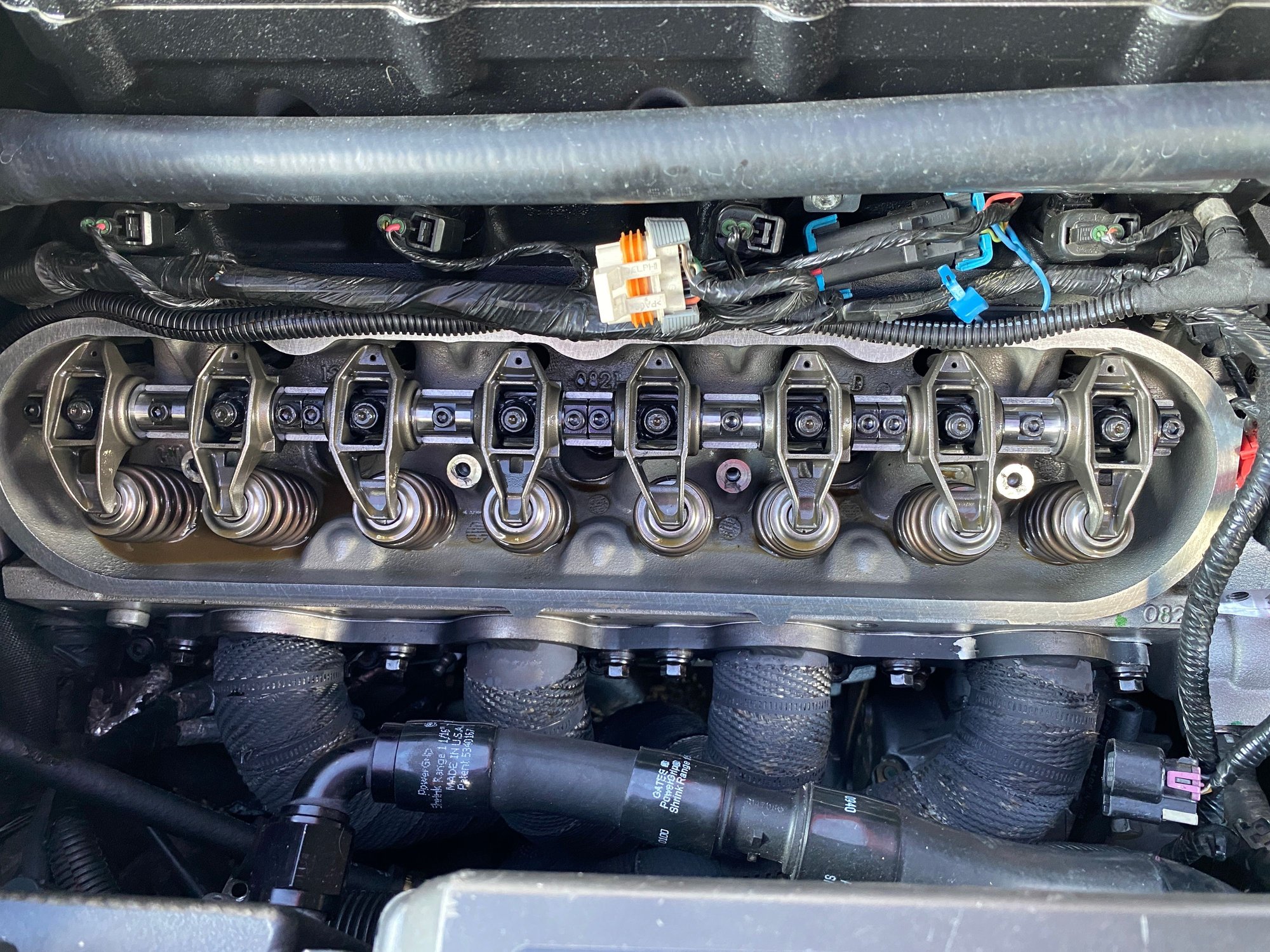

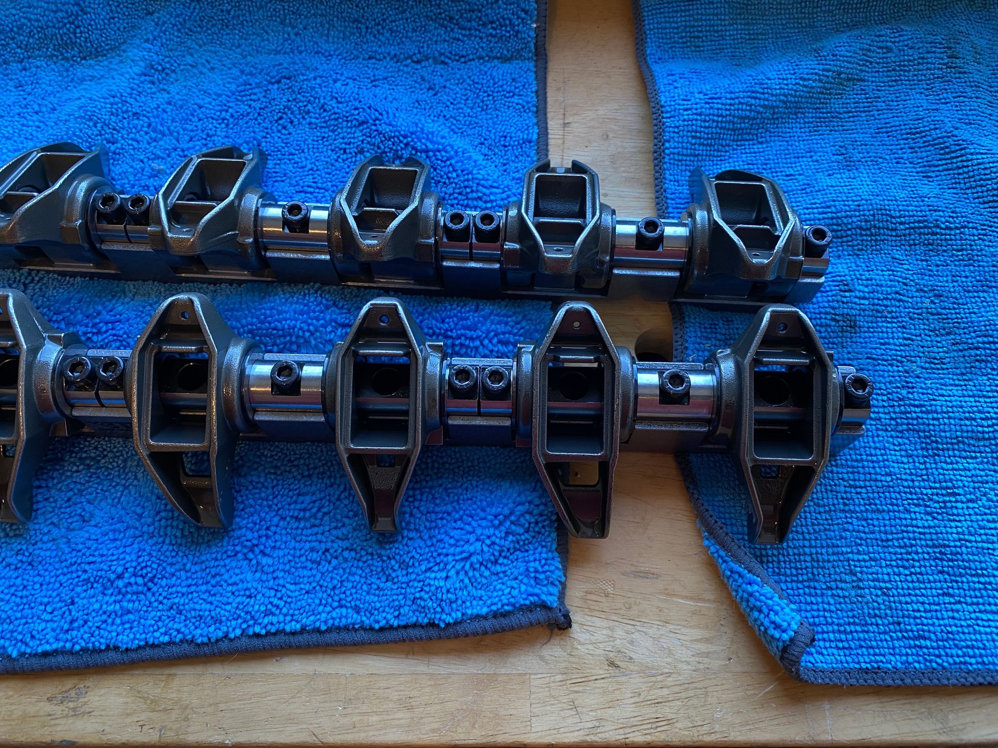

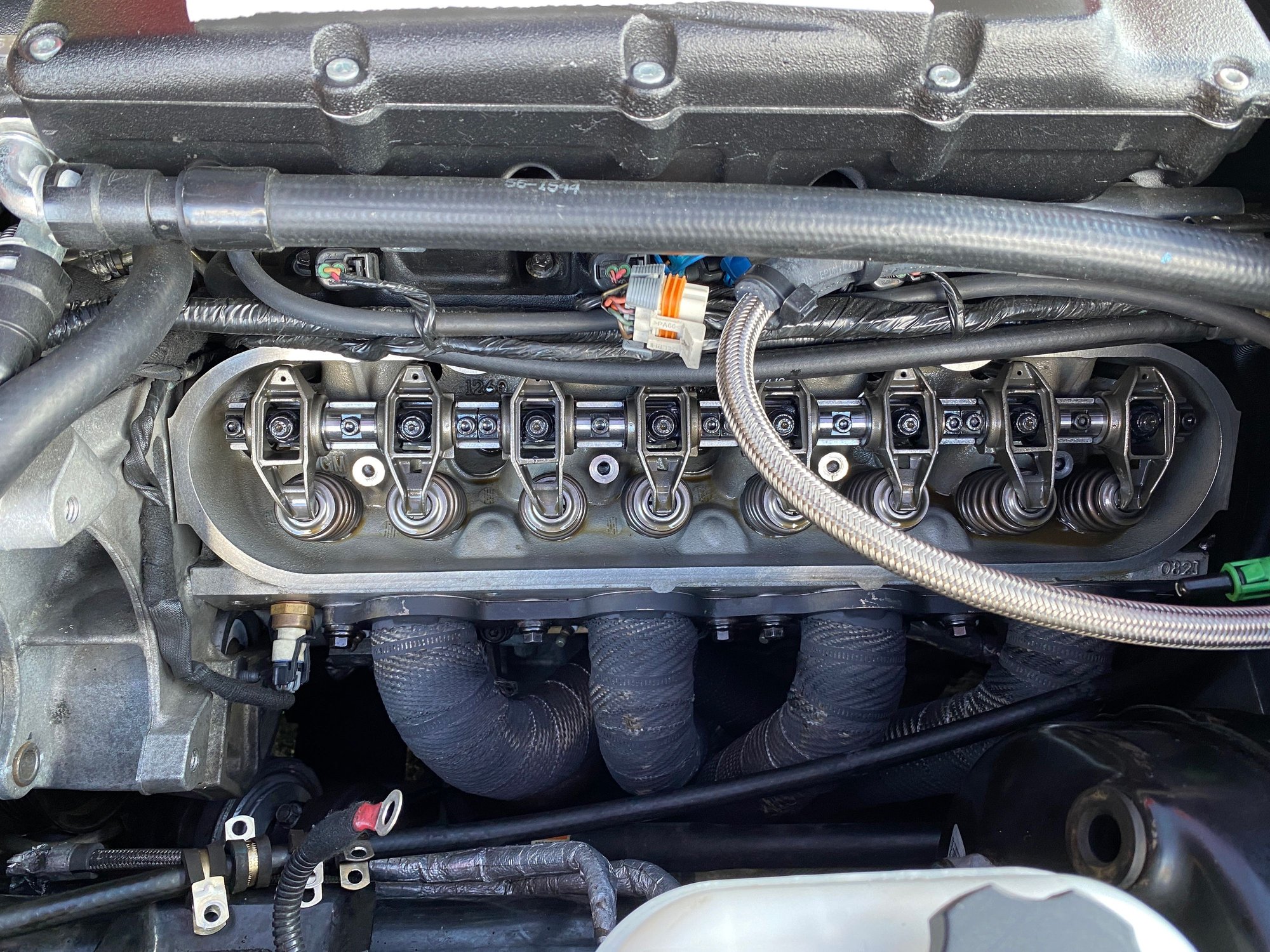

Also, installed the BTR shaft rocker bearing kit. Its something I had been wanting to do for a while. It very well made and fit perfect. Pretty much eliminates any side to side deflection of the rocker arms. No change needed to the pushrod length. Install was also very easy. Use my vice to press out the old bearings using a Summit Racing tool. Pressed in the new bearings and installed pair of rocker arms onto the support. That then went onto the heads as a single assembly. I upgraded to ARP studs previously so it made install very quick. Just was careful to tighten all the nuts a little at a time.
Started up just fine and no noises. Will drive the car the next several days and monitor things.
In regards to the pushrod length I used with the Morels, it was a 7.375. Switching to the Johnson's, preload was at 0.050 with the same length rods so no change needed there.
Passengers side shaft rockers installed.
Both rocker assemblies.
