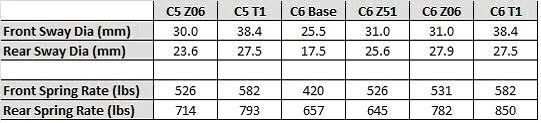

Does anybody know the front and rear spring rates for the Z06? I have a 2006 but rates for any year would be helpful.

One vendor says 526 lb/in on the front for C6 Z06. Still looking for the rear but I've got $5 that says it's similar given this car's weight distribution.

I found this page. It says the following:
Front C6 Z06 spring rate: 526 lb/in
Rear C6 Z06 spring rate:: 782 lb/in
This is similar to the coilovers installed by my Z06's previous owner: 700 lb/in rear and 500 lb/in front.

From what I've read, you can't compare the spring rates of the leaf springs to coilovers. Same rate will feel different between the two types of spring.
I don't think GM ever published the spring rates and I've seen too many variations of this chart to believe any of them, frankly. I've definitely seen the rates you posted before too.
You read correctly. No comparison between leaf spring numbers and coil spring numbers.
I have 400 Lb/in rear coilovers on my GS ... If I ever were to install 700+ Lb/in coilovers in the rear, the car would ride as hard as a logging truck !
