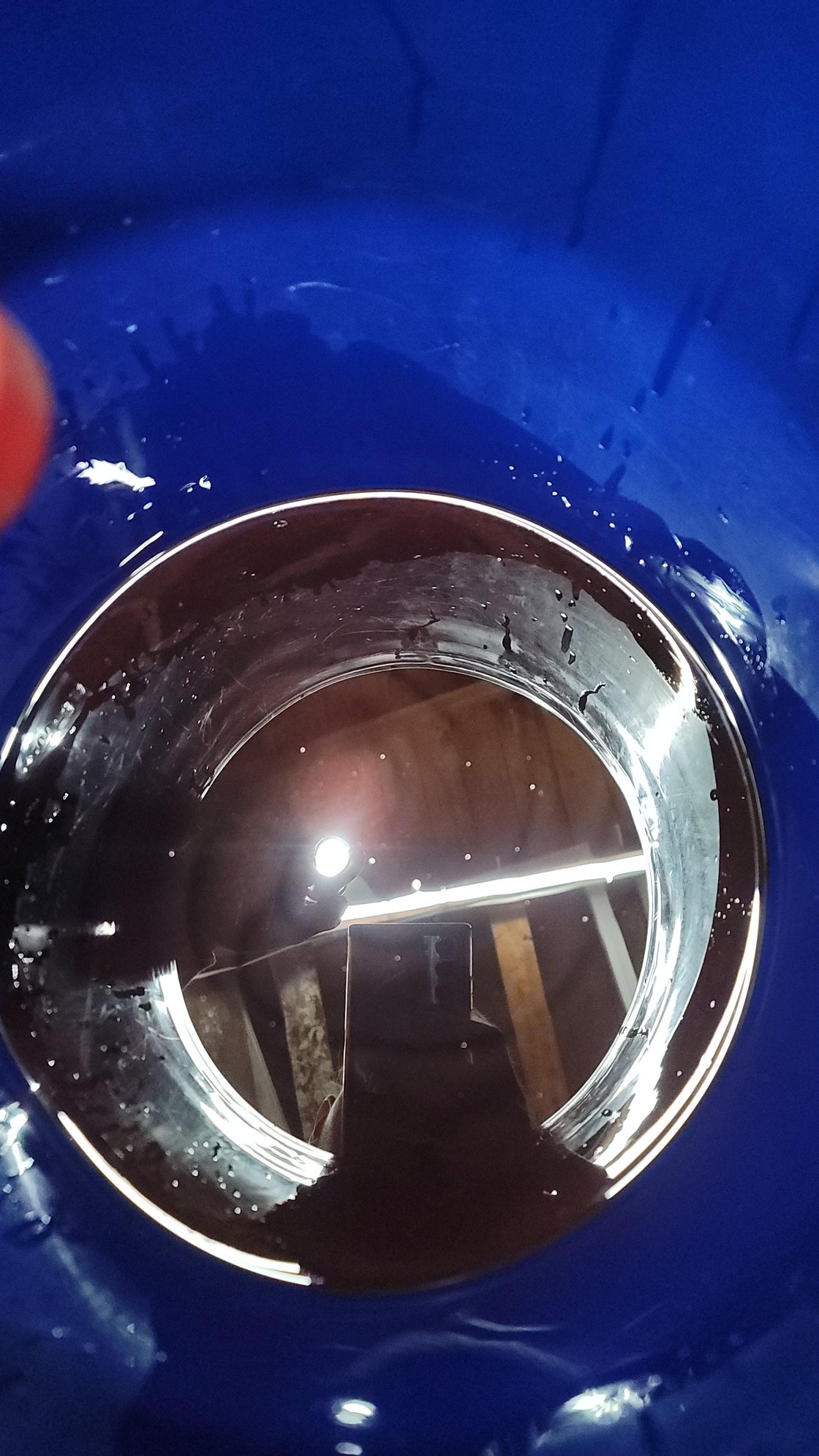

The amount of glitter after maybe 150 miles might tell another story.

Could be air in the system. Not sure what the above pic is of though.

The pic I posted above was the transmission fluid.
