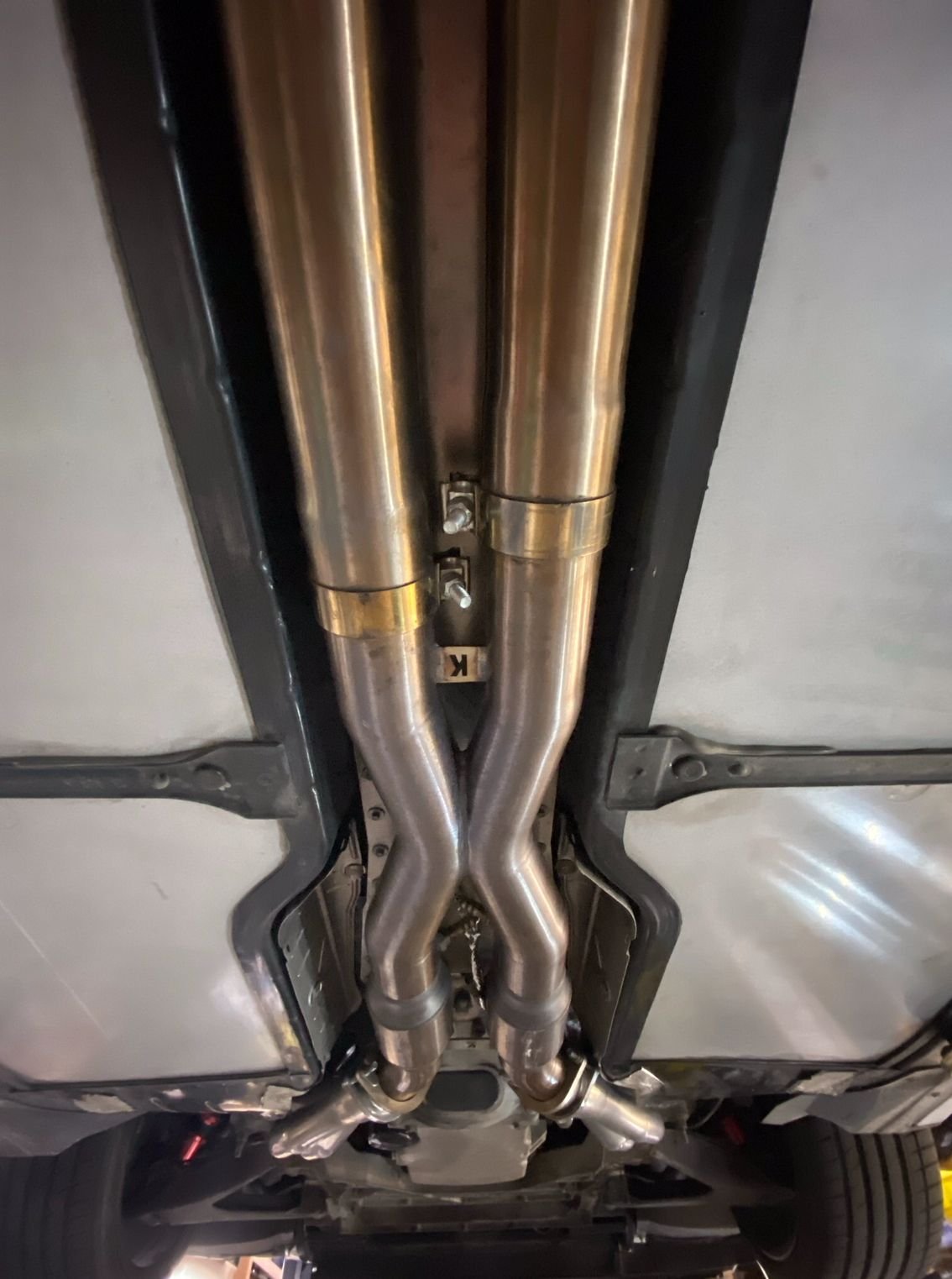

Hi All,
I posted here in the wrong section trying to keep threads consolidated, so I'm reposting hoping to get the experience of the M6 Base crowd.
https://www.corvetteforum.com/forums...-position.html
I'm having an issued installing the clamps from X-pipe to back pipes. I forgot to take a pic, but basically - I am not able to comfortably clock the bolt-side of the clamps up and out of the way. However, if I clock them down, they're sitting as low or lower than the cats - and this section of the underside is really crucial for clearing speed bumps, etc. I trimmed 8 threads from the bolts and can get them not to hit, but man they are close to the tunnel sides and upper stiffener plate. I can trim maybe 2 more threads and still get them to latch, but that's absolutely it.
I've called Kooks and while super friendly and nice, they are not offering another solution. I searched for different, more low profile clamp styles, but to no avail.
Does anyone have some suggestions?

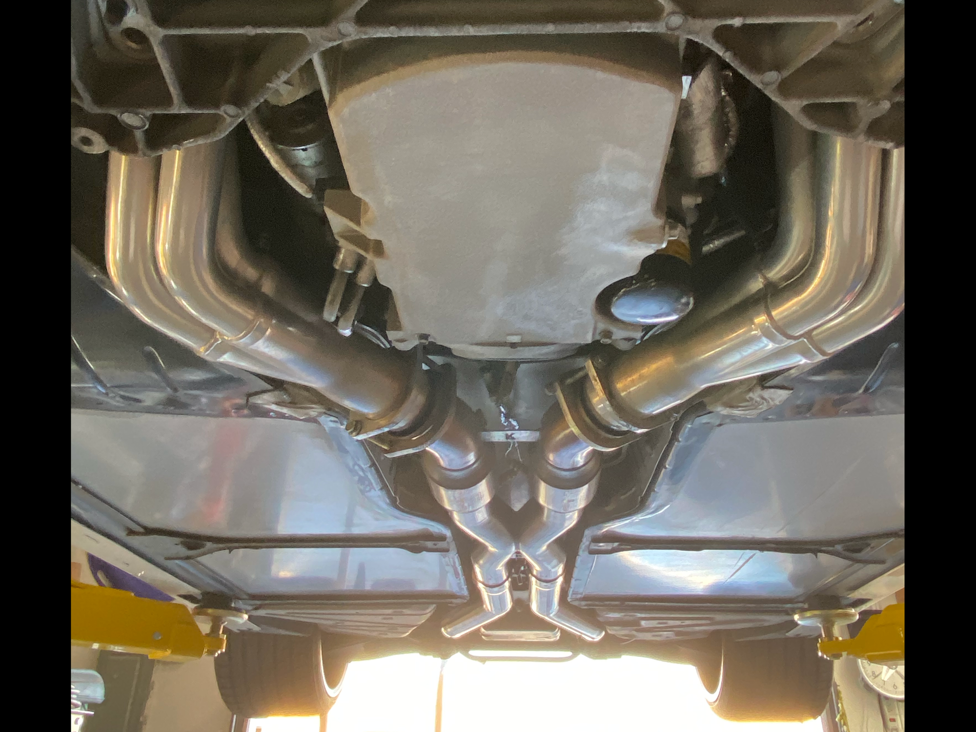

Old May 1, 2023 | 08:05 AM
WhteldyZ's Avatar
WhteldyZ
Joined: Nov 2021
Posts: 165
Likes: 23
For those who may come across this. I have a 2007 M6 base. These mid pipes do not have the clearance to mount the cat to back section clamps up and out of the way. I tried all clocking positions and only this worked. I cut about 12 threads off the bolts and tucked them as tightly as I could in the middle. Also, you definitely want access to the bolts for future adjustment. Even if you can find a way to clock them up in the tunnel, I found I needed to access them for adjustment as I was doing the final steps of install.
I know the pic looks like they would juuuust about clear, but I assure you they do not.
I really like the system, but this should not be an issue with how much these all cost. Hope this helps others.
