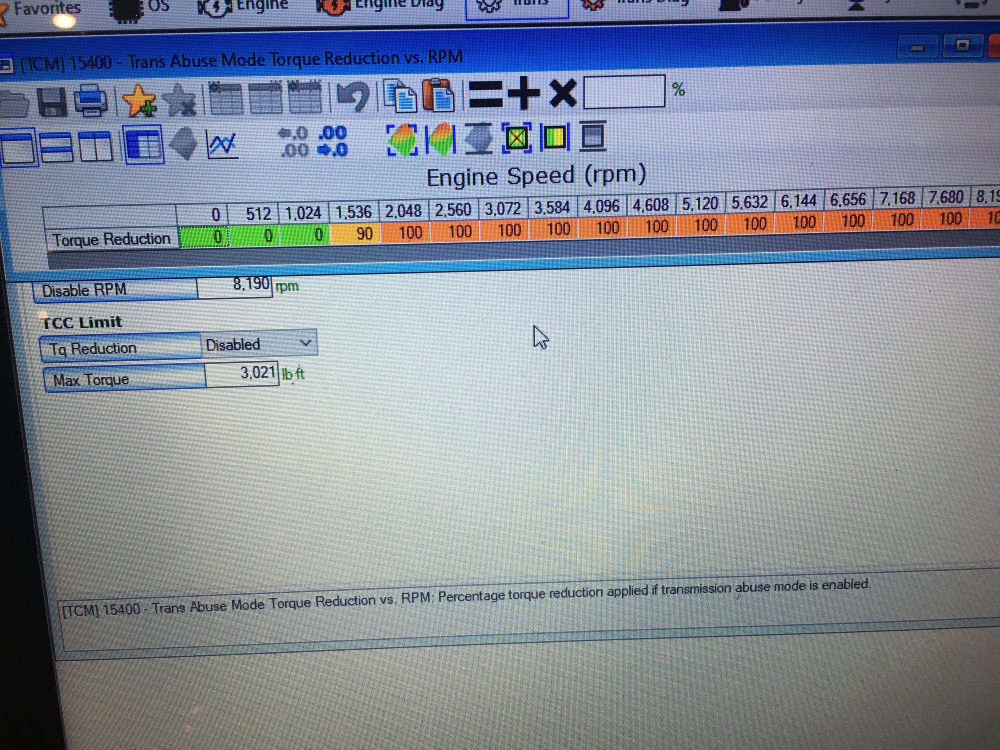

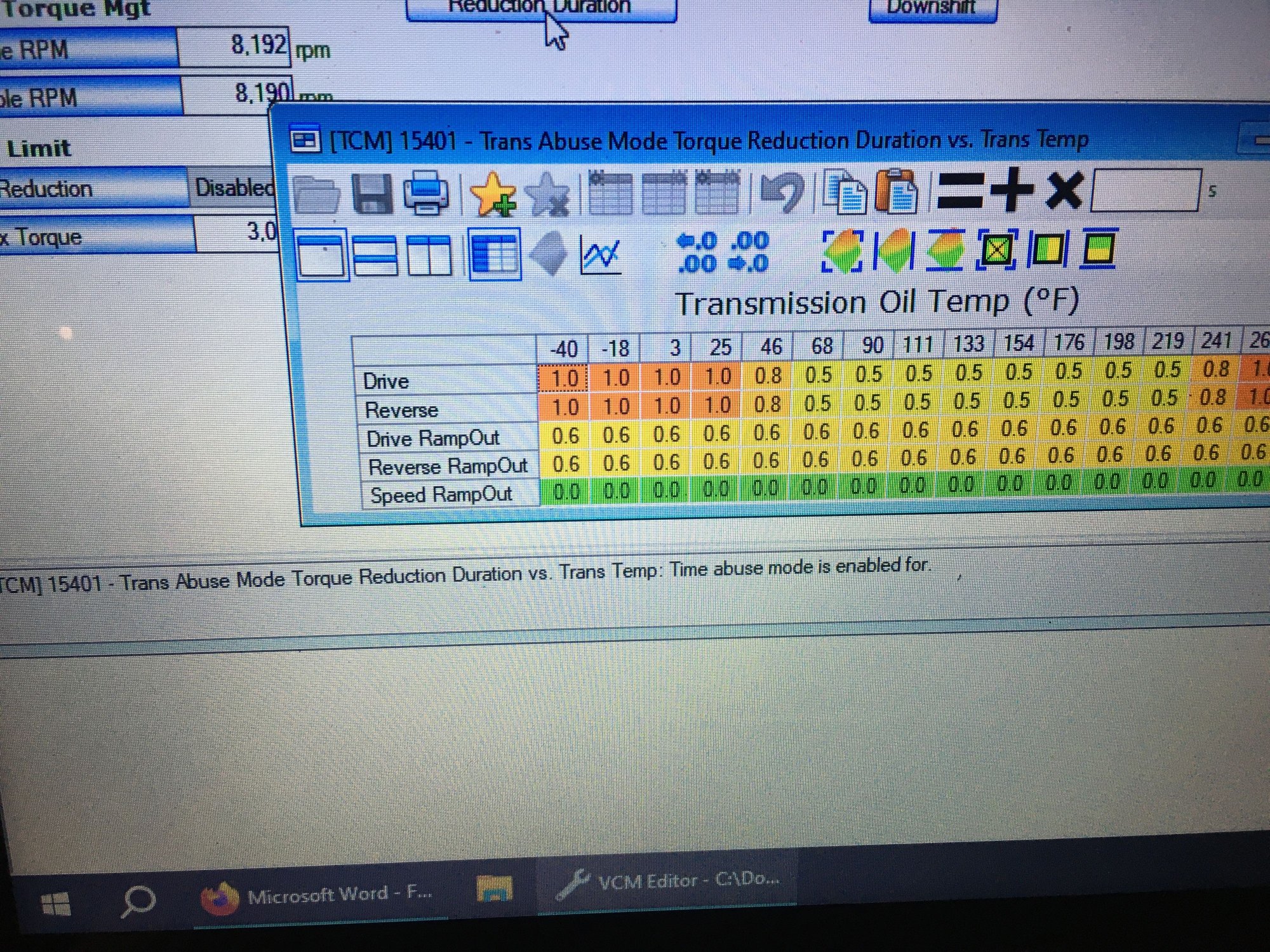

It sounds fine but I wasn't there to really see what happened. I was just looking at the abuse mode setting last night. It's there in the programming for just what you did to prevent damage. I took a picture of the tables.
Dang, I didn’t know any of this! Thank you

The pix are from my '05 and all the later years got a newer computer with more details in the tuning.
Assuming that the OP's profile is correct and he has a 2013, none of these screenshots apply to his car. They do however apply to a 2005.
Could you post the picture of the similar table for 2013?
There isn't one, it's a totally different transmission.

That might be for neutral drops on a 2013. I haven't done tuning on those. I'm sure there is something though don't worry.
