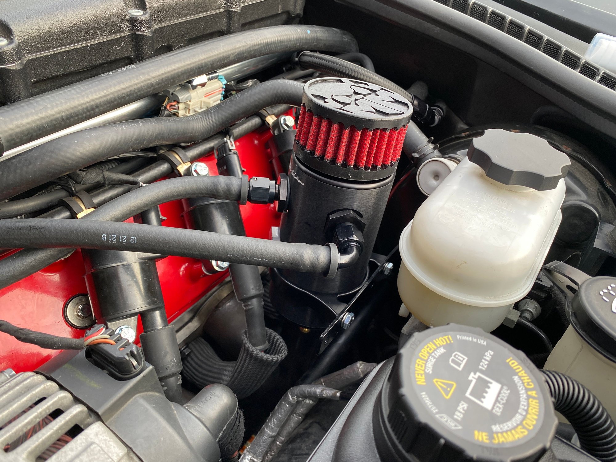

I've always ran mighty mouse and I have to say its a quality product. Not to mention Dave has great customer service and their VA local and American made!

I run the mild on this car but had the wild on my C5, both are really nice setups. I dont think the wild is really necessary unless your boosted though

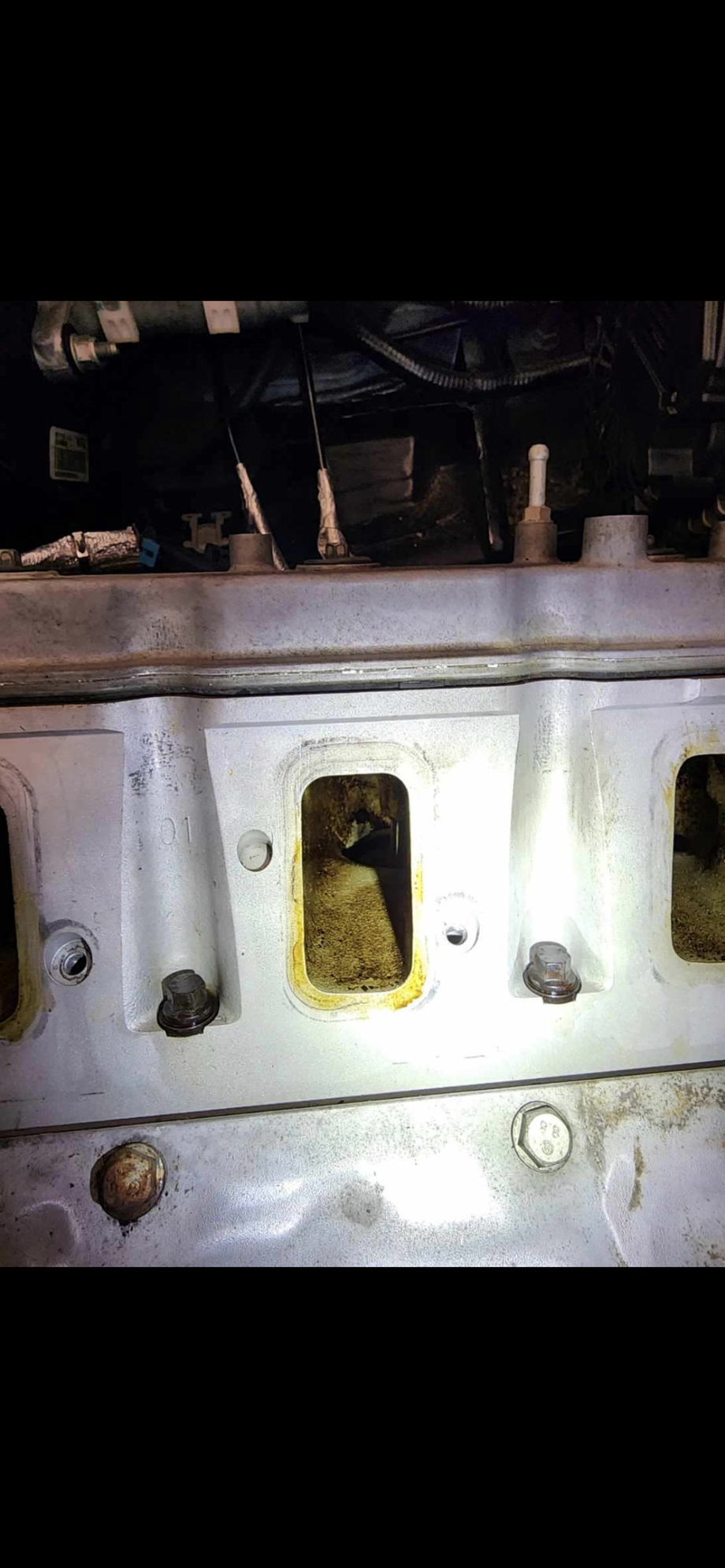

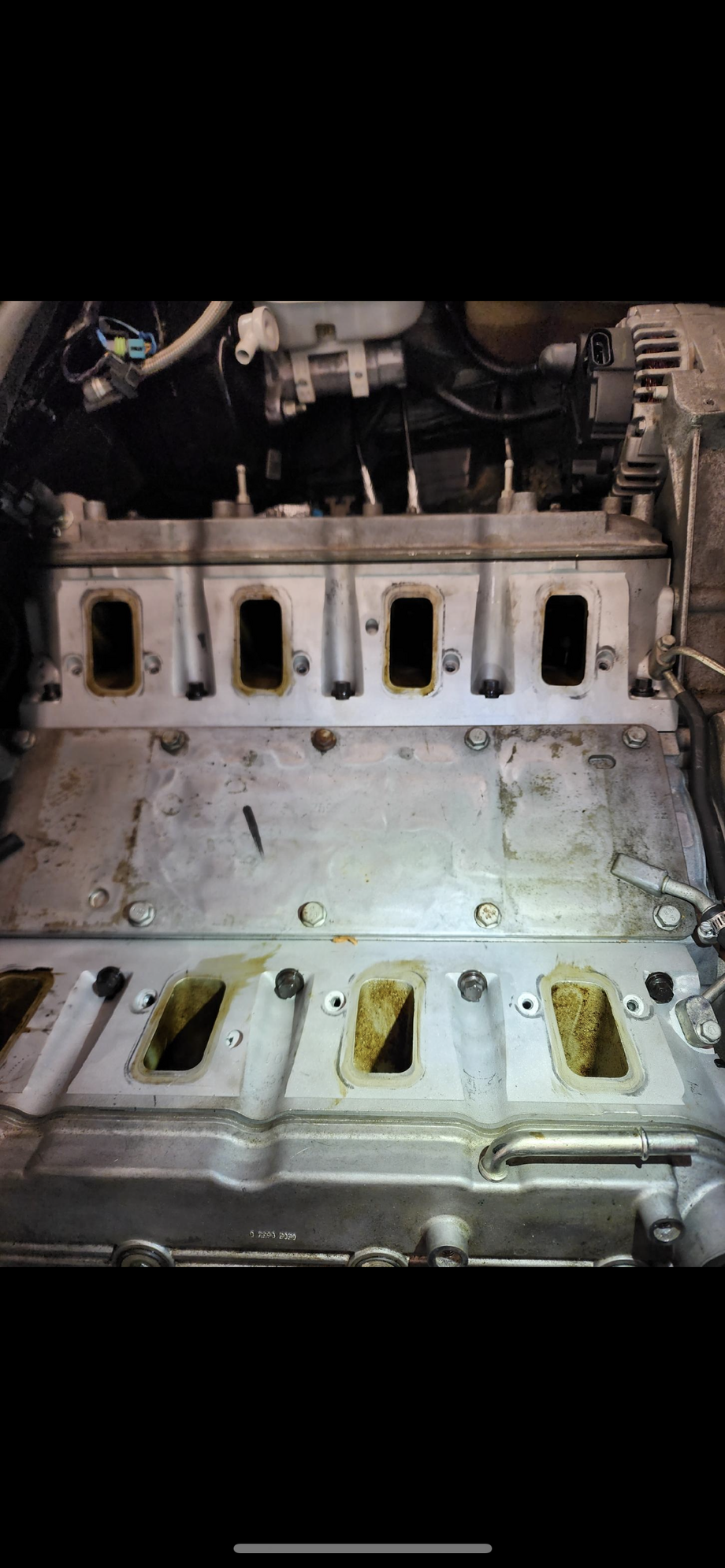

I wonder if it would be worth the money to switch from the elite engineering can I have now to the Mighty Mouse can?! Everyone says the EE can is good but mine is the basic one. It catches some oil but judging by the pics it’s still letting plenty in.

Mine seems to do its job, I did it after I did headers initially to cut down on the oil burn smell I was getting, Def took care of that. I usually dump it out every oil change and have a decent amount of oil in it. The nice thing is you dont have to take it out of the car to drain it, It has a petcock on the bottom. I made a little catch for it to make draining a bit easier and less messy. One thing I like its it has a sight window in it so you know the fill level. He also puts some sort of metal webbing in there which i assume helps separate it further.

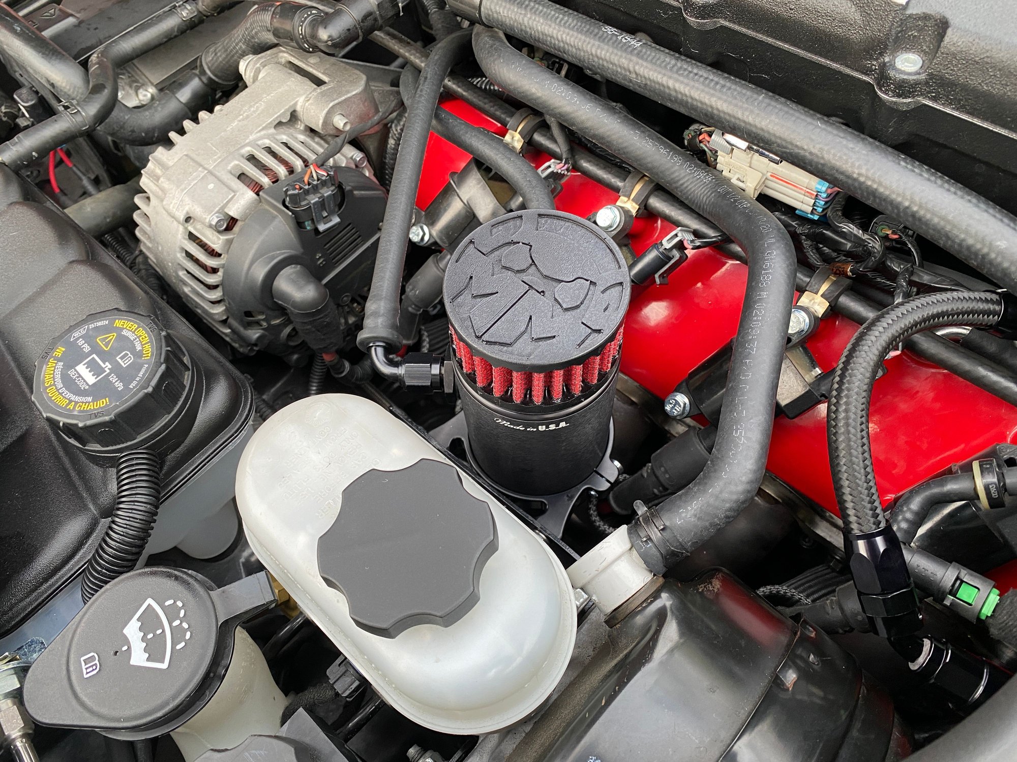

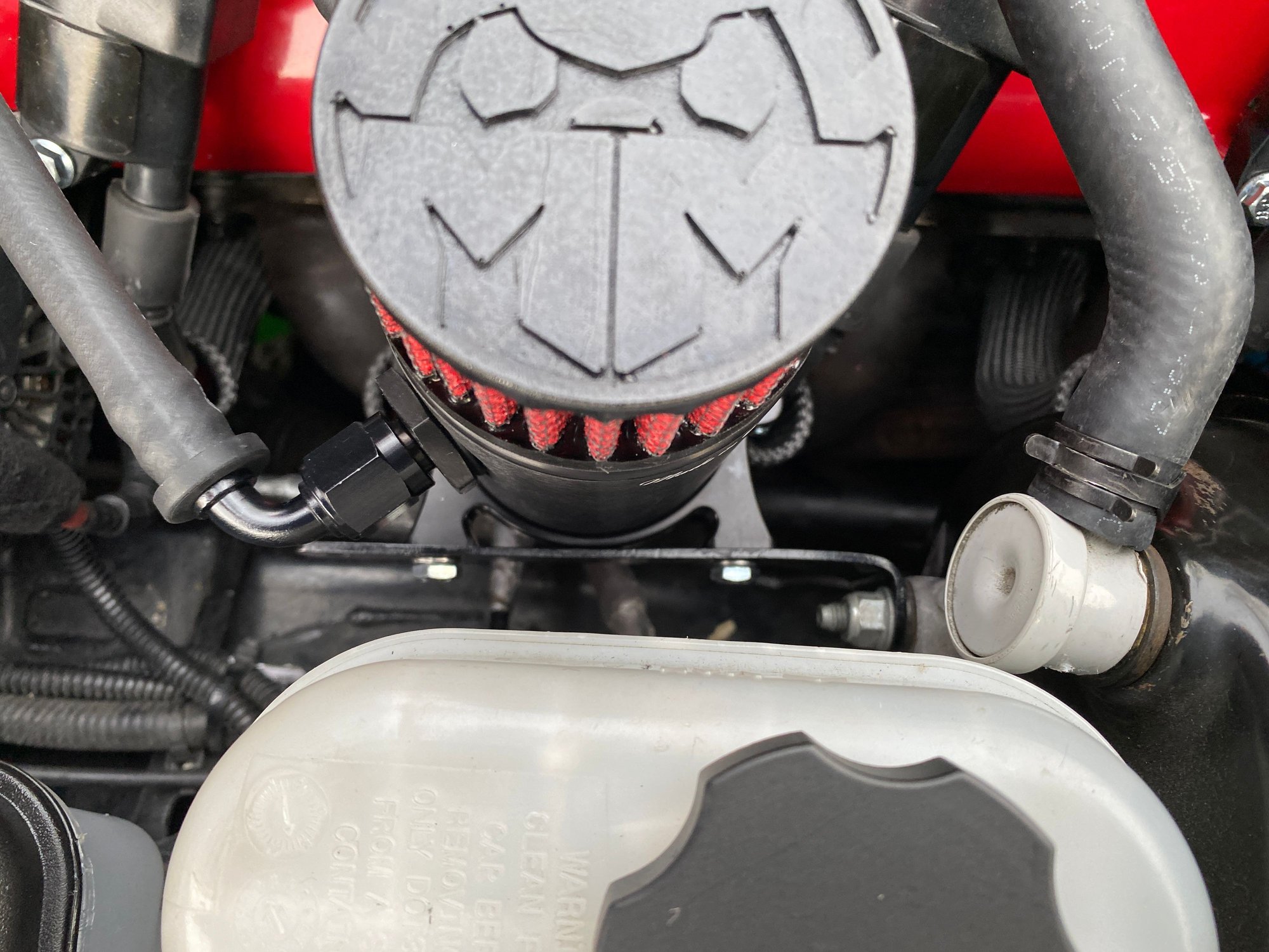

I also recommend a MM catch can. I have owned an EE can in the past and they are nice. But the MM is pretty much the best and there are so many options for configuring it and for mounting it.
Something that I also really like about the MM can is that it can replace your PCV valve completely.
I am running an E-force on my car and I went with the Mild option. I mounted it using the GM truck brake booster bracket. I had to drill new holes about 1-inch from the stock holes in the bracket so that it would have clearance from everything.
