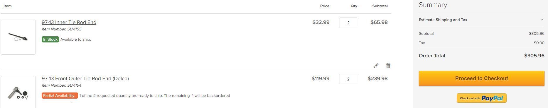

Last - any input on what I should replace them all with? I'm inclined to go with my RockAuto selection below based on price and availability:
All GM Genuine tie rod ends from GM Parts Giant. Ignore those nuts in the order, forgot to clear my cart first and just let it ride.
AC Delco Outer and unknown brand inner tie rod ends from Zip Corvette
GM Genuine inner and AC Delco outer from RockAuto

Went ahead and ordered the inner and outer tie rod ends from Rock Auto. I called the shop this morning and they said they will install customer supplied parts. Quote for installation wasn't bad at all and I'd rather not mess with the inners or risk throwing something off that would make it unsafe to drive to the shop for an alignment when it's all done.
Thanks for the input guys. Looking forward to having a tighter front end again.
