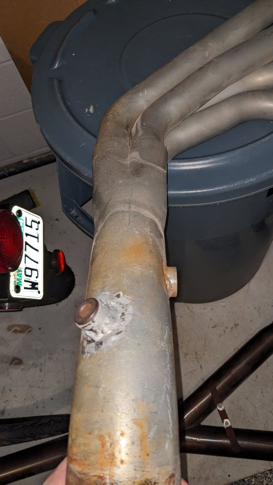

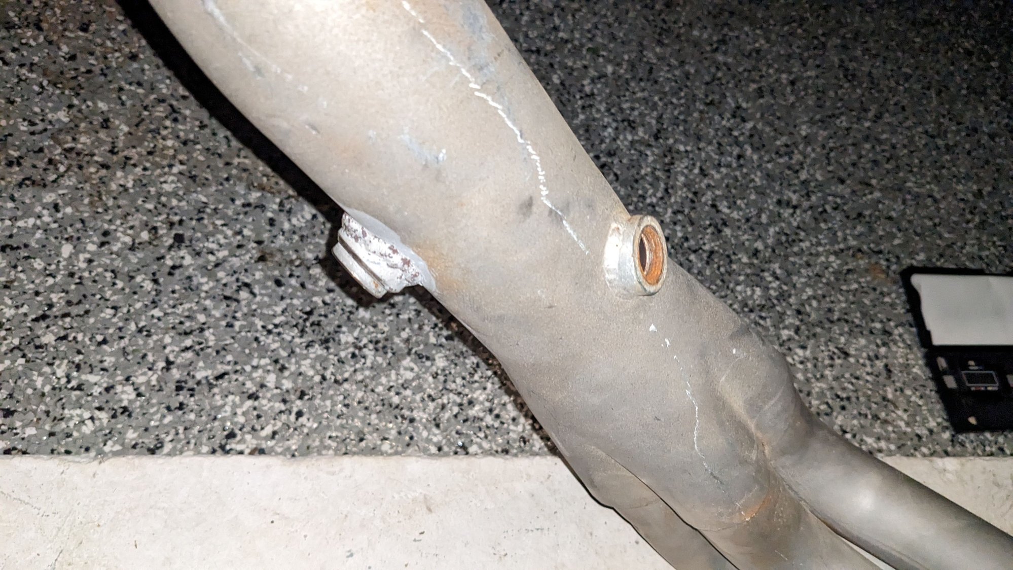

Well, I bought them. Really nice older gentlemen who said he knew Ranger... As in Ranger method Ranger.
What are these extra holes welded in near the front O2 sensors?
Also, I was expecting D shaped ports but they are circles, so what gasket do I need to buy?
The cats look to be in good shape.
Headers appear to be 1 7/8 with a 3" x-pipe so it's what I was looking for.

Standard GM exhaust gaskets will be fine.The extra ports were put in so they could install a wideband 02 sensor.

Extra bunges added for wide band O2 sensors.
If you want to shoot them with anther coat, then actone tone and steel wool, will prep them for a coat of air dry Cerakote.

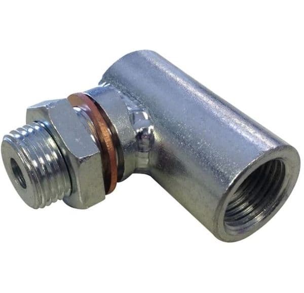

Rear O2 bunges are already capped, but if you need to put the rear O2 sensors back in play for visual inspection and working, then adaptors to pull them out of the steam so they read lower to not throw codes (or just install them like normal, and still turn them off in the tune.
Hence only pre-O2 sensor work with the tune, and the post O2 sensors just monitor the cats to make sure the are still working effectively or not.

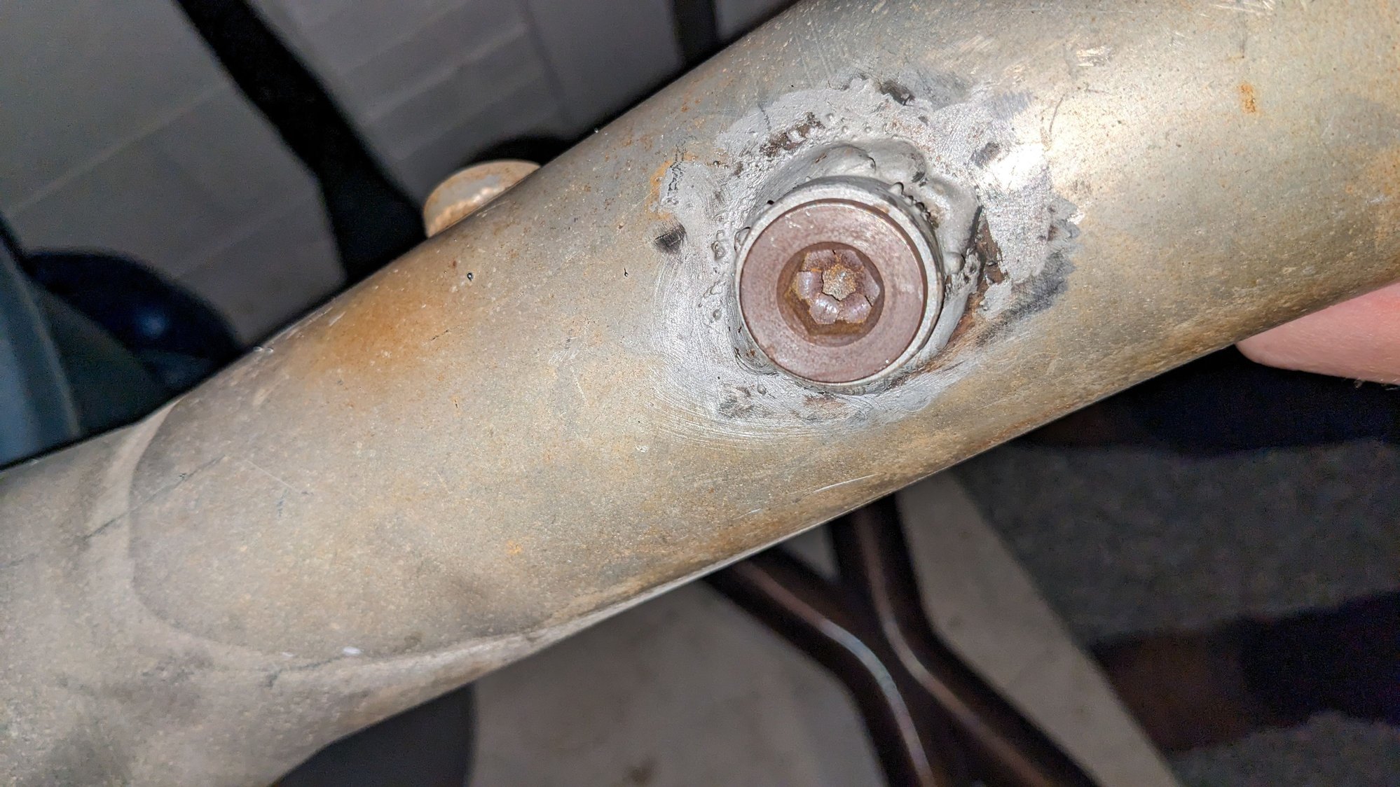

Thanks guys. I assume I'm looking at a plug in the wideband ports too? Doesn't look like the same plug as the rear O2 ports have but it's definitely not open soooo
Buddy of mine said his neighbor could re-do the welds on the wideband ports. What say you? They are clearly terrible looking welds but I know enough to know even a bad looking weld can still serve the intended purpose.
