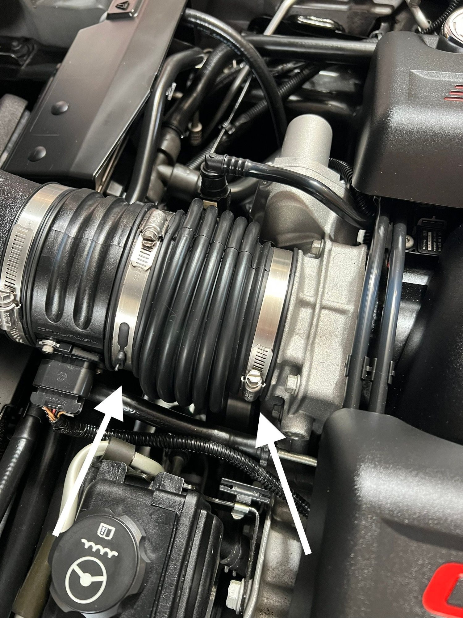

Why was the MAF sensor replaced ??…if both lean codes popped up after replacing your MAF sensor the first place I’d look are the 2 areas in the picture below and your PCV hose connection.…the rubber bellows is either torn or installed incorrectly when you reinstalled it…anything AFTER the MAF will cause the DTC to set…why go to a dealer ??…any shop that has a smoke machine can find it if you can’t…you can spray Brake Kleen in that area (I prefer propane)and see if you notice a change in RPM…you can even spray some water and see and hear if the water is getting sucked in…having a scan tool will help to rule out a MAF issue or fuel pump but doubtful if the car runs better under load when manifold vacuum is at its lowest and a vacuum leak has less of an effect then…was the new MAF sensor OEM or aftermarket ??…STAY away from any aftermarket parts on anything you change on the car that has “sensor” in its name…always OEM !!

Thanks for the quick response. MAF sensor was replaced after the codes started appearing. I initially cleaned the original MAF sensor when the codes first appeared with MAF cleaner but the codes reappeared after a couple of drives so I opted to replace the MAF sensor instead. I bought the sensor at Autozone but picked the one listed as OEM. I think it is AC Delco. I did remove the air filter and snorkle to check for tightness of the worm screws. I also recently removed the "PCV" hose and checked (no tears) and reinstalled. I wanted to swap out the PCV valve but found out that our cars do not actually have PCV valves. If you know otherwise, please advise. They do not carry at Advanced Auto or NAPA. TBH, I checked that hose just the other day and have not yet taken the car for a spin since I did not see any noticeable issues upon inspection. I will take it out this weekend.

With a faulty MAF you would normally see a P0101 or 0102..you don’t have a PCV “valve” as on other LS engines…if your code reader can look at fuel trims run the engine at 3000 RPM…if short term go negative and long terms gradually decrease you do have a vacuum leak…I would redo everything you did as far as the connections and see what happens…where are you located ??…I may know of some good diagnostic shops in your area…was any maintenance done prior to initially getting those 2 DTC’s and replacing the MAF sensor ??
