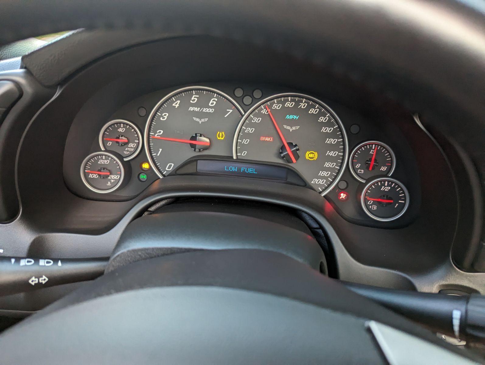

After roughly 5 minutes, it suddenly began behaving somewhat normally. The fob was able to unlock the doors, and the car started normally. However, there were lots of warning lights illuminated on the dash (see picture below): tire pressure warning, ABS, brake, security, airbag. Also, the oil pressure, fuel level, and coolant temperature gauges were reading 0. The speedometer, tachometer, and battery voltage gauges were reading normally. There were some warning messages appearing on the dash such as "Low Fuel Level," "Service ABS System," etc.

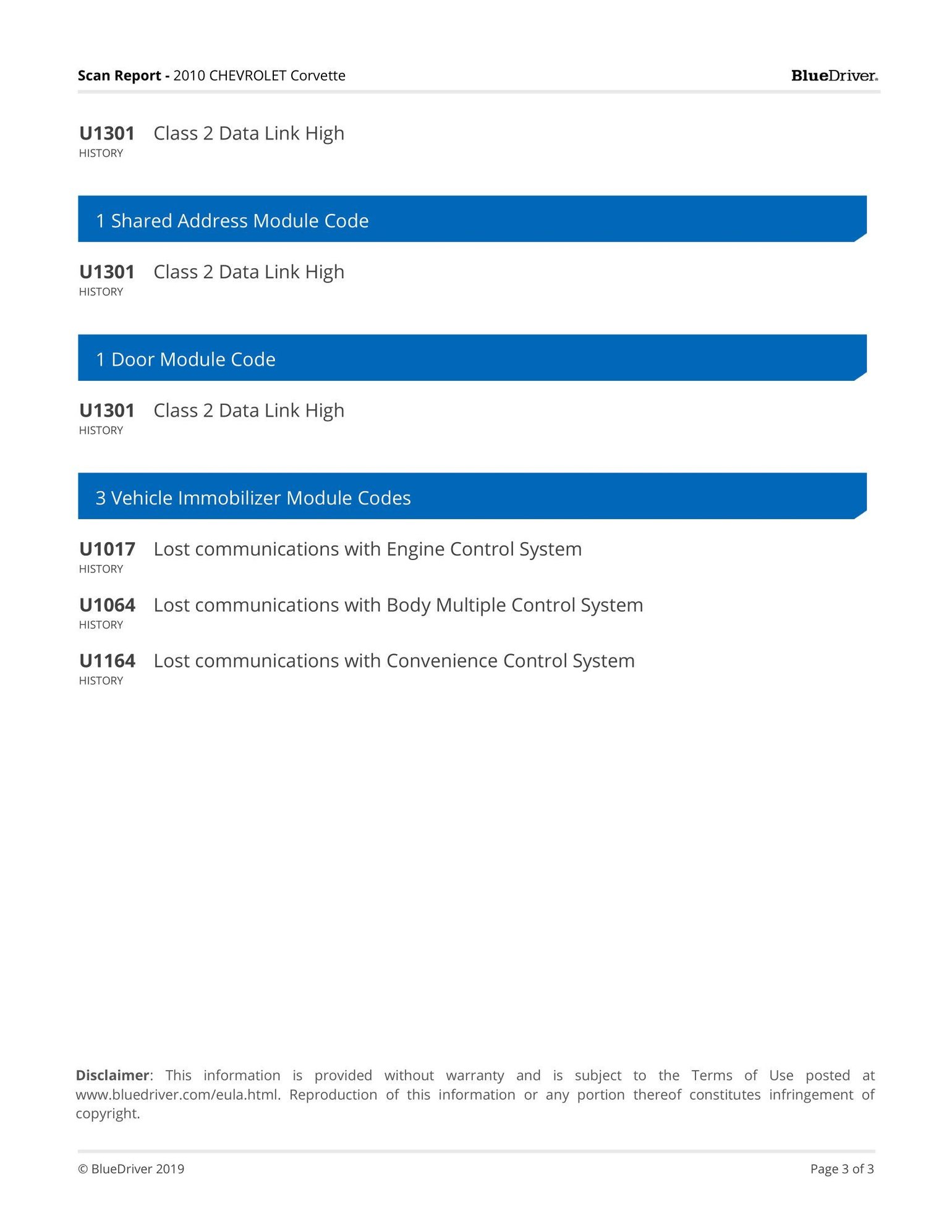

The car ran and drove perfectly normal the entire way home with no hiccups. At some point during the drive, the gauges returned to their normal operational state and some of the warning lights disappeared. I restarted the car when home, and it behaved perfectly normally. No warning lights on the dash, no service messages, no trouble starting. I was able to pull some DTCs during this time (see screenshots).
Any information would be most helpful as I'm scratching my head trying to comprehend why this may be occurring. It seems like all of problematic systems are controlled by the body control module (BCM). Thanks in advance!

Multiple CELs are indicative of a falling battery.
Have battery load tested.
