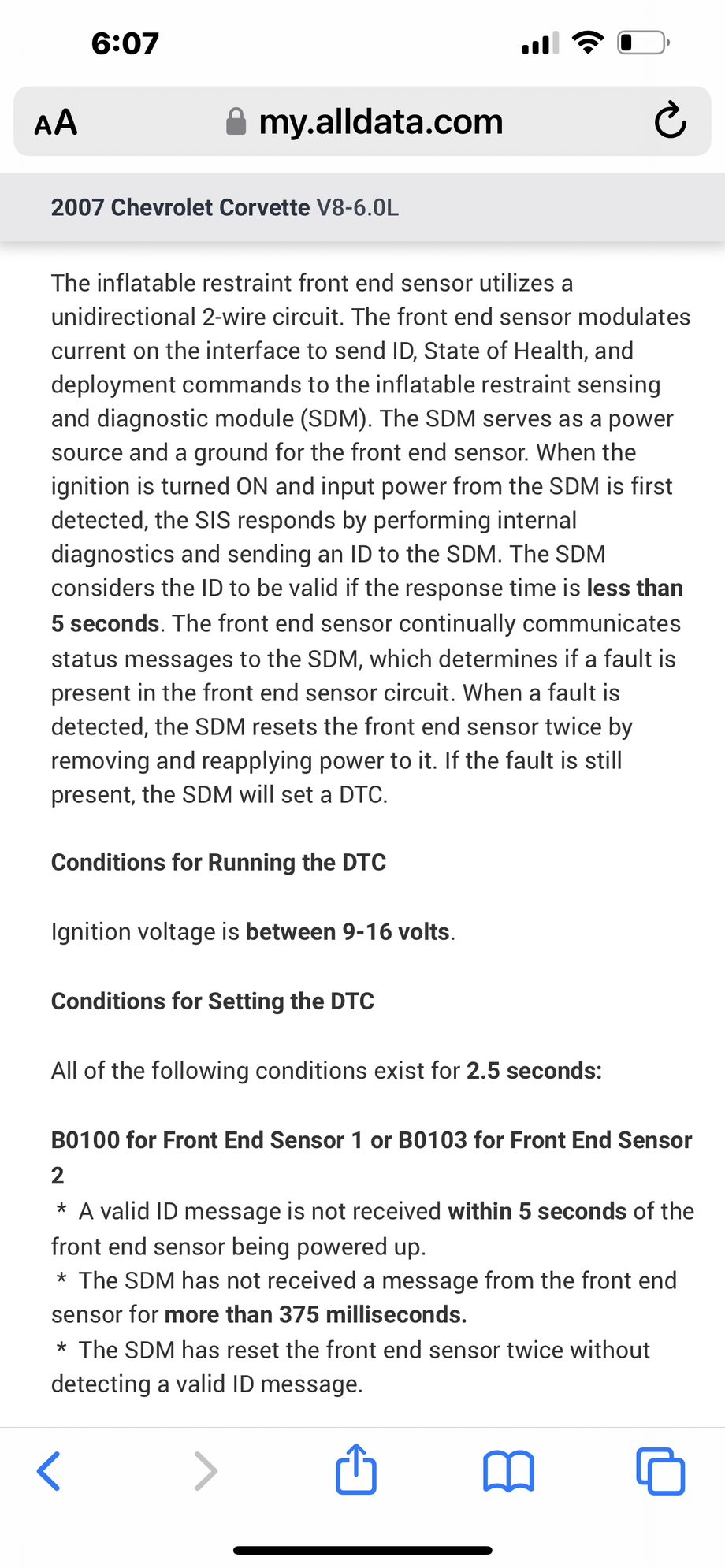

My airbag light is on, I got it scanned and gave code B0100 which is front driver side impact sensor..
I changed the sensor and upon start up airbag light flashed a couple times turned off then came back on after a few seconds..
I got it scanned again and same code came up again even with new sensor.. any idea what the issue could be or how to fix?

I’d try looking at the wiring…always helps to know what year car you have but this is the troubleshooting tree and wiring and this is for a 2008.

It’s a 2007 Z06, if it was the wiring would it still recognize the changed sensor? Because it turned off then turned back on..

If the airbag light went off and back on it’s telling you something other than impact sensor.
