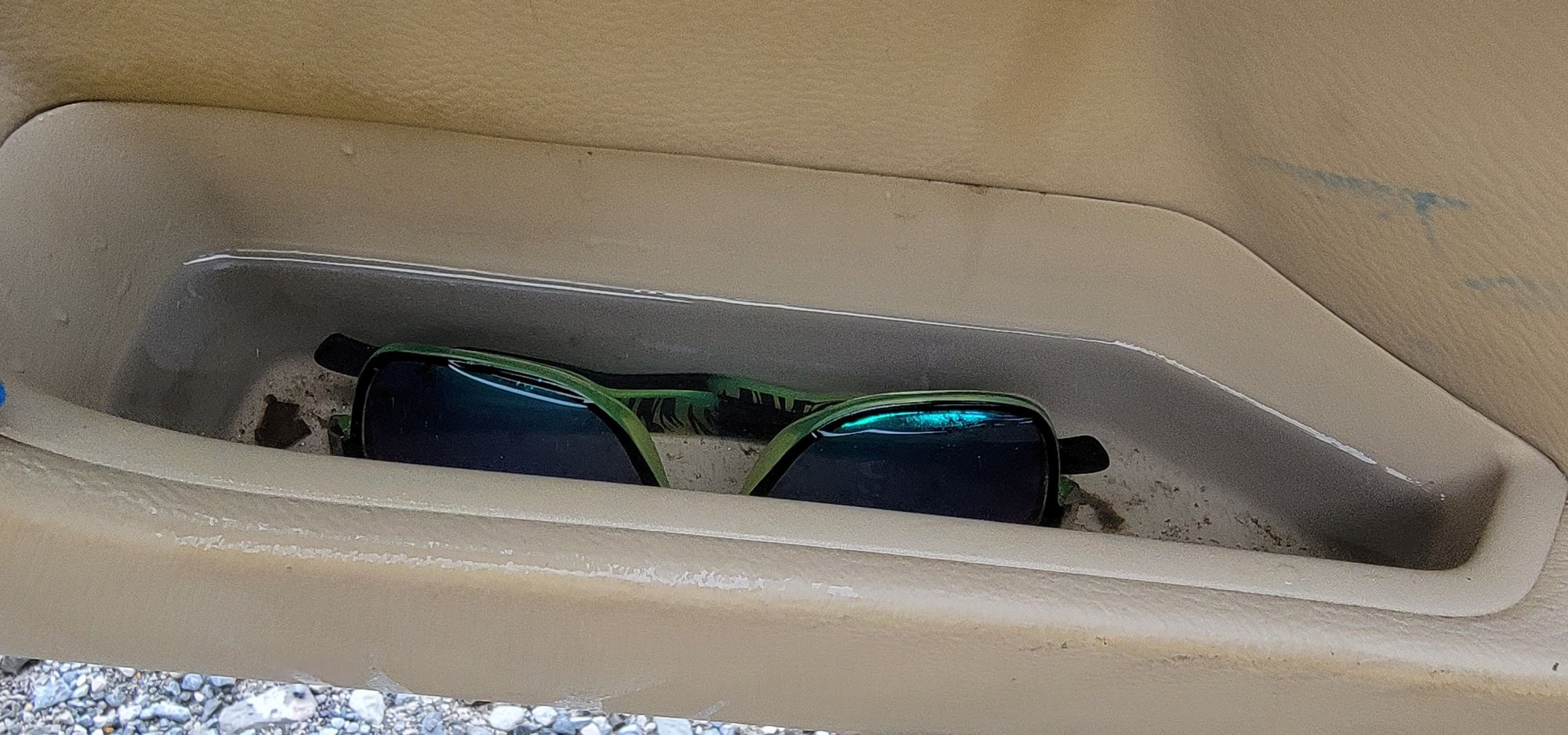

UPDATE = I friend of mine called "a guy" who happens to have spent his career working on the C6. He has the computers, programs etc. to get her back on the road. (BTW He echoed what everyone here has mentioned) I can't express how much all of your help is appreciated!!
You can see the ECM sitting in the passenger seat.
Something white hit the bumper.
That is the amount of water that entered the car.

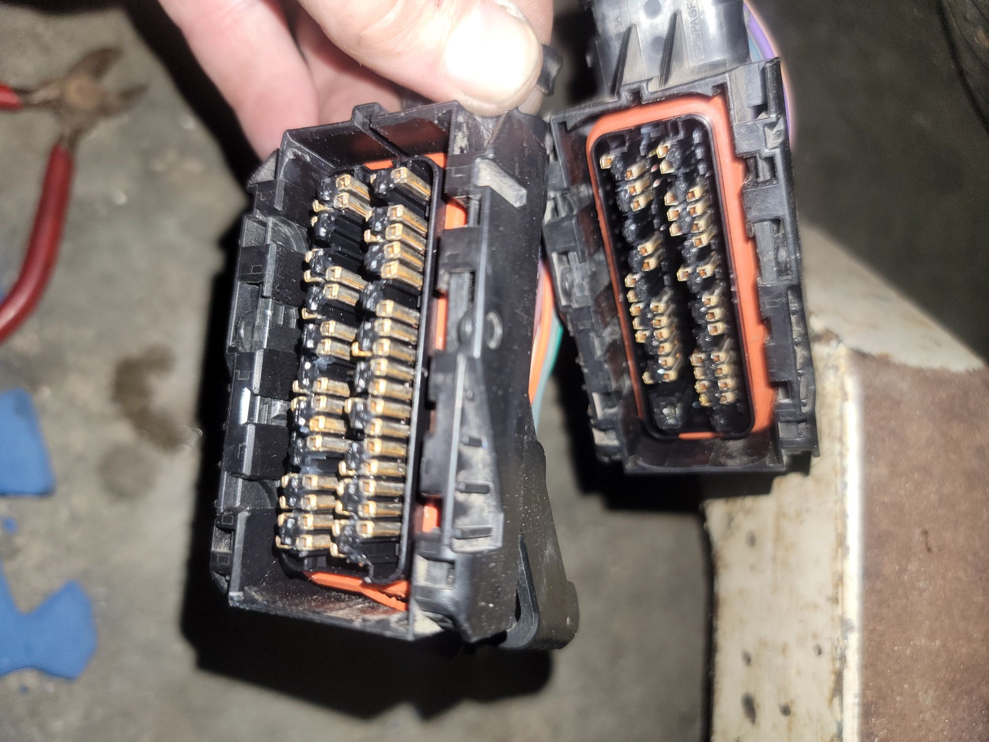

Well, the guy came over and I think he figured out what is wrong with it and offered to trade me his running car for the vette and I declined, He has gone into the wind.... The ECM fuse(15a) was blown, put in another one and it immediately blew. I unplugged the ECM put in another fuse and it stayed good. I checked out the ECM connector wires and they all look good. Took the plastic covers off of the ECM connecter wire contacts and they all look good as well none of them are touching each other to short out (
See photo). Am I at the point of a new ECM, take apart the ECM to check for internal damage or is it a still a wire issue that I have to run down?

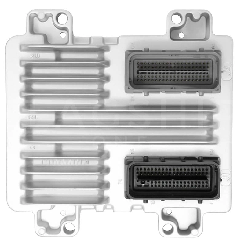

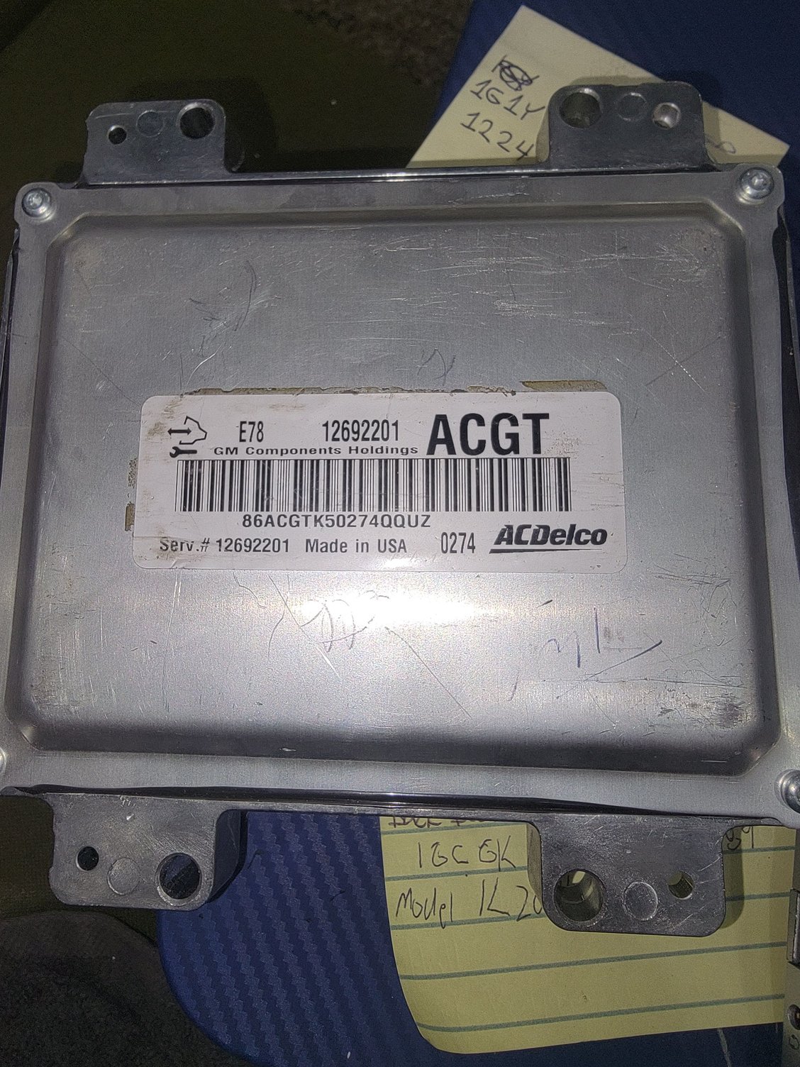

Doing some more research I think I found the issue. According to GM Parts Direct & Flagship One and various others the ECM is NOT for my corvette it is a E78 GM (12692201) and I need a E38 GM (12597121). Heading to the dealership later today......
E78
E78
E38
E78
E78
E38
So the Dealership installed the wrong ECM ??

Yes, wrong ecm, and its different pin wiring is the problem.

They took mine and put that one on the seat and deny it. I bought another one.

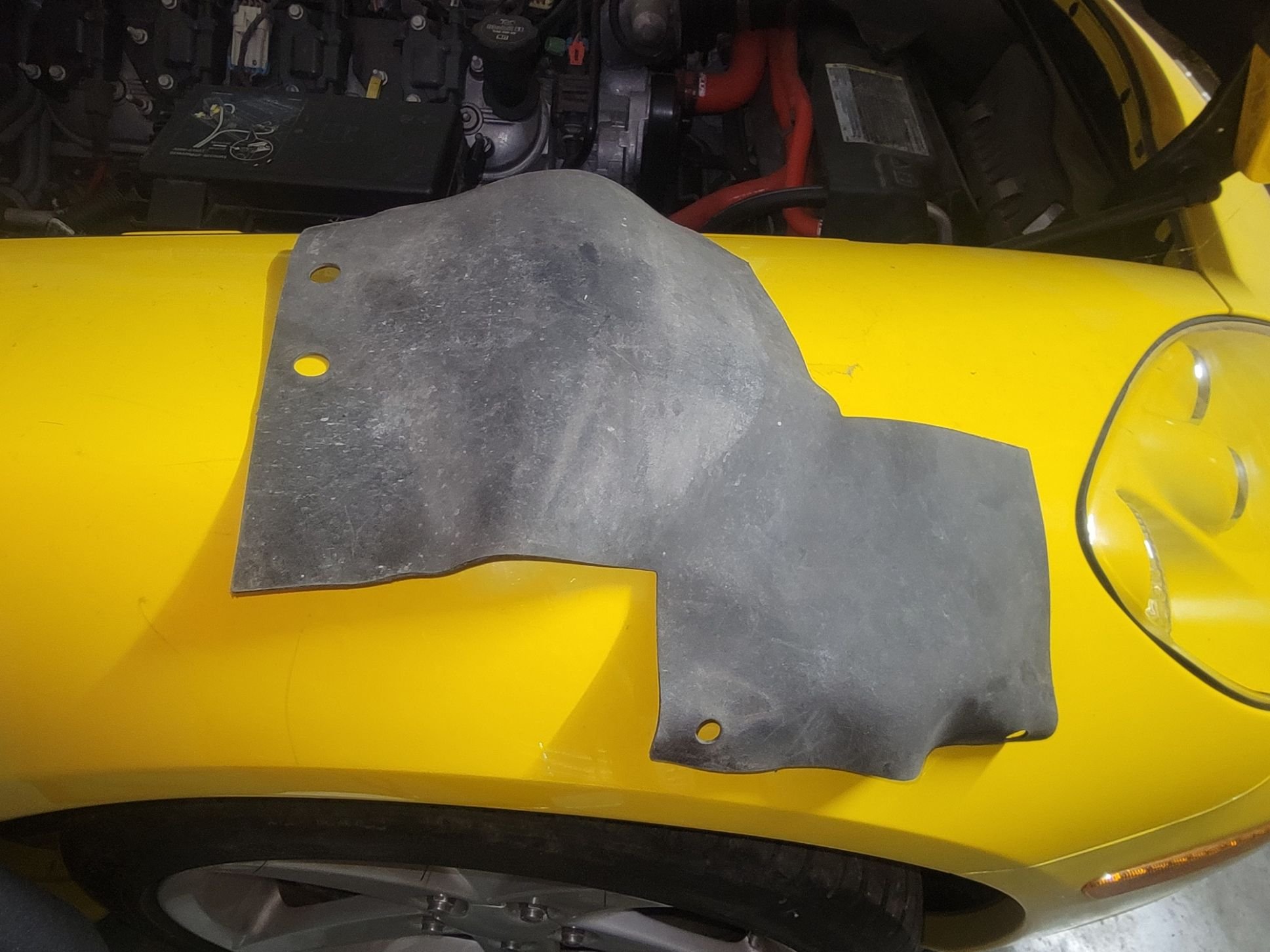

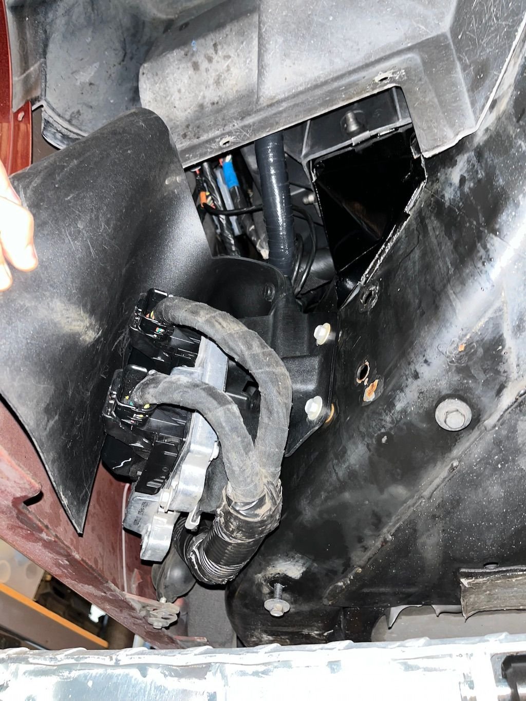

New ECM installed and she is up and running, rough, but running. The fan won't come on, but I am reading about that. Here is the mystery I have is figuring out where this rubber flap goes. It has been so long apart I do not remember where or how it goes in the battery area.
It wraps around the ECM:
