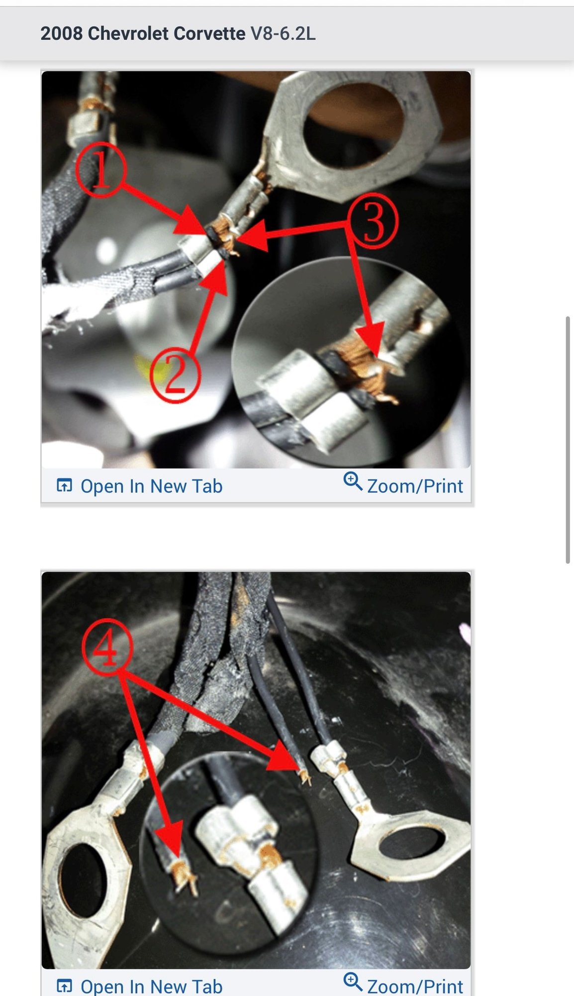

My first question is WHY did you take the car to a dealership for a diagnosis ??…that is the LAST place to take it !!…dealerships are pretty much clueless when it comes to diagnosing…they just replace parts until they hopefully fix it and you wind up with a big bill…there are Techs that just diagnose cars if you didn’t know that…they can diagnose a Honda or your Corvette…they just have a specific set of skills that other techs don’t have which are their specialized equipment and knowledge…now do you know there is a recall (specific 08's and 09's) on your cats (below that was declined by the PO of my 08) so I hope you didn’t have to pay for them if yours was one of them…they are also supposed to reprogram the ECM…was that done ??? …P0420/0430 is an “effect” and not a cause…the dealership should have done an “oxygen storage test” before replacing the bank 1 cat but I’m certain they never even heard of that test…cats usually just don’t go bad…misfires, damage by coolant or blowby gases can nuke them...also an exhaust leak between the upstream and downstream O2 sensors can cause this DTC to set…and don’t disconnect the battery because that IM Monitor will not set…the dealer should NOT have given you the car back until that Monitor was set…according to Service Info (below) it’s says it MAY take up to 100 miles for that DTC to clear…that TSB probably doesn’t refer to your situation now but I’m assuming the ground for the coil packs (G107) is causing misfires but if your car had been running OK when this first occurred you may want to have the car properly diagnosed again so this cat doesn’t become defective…take the car back and let them fix it right if the ECM was not reprogrammed.

I know I need to set up another appt. and tell them what you mentioned about reprogramming the ECM.
And no, I won't be disconnecting the battery in the meantime .
Who diagnosed it initially ???…if it was the emissions testing facility did they just read the code and say…”you have a bad cat” ??…did they do any type of diagnostics ??..and tell the dealership to read their Service Info for once !!

When I first failed the emissions test , I did research on here and read that some guys had codes pop up w/ the MIL on, was diagnosed by shops and told they needed to replace their cat(s) . Got it done & still had MIL on.
I'm basically in the same boat as them.
So when I first went to dealer last month, I told them what's up & made suggestions that the easiest (and cheapest) thing would be to check the O2 sensors first and replace if necessary. When they said the cat was bad and they recommended replacing it, I asked if they would replace O2 sensors w/ new ones if replacing the cat & they said no.
C5 Diag, thanks for shedding some light on this and for suggesting the dealer reprogramming the ECM, because I believe that should be the key to "fixing" this.
No problem !!…I’ll post a few videos below for you !!
