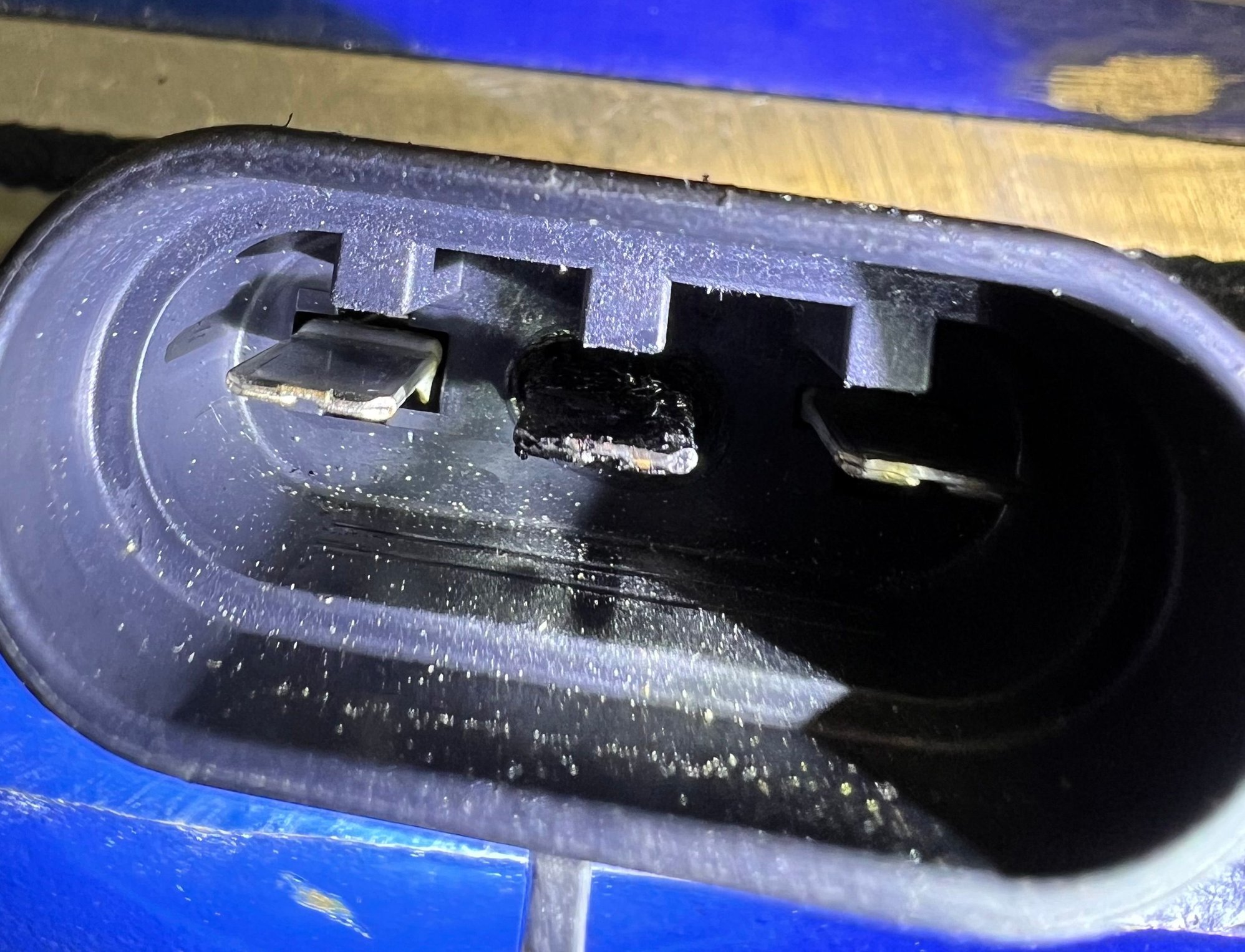

well guys i was driving to the gym and noticed my car temp got extremely hot so of course i checked coolant level all was well then as i got home i noticed i the fans didnt come on so i checked the fuse panel and found this.....

Check your plug on the rad to see if it's melted

You will likely see this or worse !!

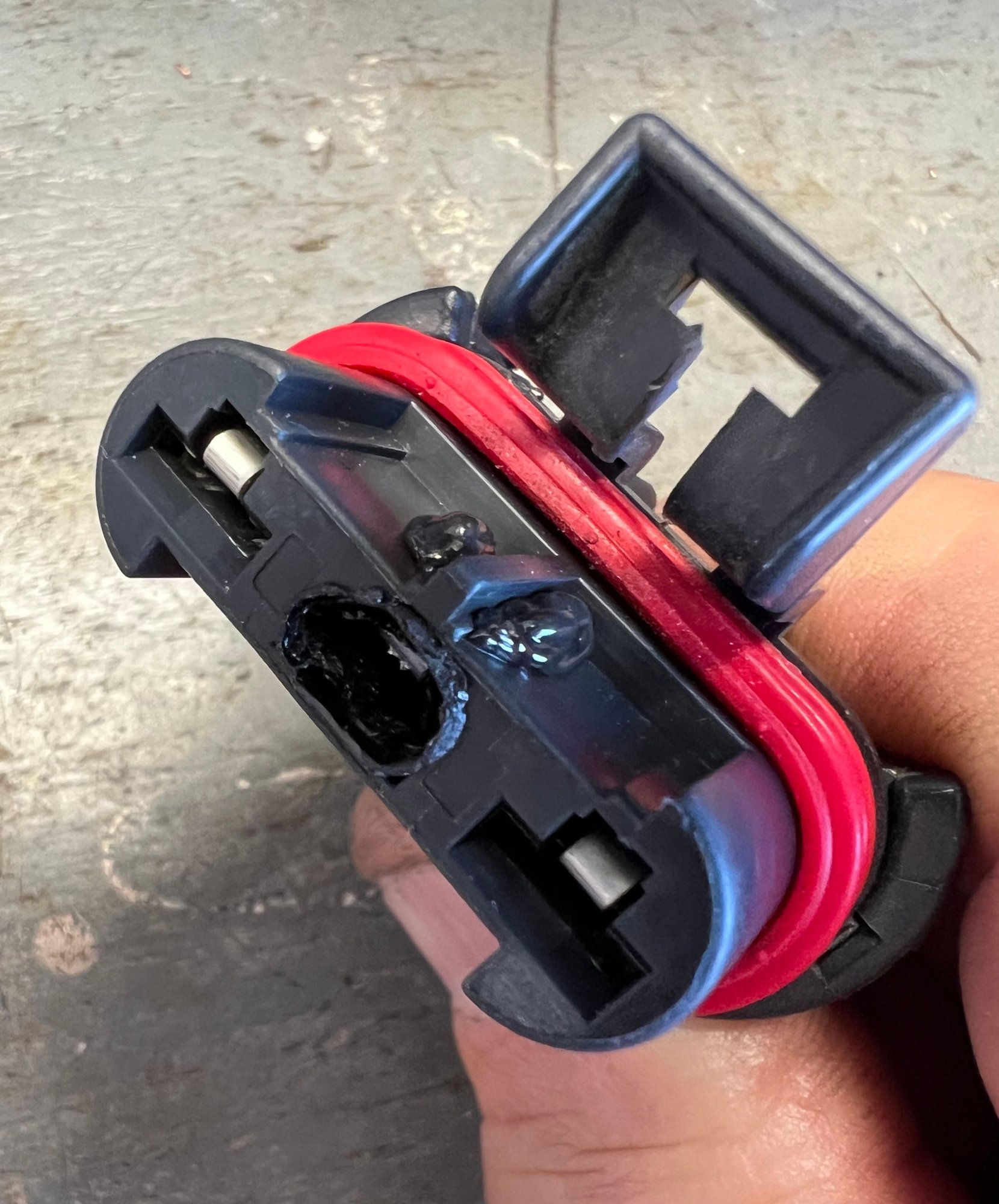

Plenty of "radiator fan plug melted" threads on here. When it's hot and the fan is on max, it draws a butt-load of amps and can eventually overload the circuit.
Not fun to get the problem on a ferry in south Texas in the dead of summer. The plug has 3 wires.....I spliced a length of 10 ga wire on each side of the connector, bypassing the fat power wire through the plug.

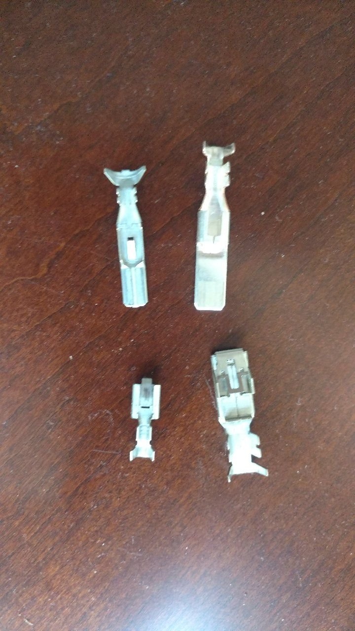

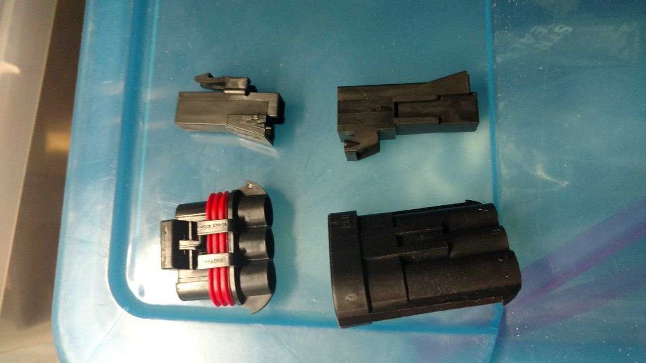

I went to a heavy connection the Metripak 800 ( the OEM is a Metripak 600). It can take a lot more current the blade are the size of a house plug.
