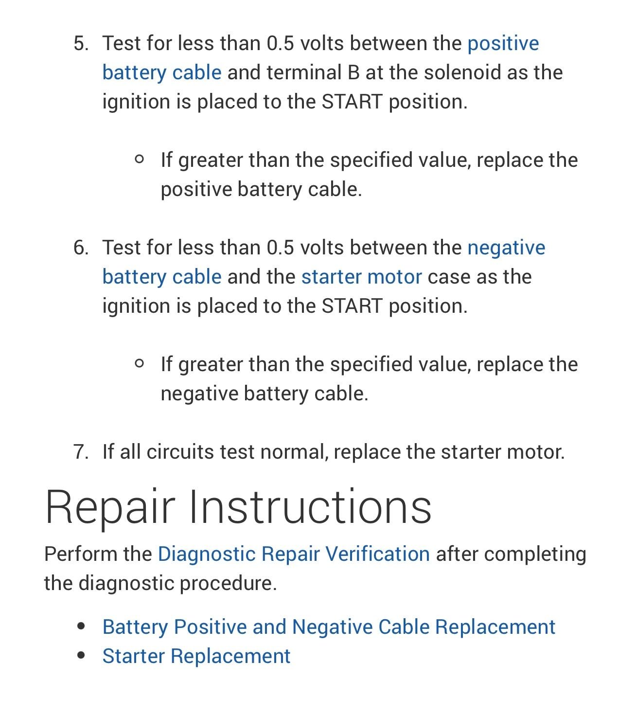

Best to have the battery load tested…just because it’s been on a tender doesn’t mean it good and even if it’s fully charged and at 12.66 volts…how old is the battery ??…a quick way to check for a bad battery ground is connect a 12 volt incandescent test light to battery negative…touch the tip of the light to the engine block while starting the car…if the light illuminates when attempting to start the car the battery ground connection needs cleaning…if you hear the solenoid clicking you may have a bad starter…if you can make a jumper wire as pictured below you can jump pins 87 and 30 of Crank Relay 43…that is a direct shot from the battery to the starter and takes the “control” side of the starting circuit out of the picture…also below is the diagnostic “tree” for “solenoid clicks and no start”.
