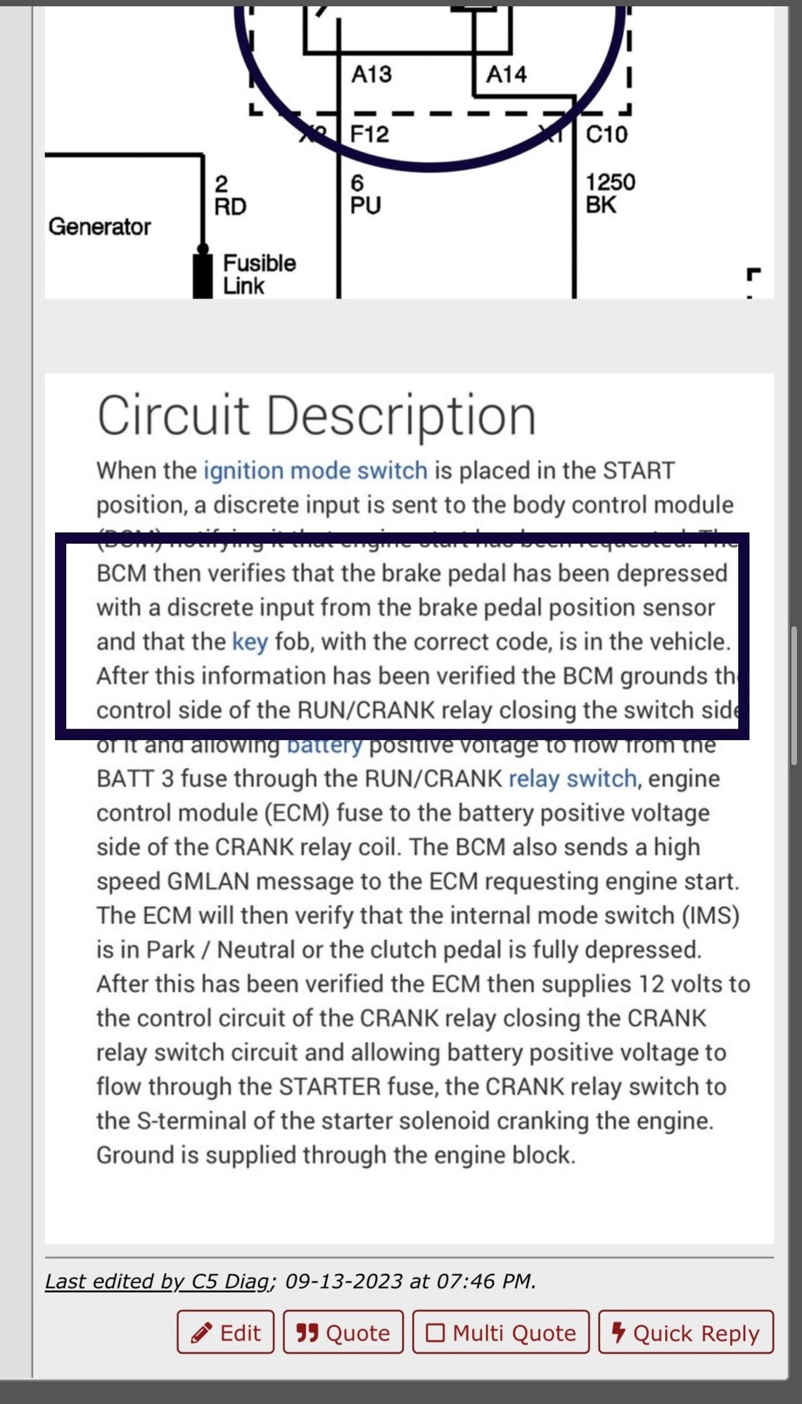

This could be a starter or the starter electrical circuit or one of the inputs that may cause the car not to start such as brake pedal or PNP (park neutral)…do you hear a "click" when attempting to start ??...have you tried starting the car in neutral ??…if you had a good bidirectional scan tool you can see the inputs that may prevent the car from starting…don’t know of your mechanical abilities but jumping the “load” side of the crank relay can rule out a bad starter…with a 12 volt test light you can do some other checks…if you think this may be over your head an auto electric shop would be your BEST bet…I’m not going to go into a long dissertation on what and how to check…below is some of the inputs I’d be looking at...interesting video below on this below.

The brake pressure “switch” is actually a 3 wire “sensor” (5 volt reference, signal and ground) which when you press the brake pedal the BCM sees that input along with the PNP which is part of the Internal Mode Switch in the transmission which sends a signal to the ECM and if ALL this magic happens the ECM sends 12 volts to pin 85 of Crank Relay 43 in the under hood fuse box… could check the signal wire at the brake pedal sensor and you would see a voltage of less than 5 volts when pedal is depressed…if you have a 12 volt test light you can check for this 12 volts at the Crank Relay and if the test light illuminates your inputs are good…to make the coil side of the relay function it need a ground…the ground may be bad…did you try swapping out the crank relay with another relay ??…a test light can check that too…instead of just shotgunning parts it’s best to have a systematic approach to diagnose this !!…I’d have to look at the wiring between the ECM and the TCM and see what circuit is either sent either a power or ground to the ECM so it knows you are in park…if you change the sensor you will need to do a “calibration” for that new sensor…a factory level scan tool is needed for this….did you try starting the car in NEUTRAL and do you hear "clicking" noises coming from the dash when you press the start button ??...you should…this may be easier for a pro to handle who has the right tools…don’t think I have any more advise for you…good luck !!

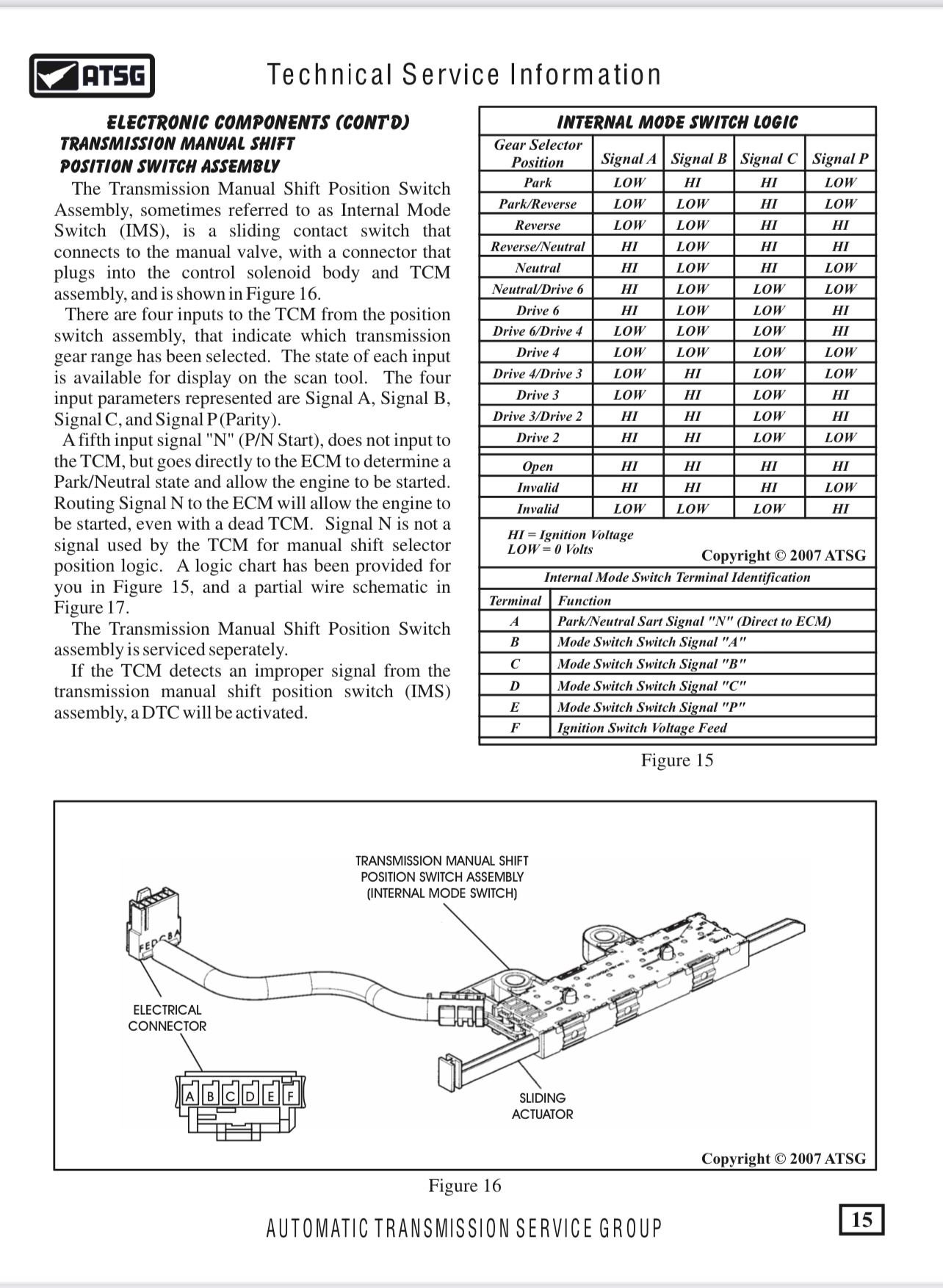

As long as you are in ACCY mode you should be able to move the shift lever from P to N and then start the car…no need cut anything and being you had this stuck in park issue that may be a clue here !!!…being that this is intermittent you can try wiggling Crank Relay 43 to see if you can make the car not start…it may be a loose connection in the fuse box…if good you can try swapping Crank Relay 43 with 47 (low beam) and both are underhood…I mentioned with a test light you can check one of the 4 relay terminals when the car is acting but I think it’s best to take it to a shop where they have more “brains” than wrench turning abilities…again as I mentioned find an auto electric or diagnostic shop in your area and let them play with it…I have a former coworker of mine in Pennsylvania that runs an auto electric shop and I’ve sent a few C5 guys to him and which were very happy with his work…sorry but your not going to find a magic bullet with your starting issue so it will take a little testing…and I agree totally about dealerships…they make their money replacing parts not diagnosing cars…speaking of “brains” and knowledge here is another good video below…Keith Perkins does programming and diagnostics and teaches programming and is VERY VERY sharp for a young technician…unfortunately one in a thousand techs or more have his ability…his rant is epic and is what we are dealing with in this industry !!…if your a snowbird and the car is down here in the winter I’d be more than happy to look at it for you…and there are some great diagnostic videos on YouTube…SMA is one of the ones I follow.

I don’t think you’ve read the starting system circuit description I posted but your “clicking”sound is the BCM’s RUN/CRANK relay being energized so that is a good thing…unless the car is not starting I can’t offer you any further help …unless you have a scan tool that can look at the starting system inputs this will be difficult for you to diagnose short of replacing all electrical components in the starting system…I’m guessing you never did check the terminal at the crank relay (underhood fuse box) with a test light as I had mentioned..good luck getting this fixed !!

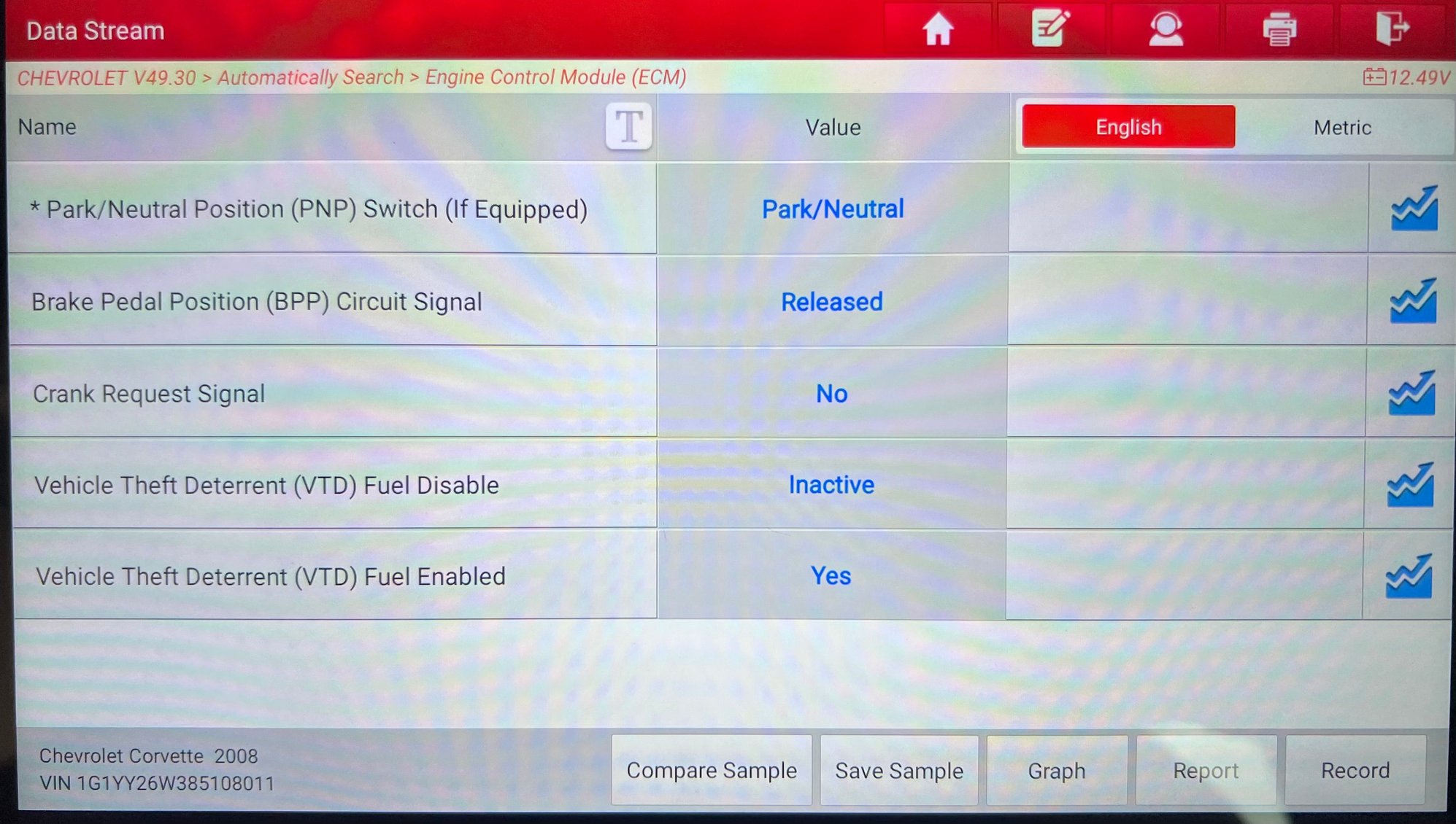

Yes, I hear the Stop Lamp relay clicking (relay in the lower left corner) with the car running so that is what I assumed was the run crank relay…I explained how to check terminal 85 and the crank relay 43 with a test light but in either case don’t worry about learning about electrical at this point…I’ve done some electronics/electrical in the airline industry for 43 years and heavily over 15 years in the automotive and I’ve only scratched the surface in knowledge…I still try to attend in person or online classes still today…if the car is not your daily driver find an auto electric shop and let them play with it until it doesn’t start so you don’t get stranded…it’s not something like a blown fuse so you’ll only find guesses here…you need to gather evidence to diagnose this…there is only so much we can do for you and as was mentioned try starting in neutral if this happens again with the start button in ACCY mode.
