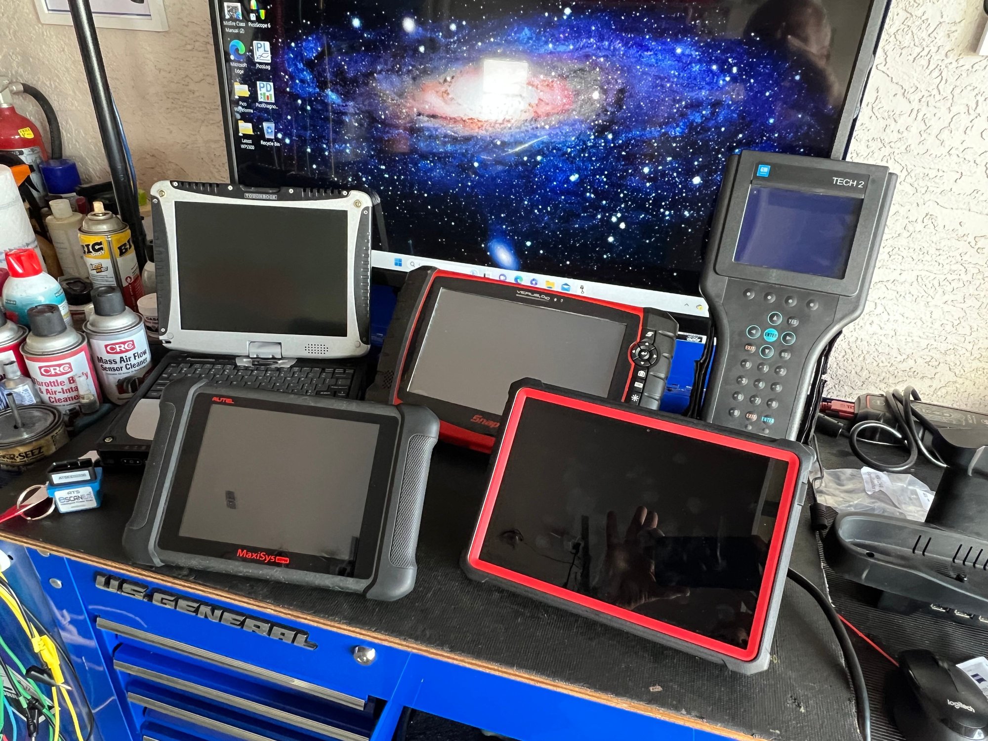

There is no really “best”…some may do different things than others…that’s why I have all of these below…LOL !!…5 are scan tools but one is purely for diagnostics…the ATS EScan Elite…if you intend to use it different automotive platforms a good aftermarket scan tool like Autel, Launch, or Bosch are good…getting a bidirectional one is a must if you want to diagnose your car instead of bringing it to a dealer who will just replace parts…if just for your Corvette you can go for a “Chinese Clone” Tech 2 or a VXDIAG VCX NANO which sometimes can be glitchy with the software.

C5 Diagnostic I like your toys!
