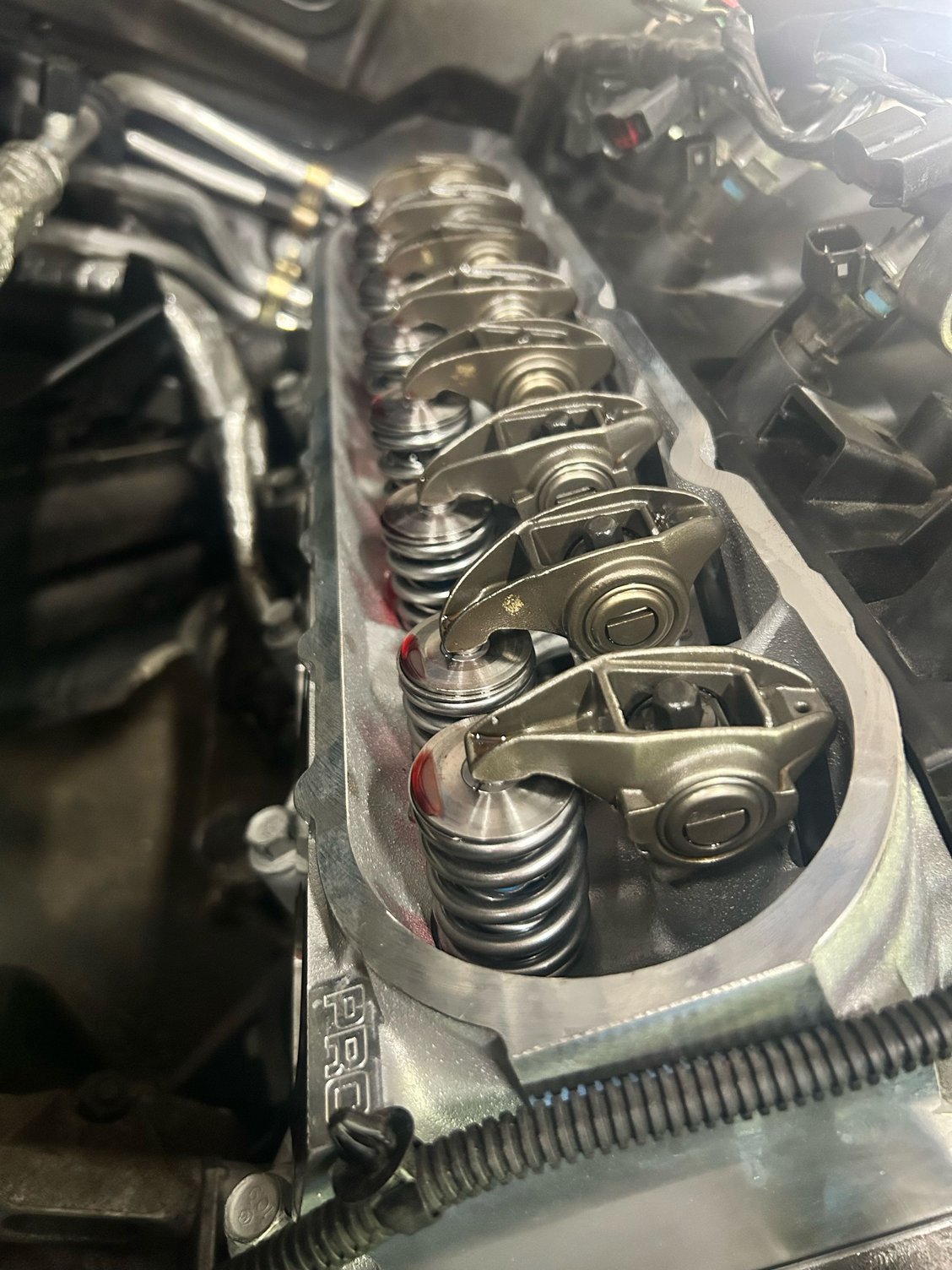

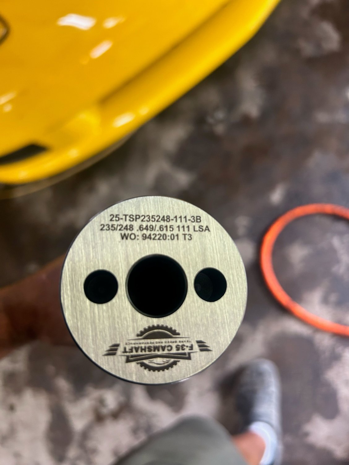

I recently did a H/C/I setup on my 05 c6 and I know the diff is weak, what are my options for upgrading it?
