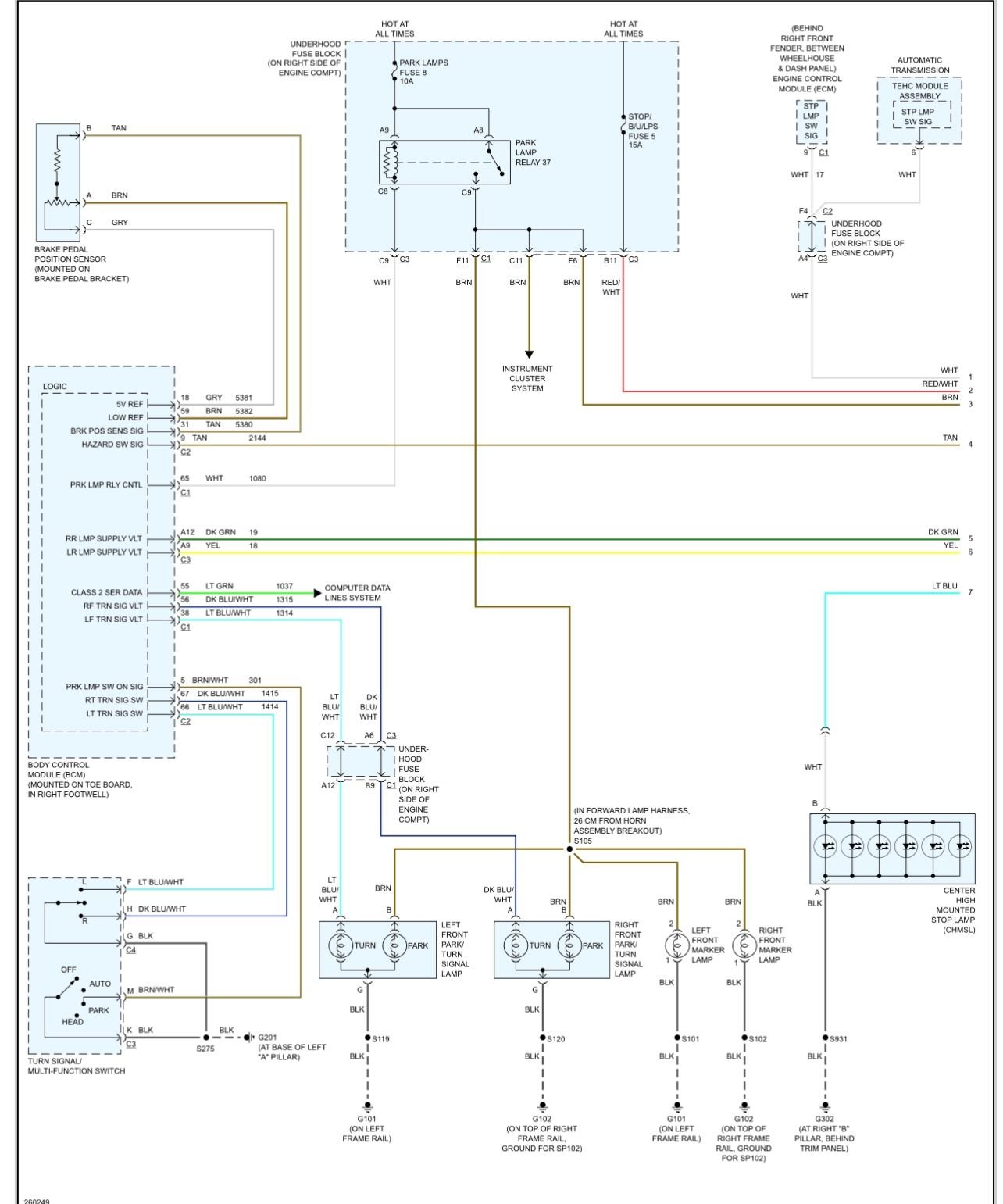

Sounds like possibly a bad Park Lamp Relay #37 with what you are seeing...you can try swapping it with the horn relay (make sure the horn is working first) and see what happens...also check Park Lamps Fuse 8 (hot at all times) to see if it's blown...always best to check BOTH sides of the fuse with a test light and make sure you have power to both test points......if still no good we will have to look at the relay circuit.

Here is the second sheet to C5 Diag's post. Are your left and right marker lights out also? License plate lights?

As a new member we need to know your model year as a MINIMUM…if your markers are dim that is usually a ground issue..G302 is the ground you need to access…right B Pillar behind the trim panel…this wiring is for an 08.

Just remove the marker light connector and take a 12 volt test light and connect to B+ somewhere and touch the tip of the test light to the black wire terminal on the marker connector…if the ground is good the test light will be bright… I use various test lights of different amperages to match the circuit…front shouldn’t affect the back.
