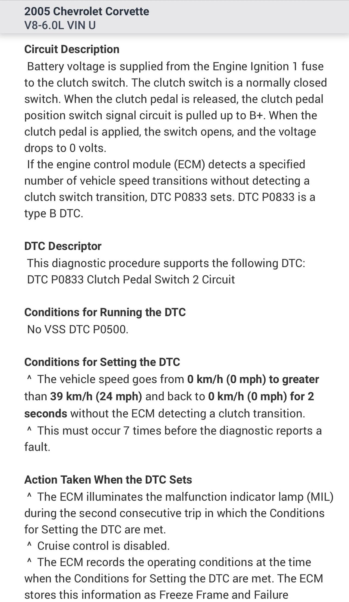

Here is the wiring, circuit description and diagnostic tree if you need it.
