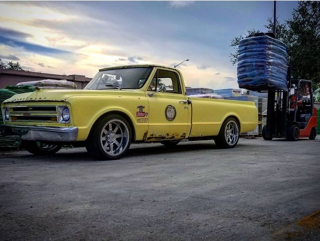

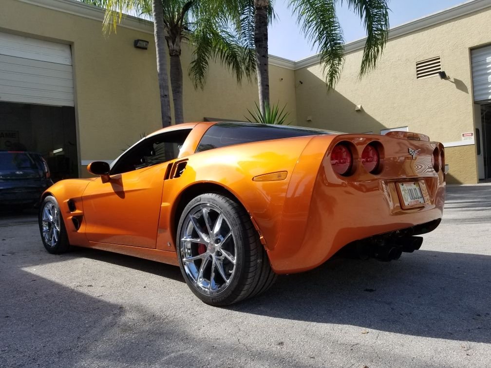

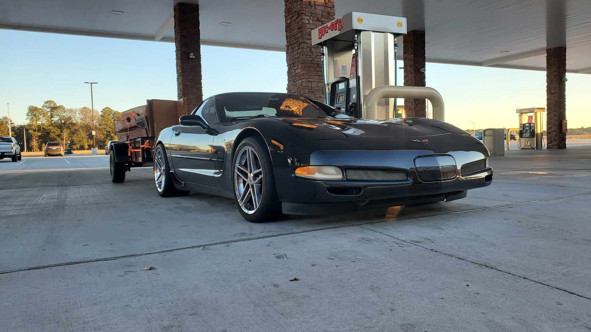

Built 09 Z06, just totalled a C5Z (not my fault!), had a bolt on Trailblazer SS (that accident was probably my fault), and I've currently got two C10 pickups. (67 rat rod and a better than decent 71 daily driver)
