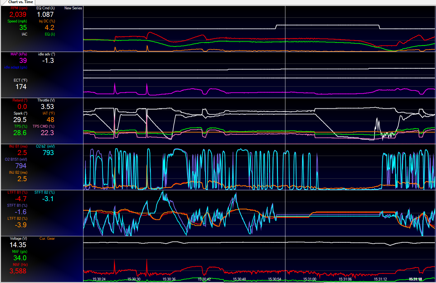

Thank you for the response! I do not have any misfire codes stored when I go and read them and I do not see any misfires when I log and drive around, but perhaps it's just not catching them with the tune I have. Not so sure there. As far as the TPS sensor it doesn't look like it's dropping out at all. I went and did a loop around the block and logged what I could. I kept throttle as constant as I could with the bucking. Doesn't seem to be dropping out at all. I don't know entirely what to expect out of the O2 sensors but they looked about what I would expect from them? Again not too sure what to look for there. The STFT flatlines half way through the constant throttle, not too sure why. Is there a good way to diagnose a flaky crank sensor?
Another constant throttle at ~45mph:
