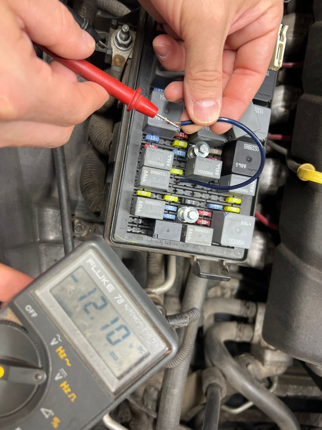

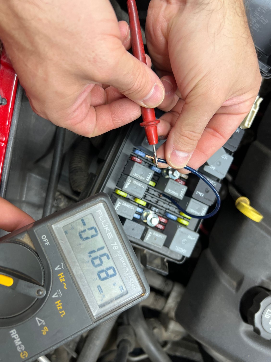

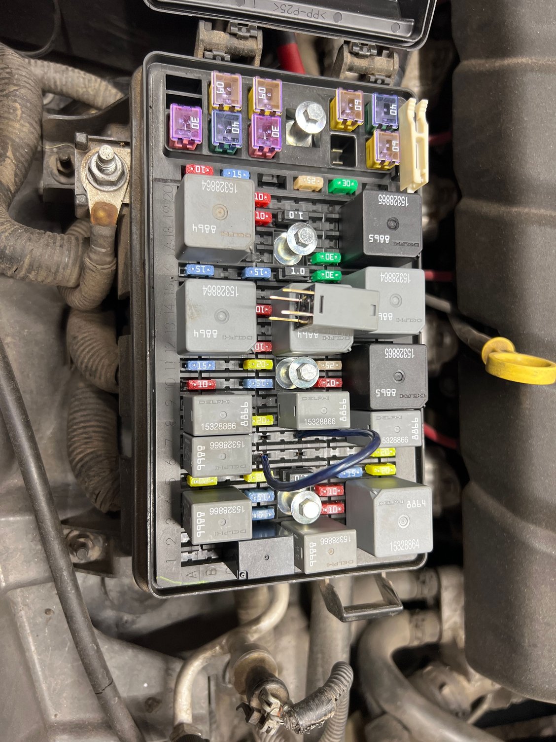

Hello sorry for the late response i was at work. But i get voltage from the top right and bottom left closest to the fender, but negitve from top right and no voltage bottom left i attached images because it sounded very confusing as i typed this . Thank you very much again for your help!
closest to the fender, but negitve top right and no voltage bottom left

Relays like this are best checked with a 12 volt incandescent test light…one with a bulb and not LED…a voltmeter if you don’t understand these relays are designed can get you in trouble or be misleading.
