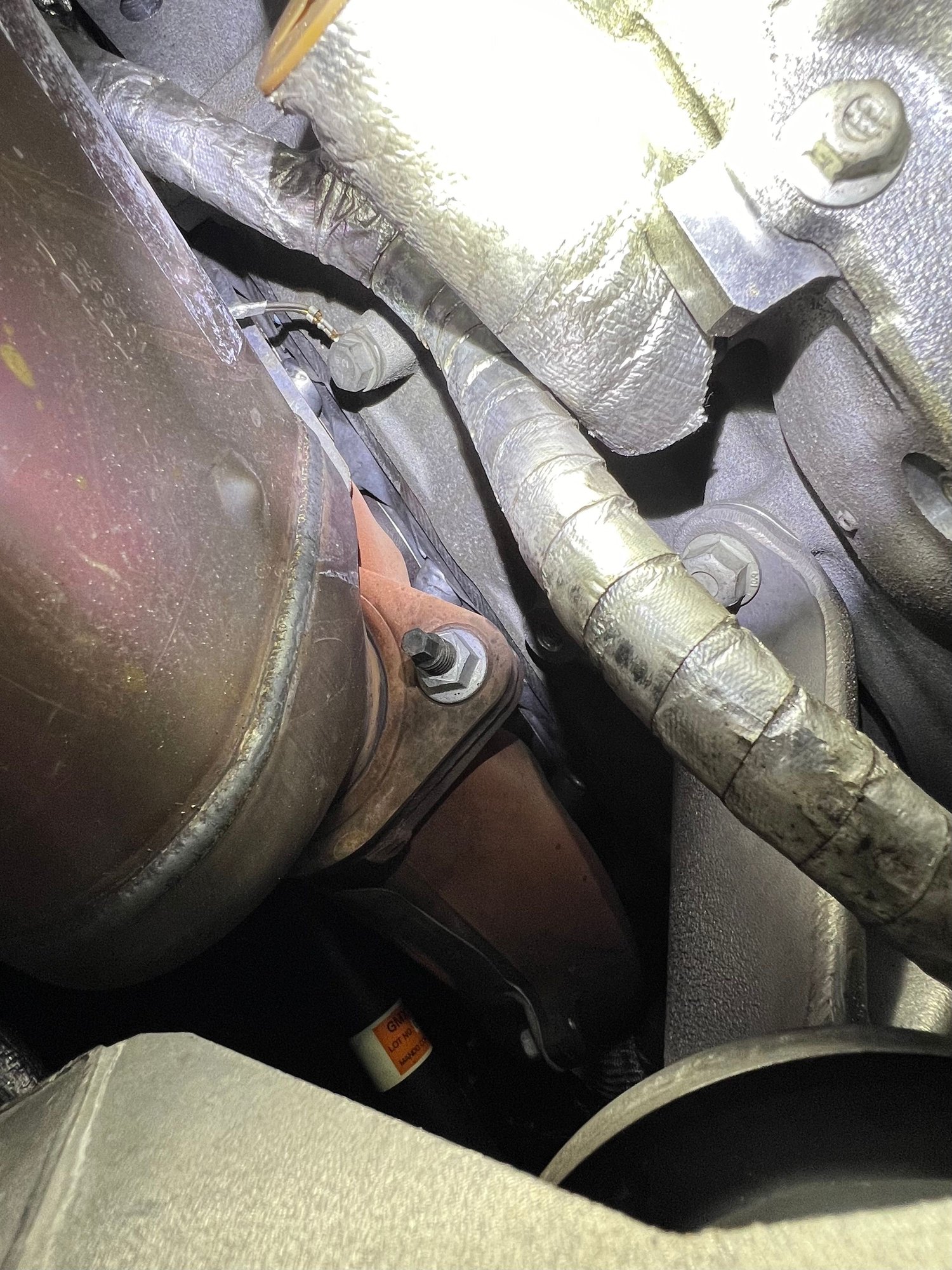

There are 2 fuses that power each coil pack and also the injectors…these are fuse 12 which powers odd injectors and coil packs and fuse 16 which powers even injectors and coil packs…all you need to diagnosis this is a 12 volt test light…all 4 coil on each bank have a ground wire which is on the center of left cylinder head pictured below on my 08 LS3…it is pictured to the right of my catalytic converter…yours should be in the same place…you can do the wiring checks on this connector which is on top center of the engine…also if you have your scan tool that can read misfires see which cylinder or cylinders are misfiring…a cheap code reader won’t tell you.

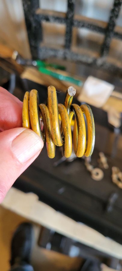

UPDATE UPDATE It's a broken valve spring that caused one of the valves to bend. It will be at least three weeks before the head comes off to inspect for more damage. I would like to be optimistic but I'm prepping myself for a damaged head and piston. When my mechanic pulled the valve cover off and saw the yellow springs, he knew to look for a broken one from experience. He did find the valve retainer clips and I guess that is good news as they didn't go into the cylinder. Anyway, this certinally opens up a new chapter with this car and some decisions to make with the engine. I can't believe with 38,500 miles this would happen but $%# does. If anyone has previous experience with this damage, all suggestions are very appreciated. UGH!!!!!

If you didn’t hear any tapping noises, I’m going to bet the piston didn’t break and just left a mark. If you swallowed the whole valve, then engine is likely toast. Good luck and report back!!

A bent valve likely didn’t severely damage the piston. Change valve, valve guide, fresh springs, valve job, and you should be on your way. I’ve had the same exact damage and that’s all it was. I did drop a valve later on after too aggressive of a cam…..that engine cracked a liner and ruined the block

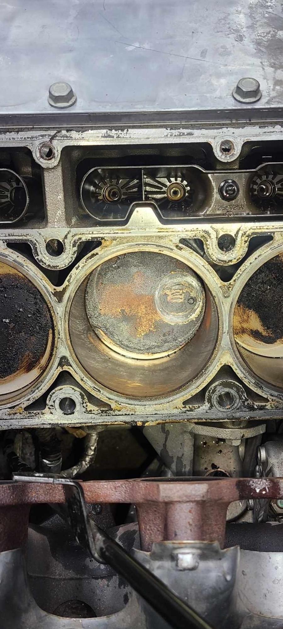

So here's the result of the broken valve spring. No visible cracks on the piston but I'll magnaflux it to make sure, and the push rod is bent too. The head is now in the machine shop getting all worked up.
More to come I'm sure.
