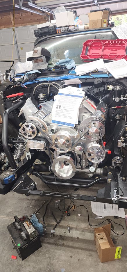

Could anyone here help me out with checking some measurements for me?
I'm looking for the block face (waterpump mounting surface) to the farthest accessory point.
what i have going on is I'm LS swapping a 66 Nova and using a CVF wraptor system and an entropy radiator/fan setup.
the room I have is about 14.25" and the total depth of the CVF is 7.75" and Entropy is 7" at minimum, so I have a nice (not so) interference.
I'm hoping that the total depth of corvette accessories is under, or right at, 6" to allow some clearance.
Also, if anyone might know of a cost conscious place to buy the whole setup together, the info would be appreciated.
Thanks to all in advance.
Here's Here's for the fun of it. The CVF kit is a great looking setup, bit I really want to use the Entropy over all the other rads I've seen, plus the others don't seem to be confident in being able to cool the 408 I've got in it!
