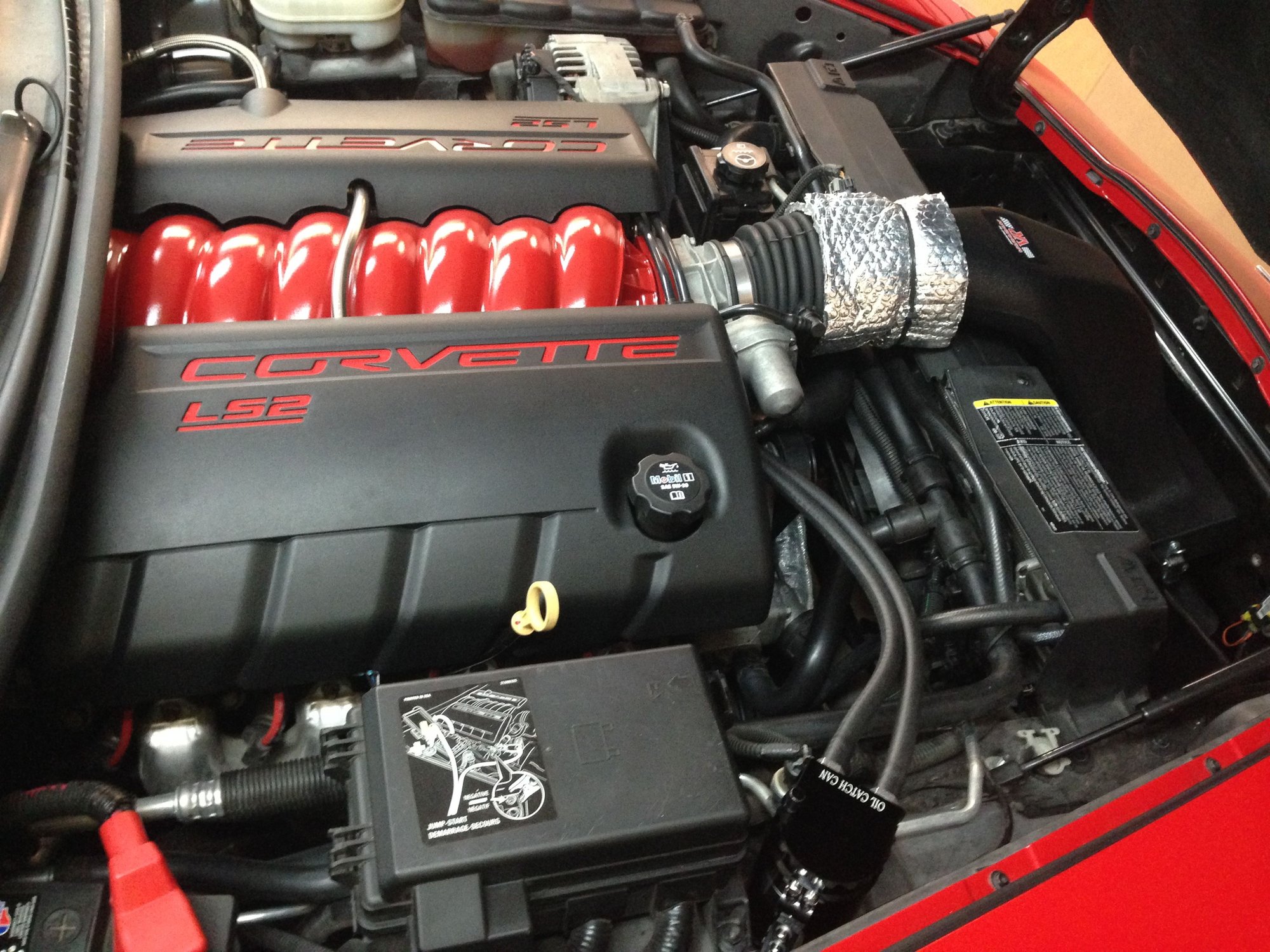

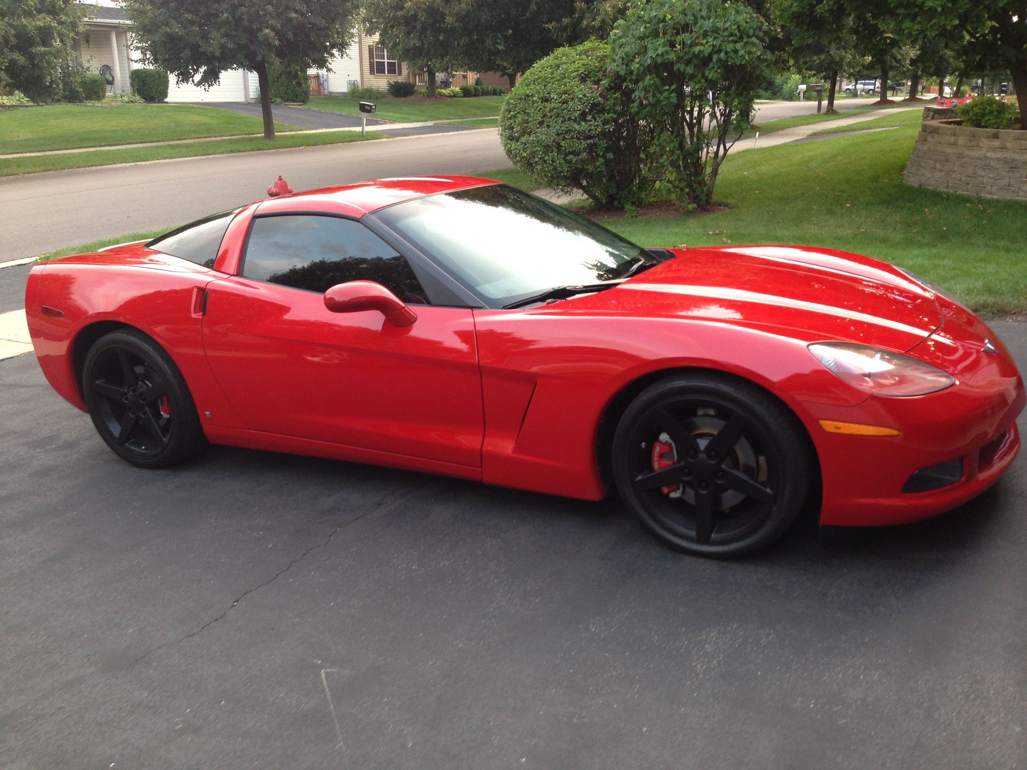

This is what I did on my 07 m6, my HB did go bad when i was road racing it so as mentioned above you might want to get a good aftermarket one with an ARP bolt! Now on to the mods, I ported the stock intake, slightly blended the high spots and ridges on the TB.... NOT ported it but just blended, I added a vararam CAI with paper filters in place of the green filter, catch can, and a 160 t-stat. Car did feel like it was making more power, Next summer I added one step colder delco plugs, new delco wires, ZO6 manifolds, down pipes with stock cats, 3" zo6 H pipe that necked down to 2.5" before the axle then into npp mufflers. Took it to be tuned and it dynoed at 395hp and 402tq . so, for about $1500 parts and tune i picked up about 50hp, I'm happy
