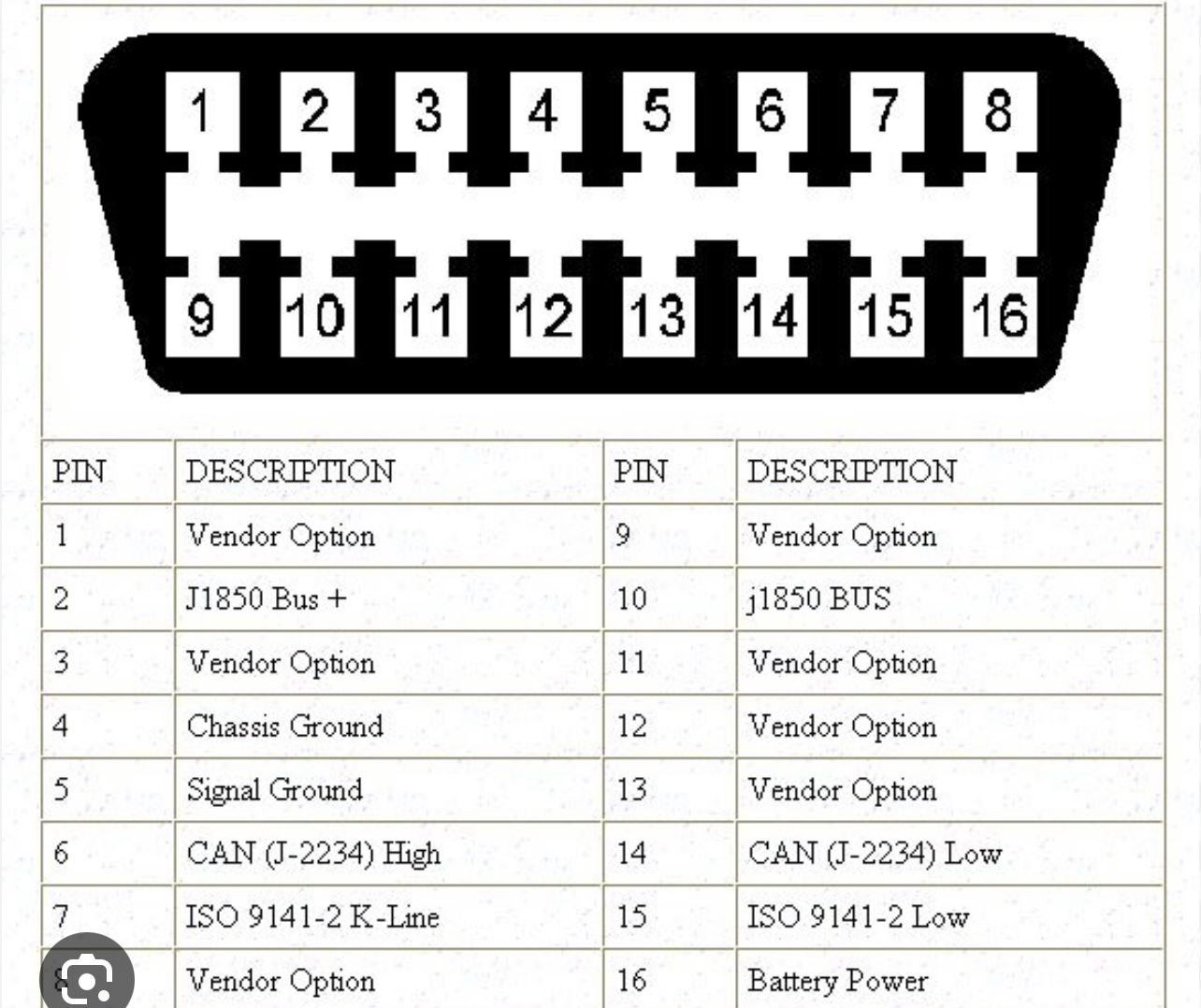

Is “DLC “ the OBD11?
Yes !!…you are concerned with pins 2,6, and 14 !!…I have actually shorted the bus to power and to ground (won’t damage modules) and crazy stuff happens !!…no start, no FOB etc…
