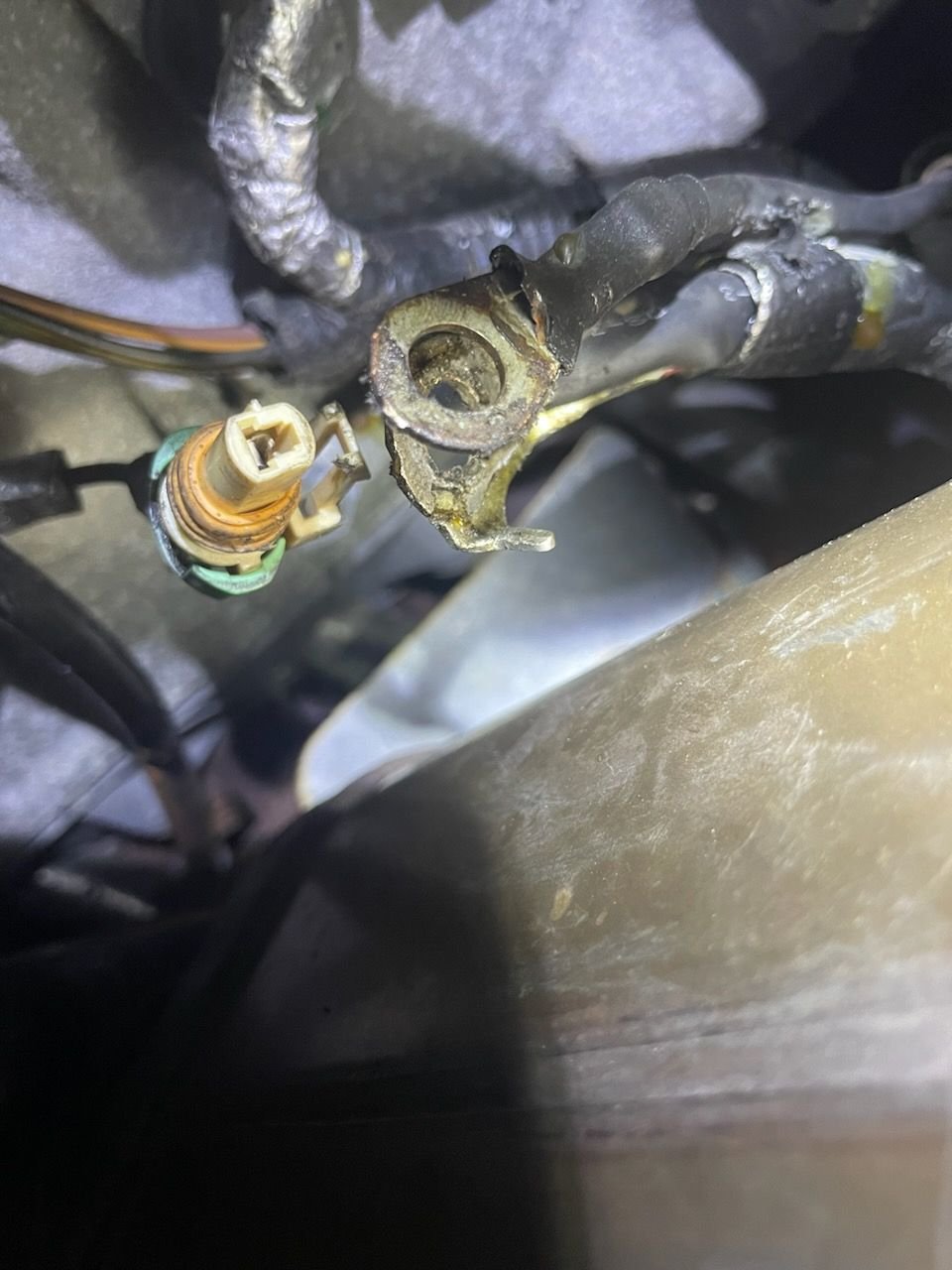

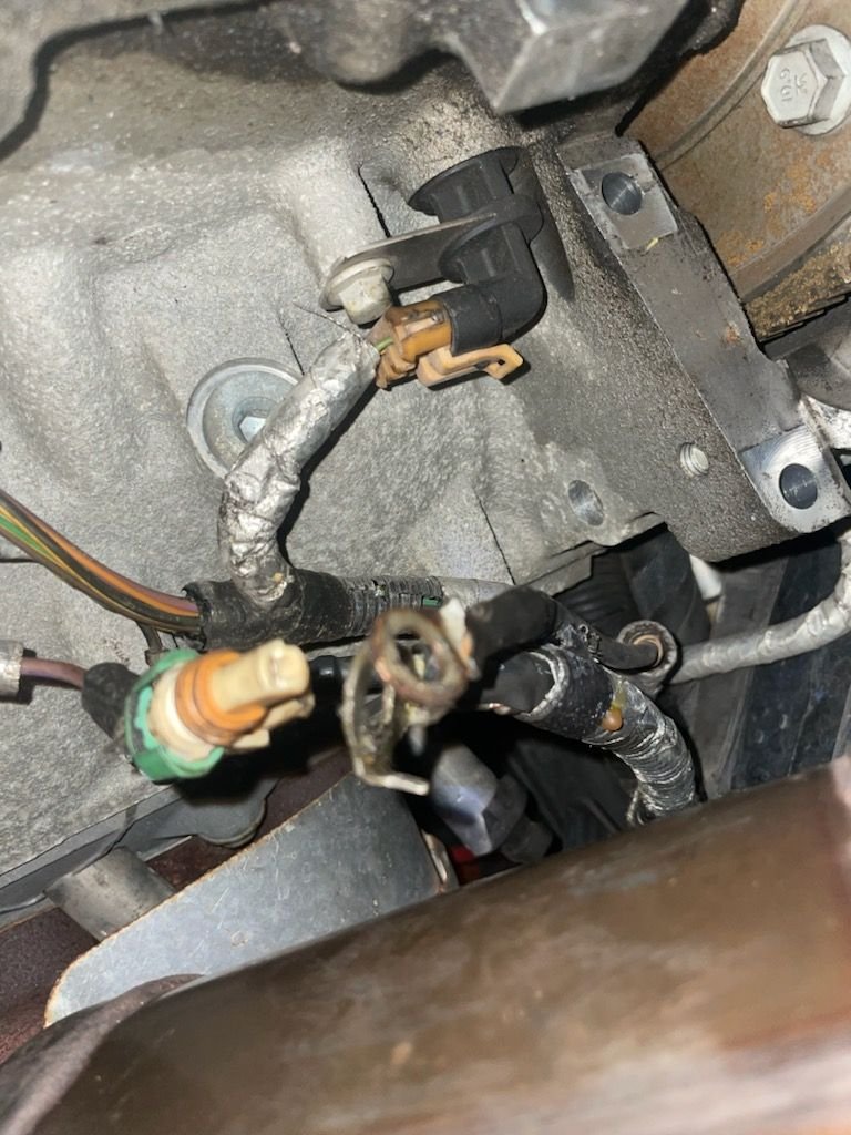

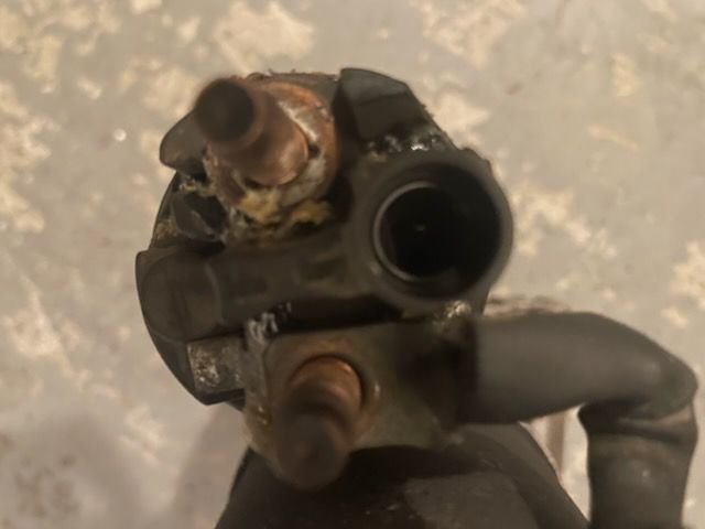

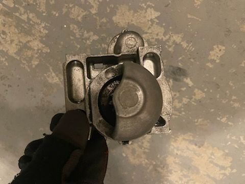

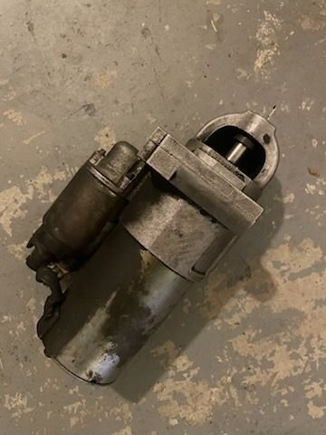

Removed the starter yesterday morning.
The process was time consuming due to the fact that the plastic connector was difficult to slide out.
Also, the terminals appeared to be glued to the starter/solenoid post:
The connections on both the terminal ends & the starter/solenoid are covered in a sap-colored resin:
Took the starter to a total of 3 Auto Parts store:
1- Advanced Auto Parts: The employee stated that she was fairly new; did not know how to operate the diagnostic machine
2- Advanced Auto Parts: The employees claim that the diagnostic machine is down.
3- AutoZone: The employee hooked the starter up to the diagnostic machine. Typed in the Year, Make, Model - Starter #. # Appeared greyed out. Employee claimed that the started cannot be tested outside of the car
Either or, I have a new starter on the way so "testing" the old one is the least of my worries.
