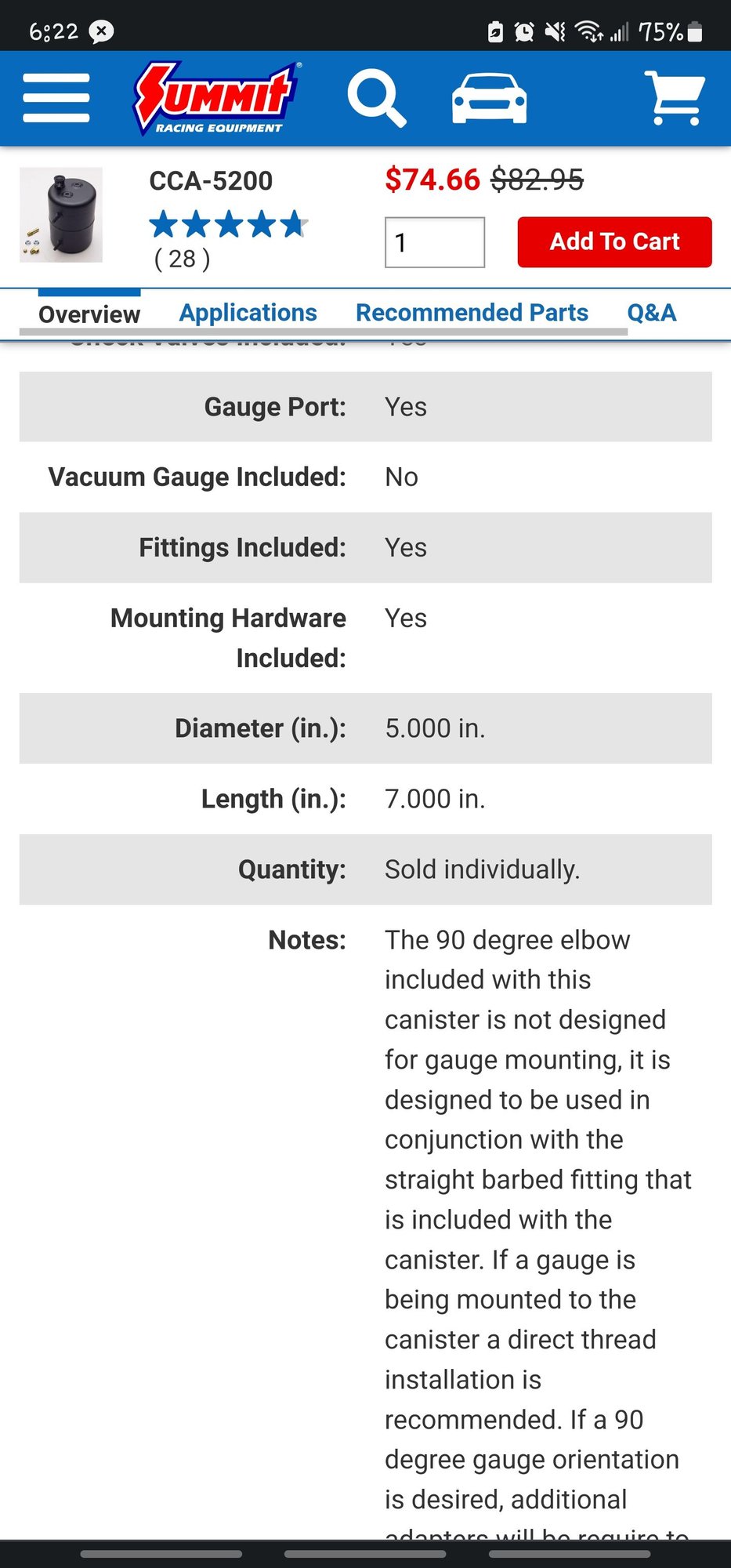

Curious, how large is it? Its hard to tell by the picture Summit has. And how does it hook up? I just see the one fitting/port at the top. Thanks for your help
There's a second port not shown. It's goes inline using the hose to the brake booster.
7"x5"
