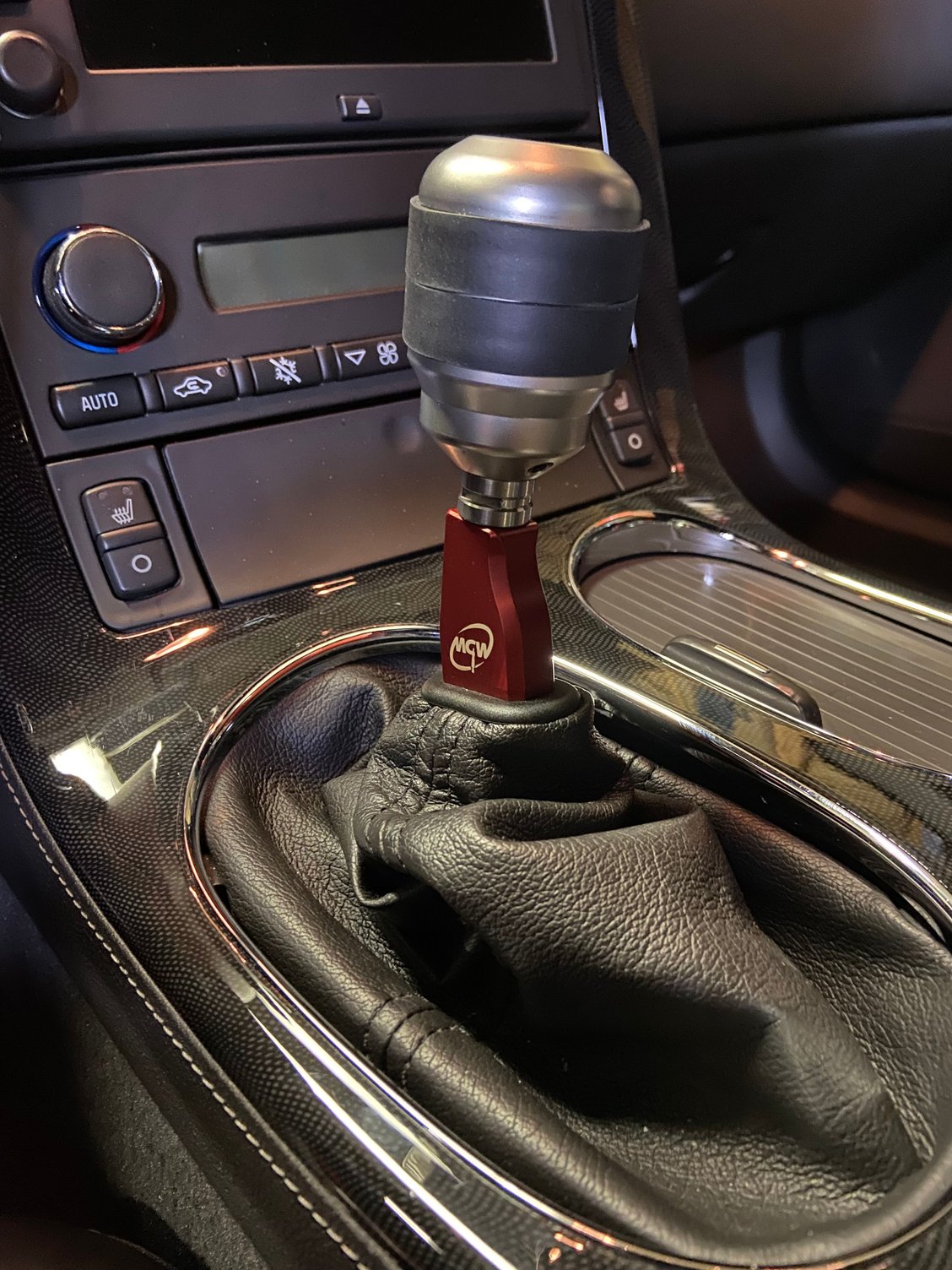

MGW is probably the best and most popular aftermarket shifter for C6's. I owned two of them and I did love it. I did find after a while that the throw was a bit too short for my tastes.
Some of the notchiness is just the nature of the transmission.
I now have a TMOD Customs lower box with the factory shifter in my GS. The GS shifter is the same as the Z06 shifter and is shorter than in the base C6's. The TMOD Customs is an upgrade to the stock box and is a great option.

MGW Shifter is one of first mods I added to my 2013 GS. Yes, to some, it’s notchy or too tight or shifts are too short. But to me, the MGW gives me perfect shifts every time.
With that said, it all comes down to the driver and what feels good. Most sticks to the OEM. Others will go with aftermarket.
