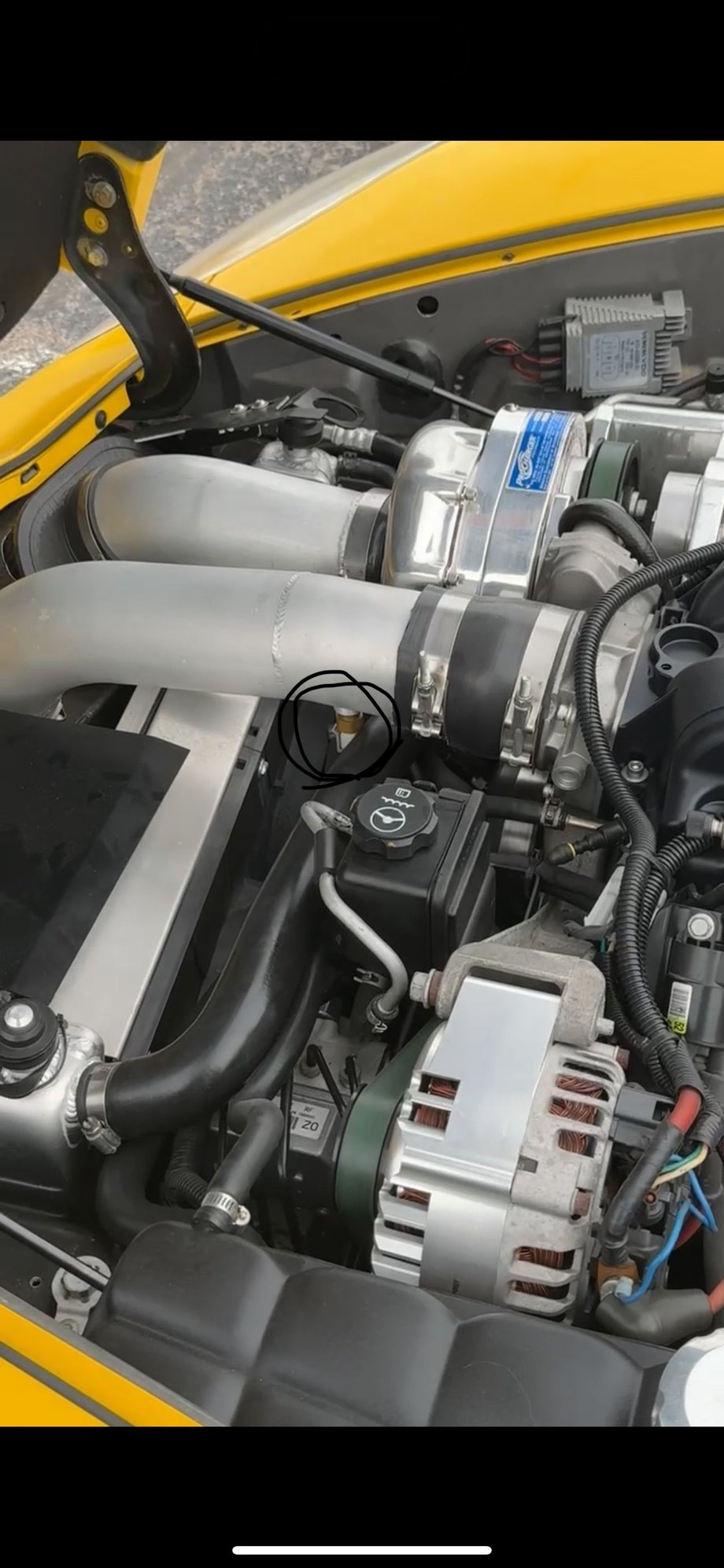

My maf sens in the bottom of the charge pipe i keep getting a p0102 code low and high circuit whenever i do pulls any help is greatly appreciated thinking just a tune will fix it

What a wild place to put the sensor. Any oil or water that makes its way in there would be right on the sensor, rather than just being passed by in a mist like if it was mounted higher up. Also, that almost looks more like an IAT sensor.
Quick google search definitely is an iat sensor i read on another forum that procharger had relocated the mafs to the bottom of the charge pipes so i assumed that was it

Soooo where's your MAF lol? may be why you're getting a MAF code. Are you speed density tuned and the tuner forgot to get rid of that code?
i have no clue i was reading some are im the intercooler then some are in the iat sensor lol i got the car a few weeks im guessin the last guy got the procharger and never tuned it... smart guy bc im also having some trans codes patiently waiting a reply from HHP to get this all squared away

If it’s not tuned at all, you need to stop driving that car. But it sounds like if you’re making any kind of pulls that it’s tuned, just not well.

The MAF has an integrated IAT. If I had to guess, they are using the two wires in the MAF connector that are dedicated to IAT and wired them directly to the external IAT. This is a common thing that people do for deleting the MAF. If you are still getting a code then they did not disable the MAF properly in the tune.
Taken From LS7 MAF Swap Pin Out Information (g8nation.com)
LS7
Pin - Wire - Circuit - Function
A - 0.35 YE - 492 - Mass Air Flow (MAF) Sensor Signal
B - 0.8 BK/WH - 451 - Ground
C - 0.5 PK - 539 - Ignition 1 Voltage
D - 0.35 TN - 2760 - Low Reference
E - 0.35 TN - 472 - Intake Air Temperature Sensor Signal

yup! Many people use a break out harness, including me, when they run meth. Pretty common to delete the MAF and run an IAT, his tuner just did a poor job of tuning.

thanks for all the input guys ive been losing my mind trying to get this **** right car was tuned before i got it will be getting it retuned soon
