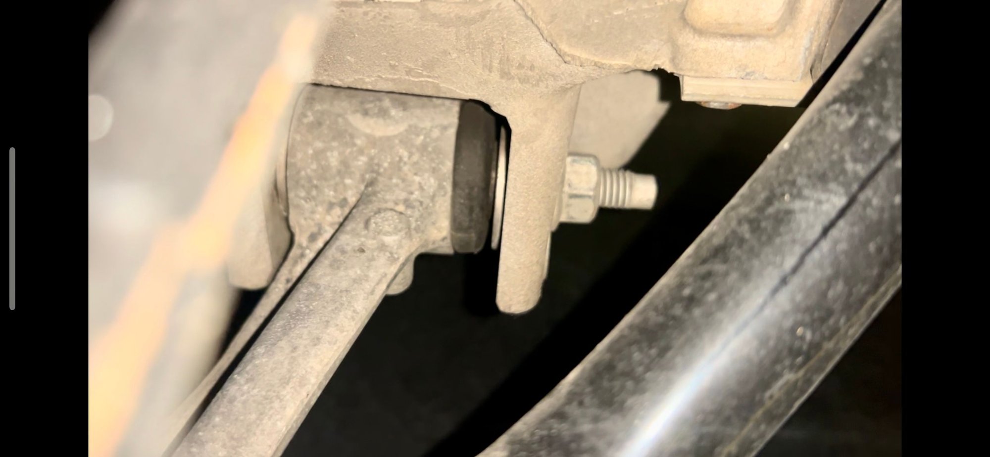

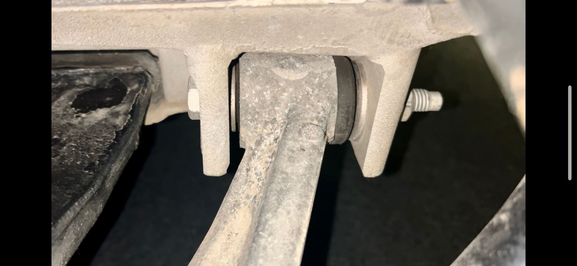

Also I took a couple of pics of the lower control arm bushings on the passenger side, so these look worn? The driver side looks the same.

From the pix, the bushings look OK to me... kind of hard to tell. Can you move the control arm back and forth, if you pry between the carrier and the arm?

Very unlikely that the missing bolt would have done any internal damage to the rack or tie rod.
It's tough to tell from the video, but the rubber part of the R/H, forward, upper control arm bushing might be slipping out?
If it walks around, it can effect caster, which will cause a drift. "Pulls to the side with the least positive caster."
My best advice: Try to find a competent front end shop, have the whole car, front and back, inspected, and then realigned.

I would mention it to the alignment tech, and ask him to loosen and re-torque the nuts with the car on the alignment rack. With the nuts loose he can see if the links are unloaded with the wheels level. If they're not, the bar is being preloaded, which you don't want.
Also, the tech should be checking his work by driving the car after alignment. You shouldn't be the one to discover whether the car still pulls to one side.
Whats the best way to go about tightening the end links with the suspension loaded if doing it from jack stands?…just put a floor jack under the control arm and jack it up some?
Also what’s the best way to make sure the sway bar is centered? There’s no positioning marks on the sway bar for where the bushings go best I can remember. I know it sort of aligns itself once the end links are in position but technically it could still be off centered since the bar can move side to side
I would do what I suggested, tighten them up however you can, and have the tech crack the nuts loose and re-tighten them on the alignment rack. It won't amount to much, because there isn't much play in the mounting holes, and stock links are not otherwise adjustable.
If you find it difficult to get the links in the holes without jacking up one suspension arm, something is crooked, in which case your bar may end up pre-loaded. This will be obvious on the alignment rack.
As for centering the bar, just make the ends equidistant from the frame rails or other reference and you should be fine.
I would take the car to an alignment shop that knows Corvettes and does race cars. Racers are much more picky about alignments.

Just to follow up on this, I replaced the inner/outer front tie rods, removed the front sway bar and end links and re-installed making sure it was centered. Replaced the rear outer tie rods, removed the rear sway bar and re-installed making sure it was centered. I also torqued all the end link nuts to spec with load on the suspension. Got an alignment scheduled for this Friday so I’ll follow up with the results and post the final numbers.

Alright guys I am beyond aggravated with this car. Got an alignment today and the car still pulls to the right just the same as before, no change.The tech spent a good two hours on getting it dialed in. I am convinced either my steering rack is messed up or my tires are bad, despite them being new. I replaced inner/outer tie rods on the front and the outer tie rods on the rear. That’s why the before is so out of spec on the alignment sheet. What the heck is going on here?!? The car did not do this back before the balancer was replaced and the new tires and sway bars were installed.

Wow, the alignment tech did a great job holding the tolerances to basically nothing.
Tip your technician appropriately!
Other than the rear camber being a little out, the before readings should have been pushing the car to the left.
If you've already swapped the tires side to side (try the rear too, just for good measure...), it just may be in the rack itself.
I've heard of it, but never actually saw one for myself.
Just out of curiosity... does the steering wheel turn the same number of degrees to the left as to the right, before it hits the stops?
Possible that the rack was reinstalled off center during the damper replacement.
Steering gears are cut with a tighter spot at center ("High Point"). I don't imagine it would cause a pull if it was off, but it might account for it being harder to turn one way, as you approach high point.
A longshot, but I'm running out of ideas!
Just to be absolutely sure that it isn't road crown, try the same stretch of road both directions in the same lane.
Think industrial park, early Sunday morning?
Good luck!
