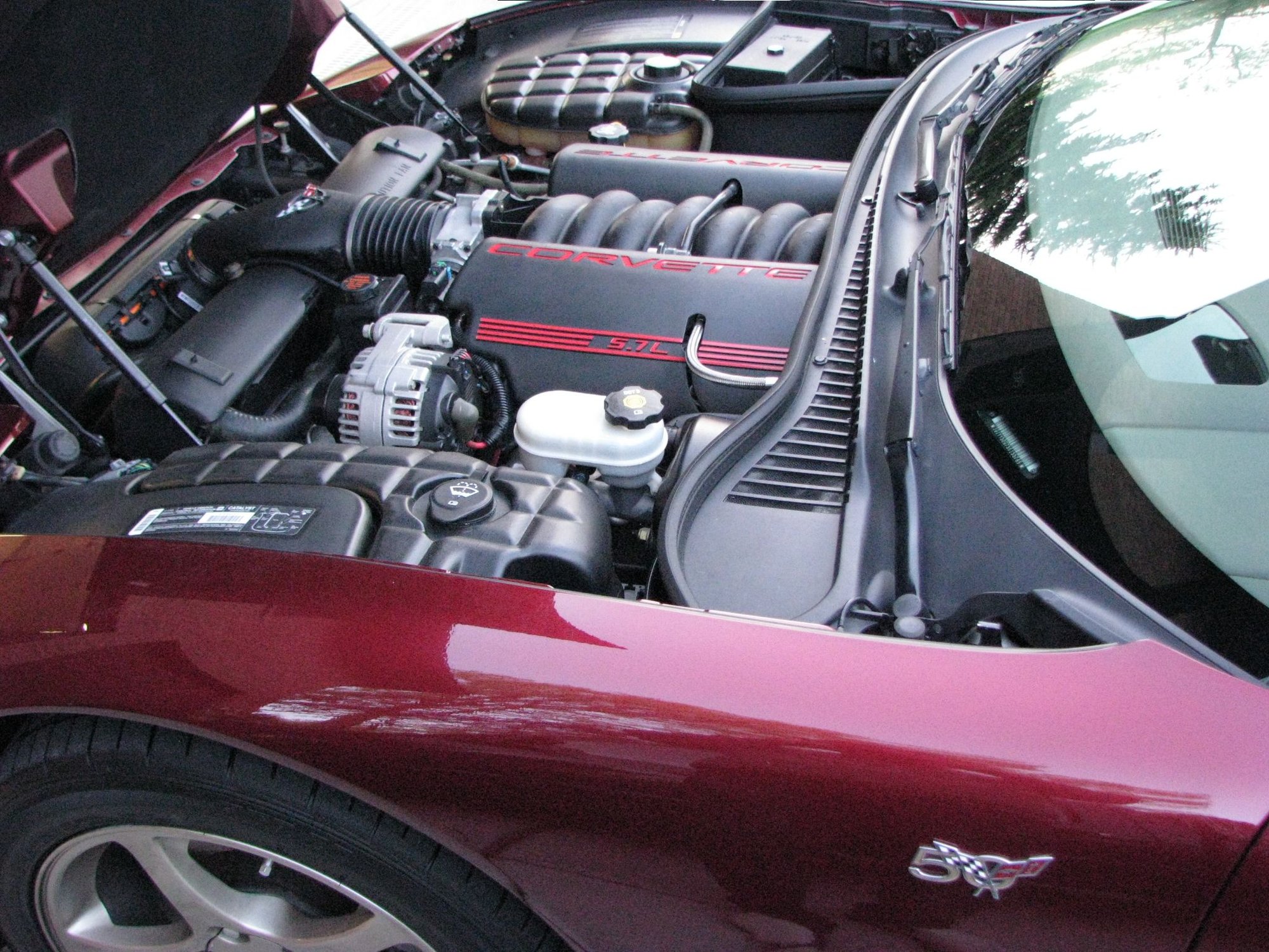

Over the years, I replaced oil sending units on a 1999 and 2003 C5. I assume the same applies to a C6. Each time I removed the plastic intake manifold to gain access to the oil sending unit.
Removing the plastic intake on a C5 was a lot easier than one would imagine, very uneventful. There is a stainless steel braided line that I kept attached. I laid a thick blanket on the driver side, then carefully flipped over the intake with that line attached, placing it out of the way of the work area. It was also an opportunity to clean areas that are otherwise inaccessible. As I recall, I had the job done in under 2 hours which included my cleaning.
The soft rubber intake gaskets on those two lower mileaged C5s (under 40,000) happen to be in great reusable condition. On a high mileage Corvette, consider replacing the gaskets, especially if they are no longer soft and pliable, not springing back to their natural shape. If that is your case, it is time to replace them anyway for preventative maintenance.
I point here is......Don't be afraid to change the oil sending unit that way if GM says that is the official process. On the C5, it is so much easier than imagined. Surely DON'T hack up your Corvette!
The braided stainless steel line I mentiond, you can see it well in this picture.

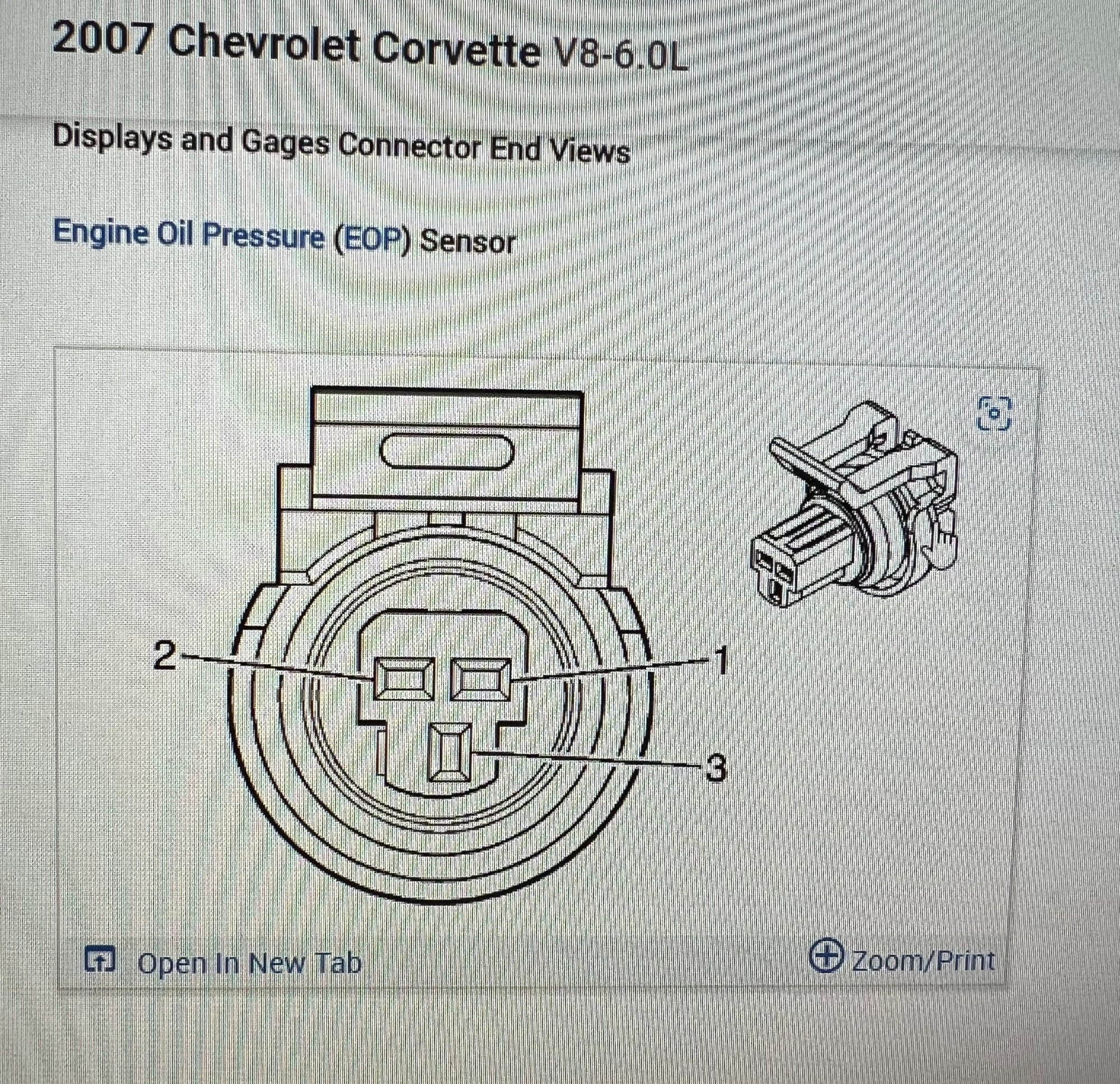

If your oil pressure is stuck at 24 psi and you replaced the pigtail I’d check if it is correctly wired !!…black is a reference ground which is an ECM ground and the gray wire is a 5 volt reference…the tan/white is the signal wire …what I do to check is jumper the 5 volt reference to the signal wire and you should see 5 volts on the oil pressure voltage Data PID on the scan tool.
To 114 oil pressure

Could it be this plug I got from amazon is pinned wrong? The black wire is on the single pin at the bottom (below the catch)
3 is black on the connector.
Don’t worry about the wire color on your new pigtail…just compare the connector pigtail orientation to the sensor
yep just rewired per your diag and bam....normal psi of 40 and runs up with rpm. .your are the best!!
