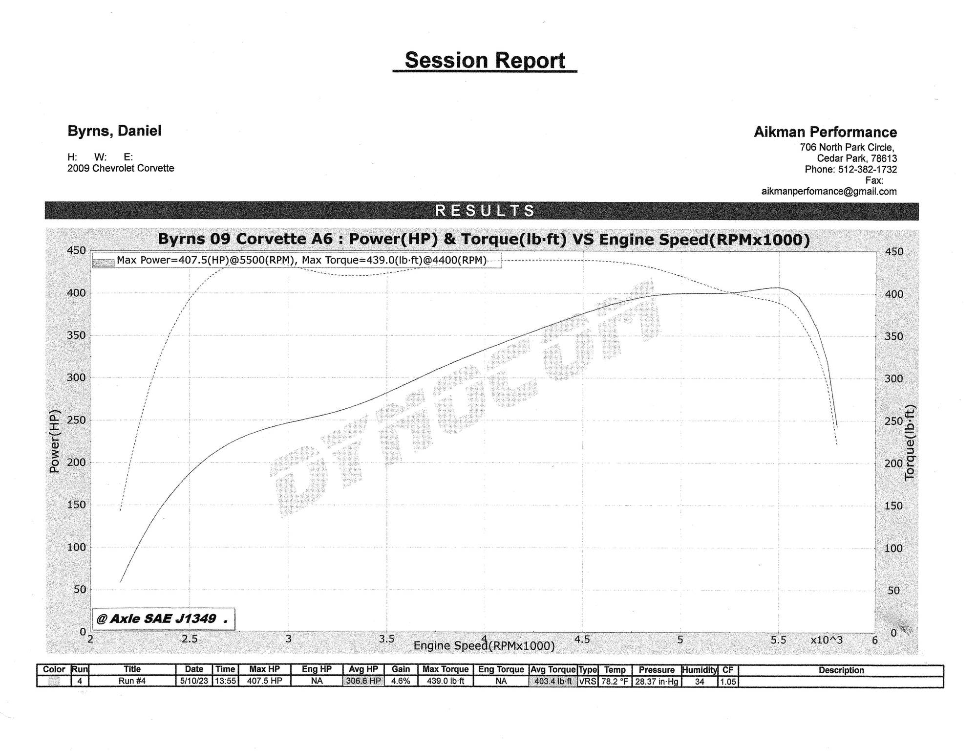

Here is the dyno I just had done on my 100% stock crate motor ls3:
is it just me or does this seem really high for a stock ls3? Thinking there must have been something off with the dyno but not sure. Maybe it is possible. What do you guys think?

All stock, graph is off (too high for RWHP), and really need to see what buffering was used, and even what kind of dyno.
Hence some dynos will read high to begin with, while some tuners will change the buffering from base run, to final run, so looks like they got more power out of the engine with return.
Bottom line, max our going to pick up from base to retune, is about 15hp, and with the numbers your showing, would take header, and a radial cam as well.
So M6 rans all stock LS3, should be about here instead.

that is what I was expecting as well - something around 390ish rwhp. But i just saw this article from motor trend which made me think maybe there is something special about the ls3 crate motors? My engine was a new ls3 crate motor so maybe there is something special about them that allows them to make an extra 10% rwhp?
Here is the article i am referring to: https://www.motortrend.com/how-to/15...aft-dyno-test/
in this test the engine made 500 flywheel which would work out to about 430 wheel which is what i am seeing

After tune my stock LS3 got 409 HP

The baseline dyno run when my 2009 auto LS3 was stock was 387 hp.

GM does offer an LS3 crate engine with that comes with a cam upgrade. You'd see similar numbers to what you're seeing if that's what you ended up with.

Its a stock cam ls3, it was the 430hp ls from summit racing. I guess the most likely scenario is there is something off with the dyno?

this was mine after tune

Double check the Serial number. They could have shipped the wrong unit.
but then again, pretty easy to tell if its cammed.

yeah it wouldnt idle at 550 with a big cam, also wouldnt start at all with a stock tune. It is the stock cam. Something must have been off with the dyno.
