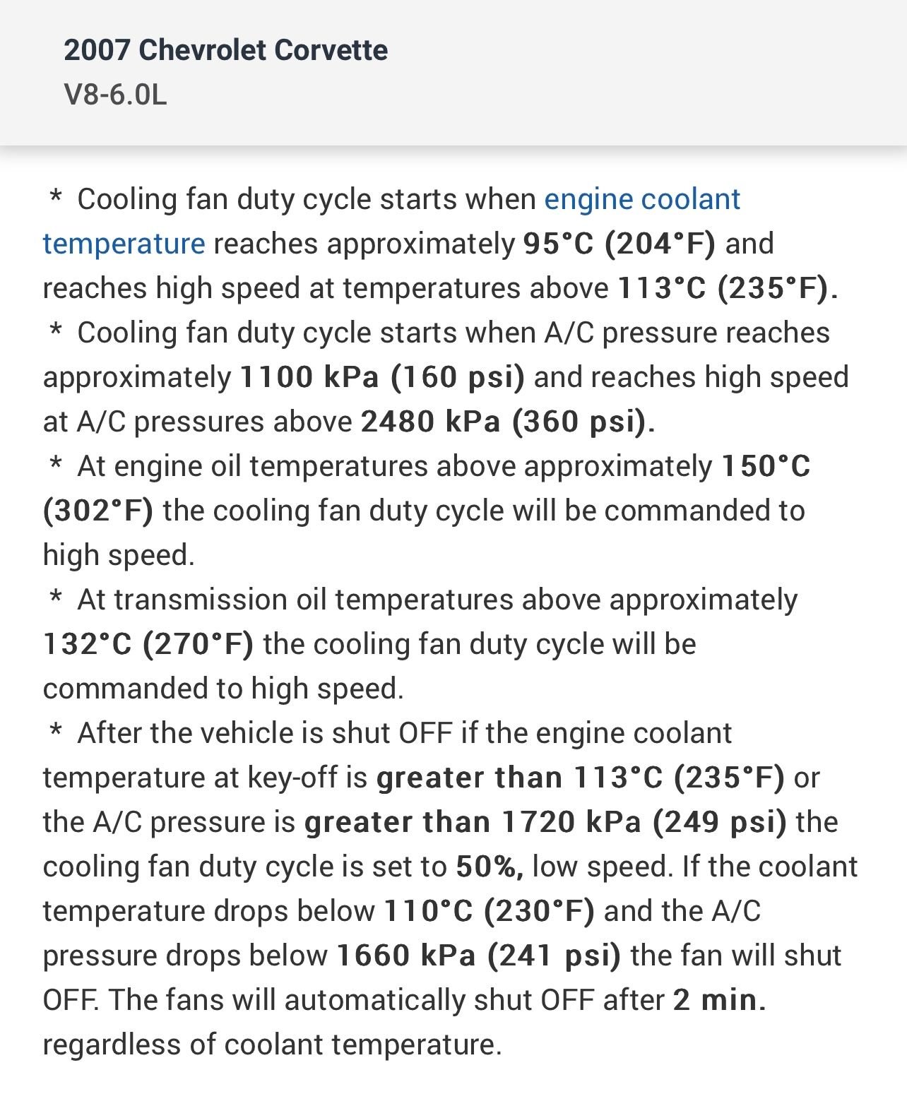

I am wondering how the cooling fan comes on, is it when the AC is turned on or is it when the coolant gets to a certain temperature?
I’ve been getting conflicting stories about this. Checking my system to make sure when or how the fans will come on and making sure I do not have a problem. I checked the fan harness and that is looking brand new. I will be checking the fuse with a multi meter to check that is not bad. Any suggestions?

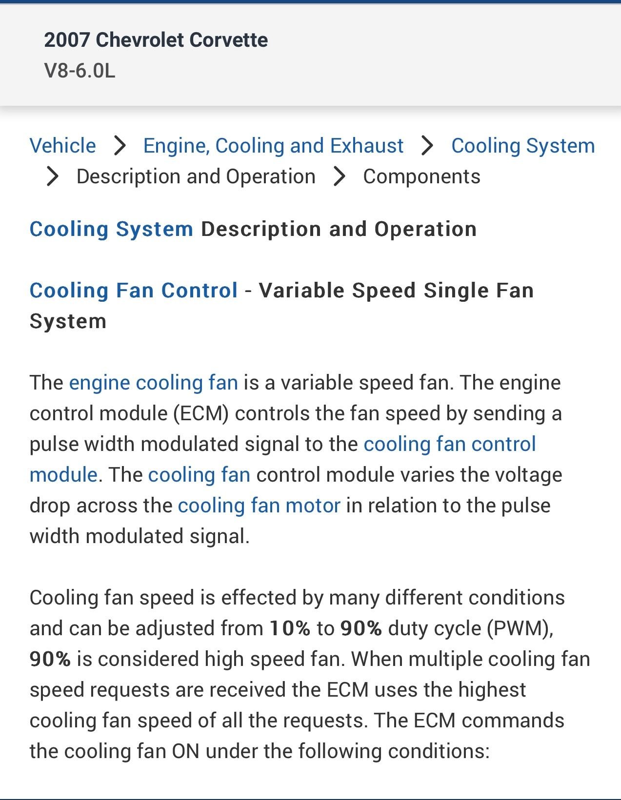

There is no conflicting info if you look at Service Information.

This is great C5 Diag! Now I know for sure and this will help me out and all others too.
Thank you
