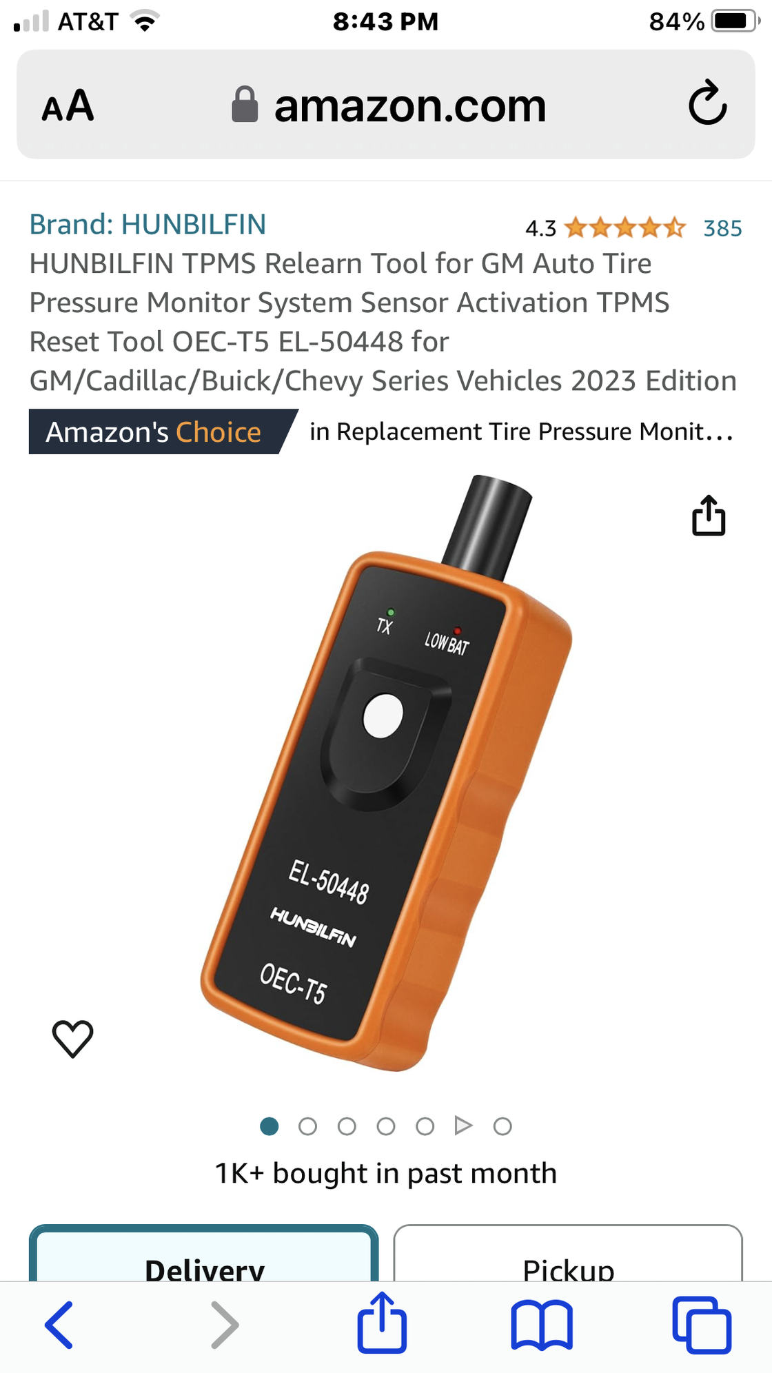

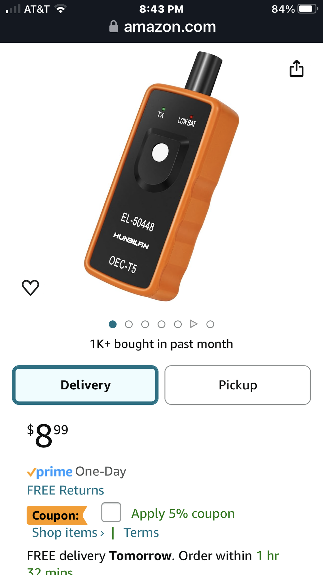

Old May 23, 2024 | 09:02 PM
CorvetteCam91ZO7's Avatar
CorvetteCam91ZO7
Joined: Mar 2017
Posts: 643
Likes: 93
From: MA
Default The tool is very inexpensive
Especially if doesn’t have a Corvette logo that a lot of corvette vendors put a sticker on and suddenly it is $100.
I have used mine for years and I paid under $10.00
they sell them with air pressure gauges etc
I think I might have got mine on eBay but it took a little time to get to me
Amazon prime and it’s on your porch by the weekend If I remember in the air you put the vehicle in Acc mode and press the lock and unlock button till horn beep and then you go left front tire press relearn tool button holding it till horn beep then release button clock wise then go to next tire holding the button with antenna of tool at the valve stem after horn beep next tire same procedure then ending on rear driver side press button and hold toll double beep BACK IN BUISNESS GOOD LUCK
believe me it’s so inexpensive I figured it would not work I have used mine multiple times and just pull out the 9 volt battery when I am not using it
