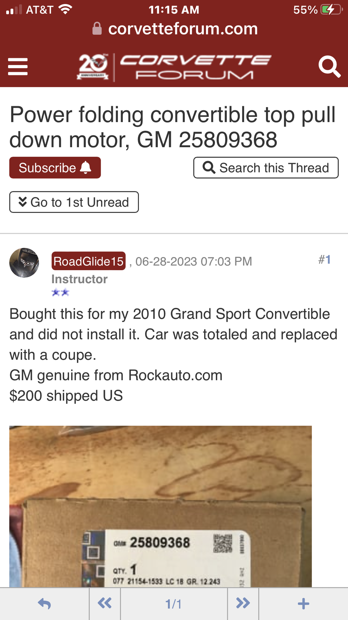

This part is not mine . But it is for sale on the forum very reasonably priced especially for a discontinued part brand new AC/DELCO

Default That part
Is SOLD
