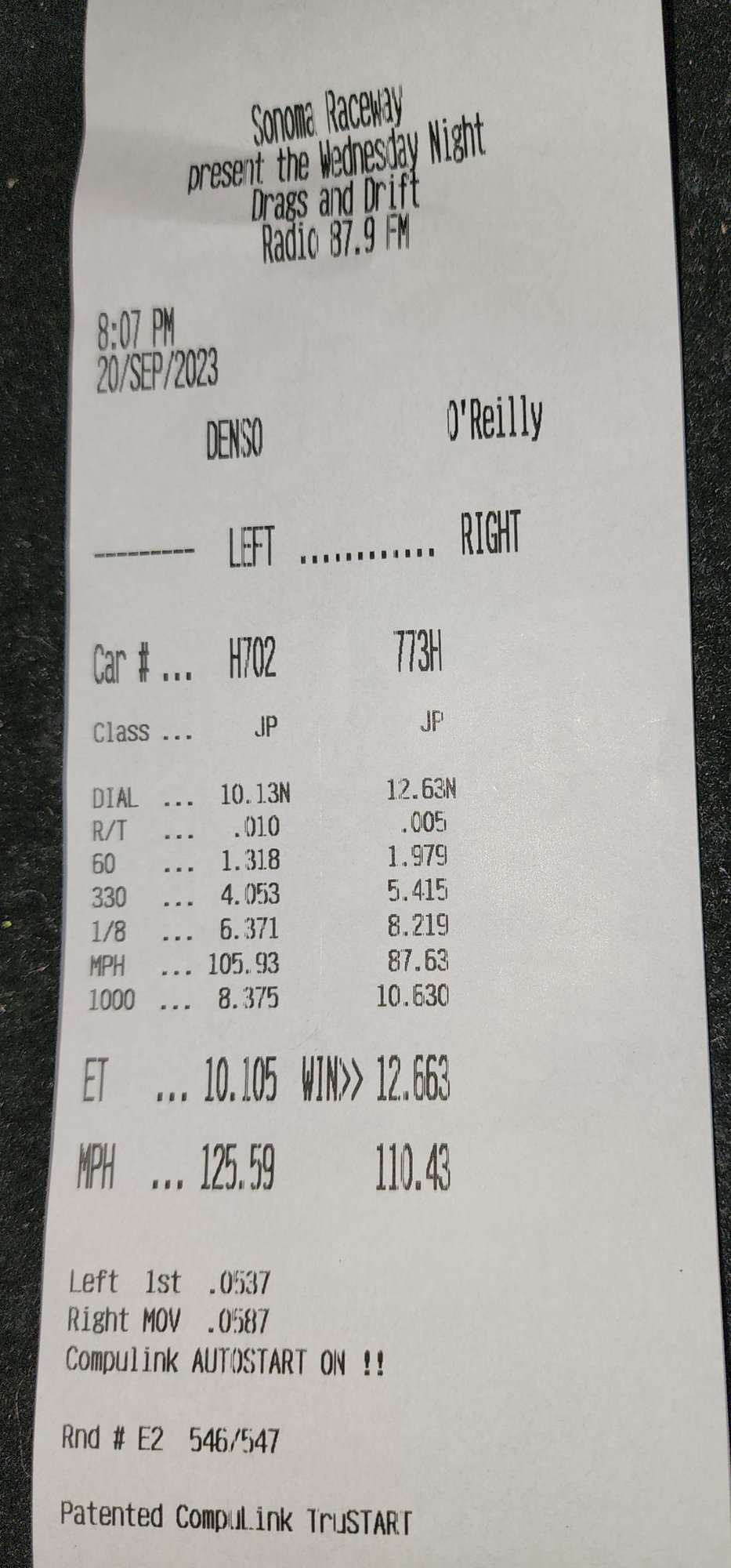

Also, you can run some pretty stout numbers with just a base model 2.56 differential. This was from late last year (I'm on the left):
