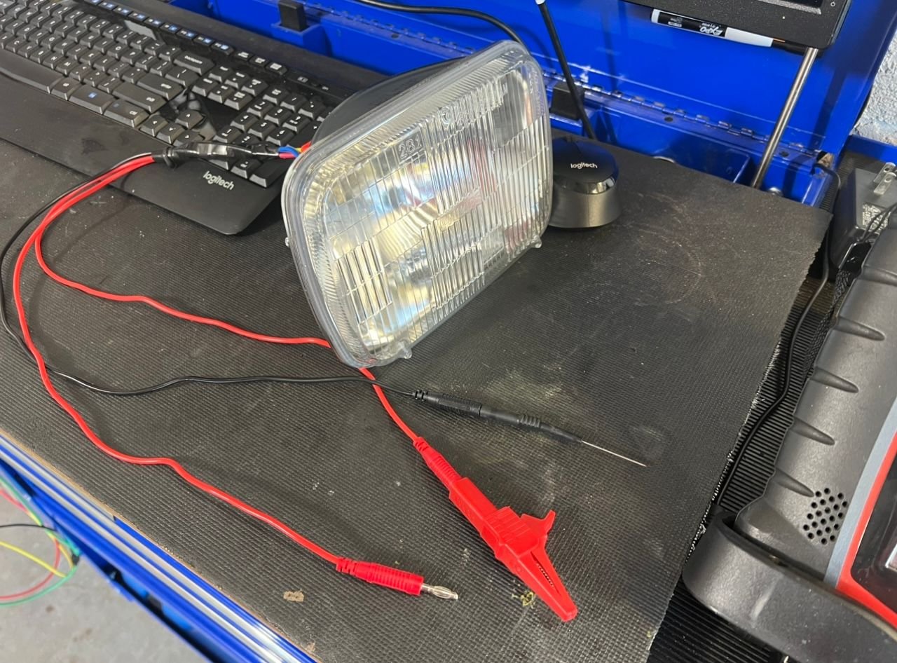

How did you check for power and ground at the harness ??…if you used a DVOM and you have 12 volts that doesn’t tell me anything !!…how did you check the ground ??…you have to “load” the power and ground and see if they can do the “work” or carry the current….I use different size headlight bulbs of different amperage’s (watts) to check if the wires are able to handle that current…the fuel pump draws around 8 amps so that is the size bulb I use…if the bulb burns bright I know it can carry the load….to check for power did you jumper terminals 87 and 30 at the relay (the load side) ??

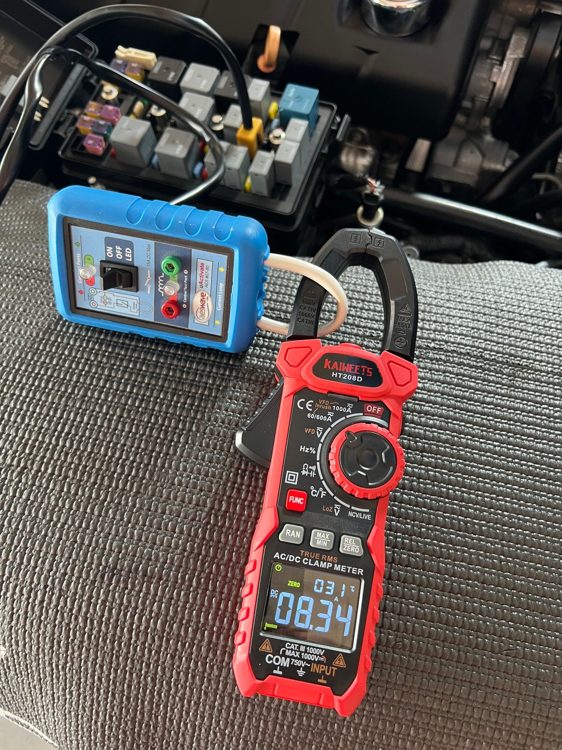

Just an FYI..... some parts stores, like this one at Autozone, carry free loaner relay circuit testers.

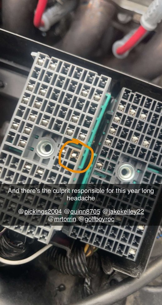

So I took my fuse box apart again and did some visual inspection and probing around put it all back together hit the starter button and she fired right up. I just don't get it I'm beginning to think I have a bad connection in the fuse box somewhere. Any thoughts?

Start with removing fuel pump relay, and jump the fuse box relay with spade connector on both sides of the wire.
This (spade widths) will also help to weed out problems with U connector in upper fuse box for relay burnt/spreed open, where you may have to open up upper fuse box to correct.
If no pressure at the rail with jumper in play, then pull upper fuse box, and check lower block female connector to see if it bent open, burnt or pushed down in block so upper male connector does not get a good connection to it.
If still no rail pressure, leave jumper in place, start with probing wire out of fuse box to back of car for fuel pump up under the hood, then go to back of car at fuel pump location on driver side, and make sure you have power on that connector for the fuel pump as well, with problem the fuel pump not working in the end/tank needs to be pulled to replace it.

Just want to say thanks for all the help and advice, the problem was on the fuse box it was a bad connection at the fuel pump relay.
