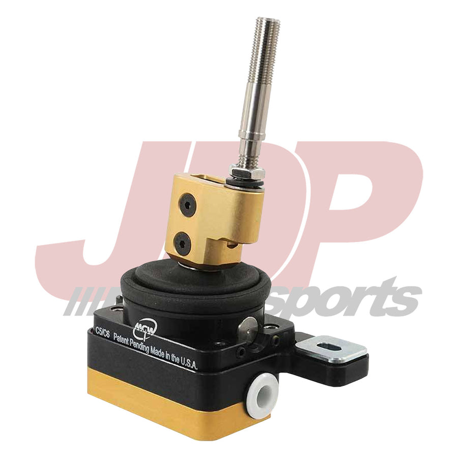

As for solution, since factory shifter boxes do tend to wear out quickly, look at picking up an MGW shifter, that will come with a new lower box as well.

Delrin is a type of plastic, and you just lathe up a new one, to replace the old ones in the box that have failed.
On the MGW lower box, it come with delrin bushing,and you can buy drop in replacements if you do wear them out over time.
