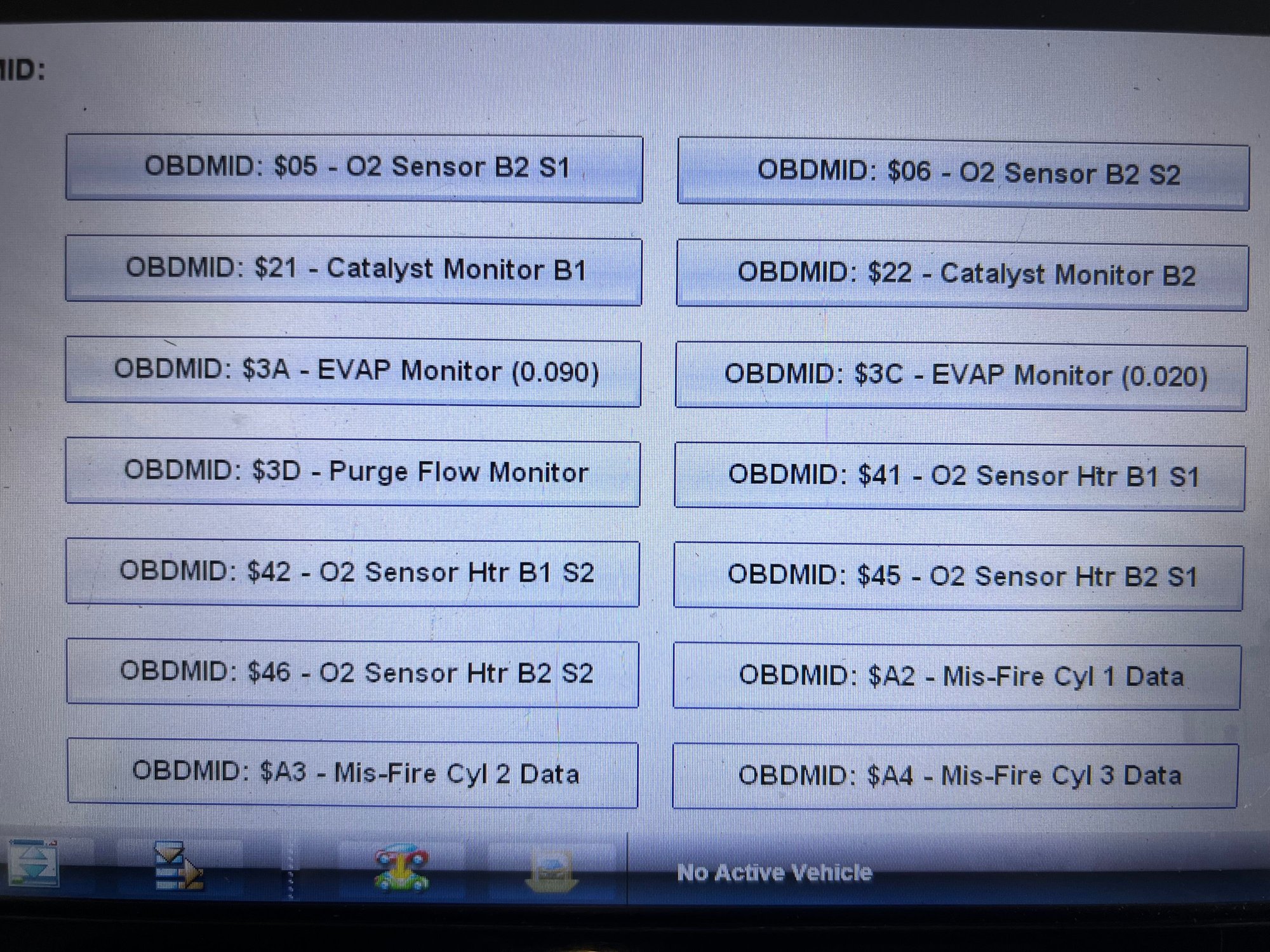

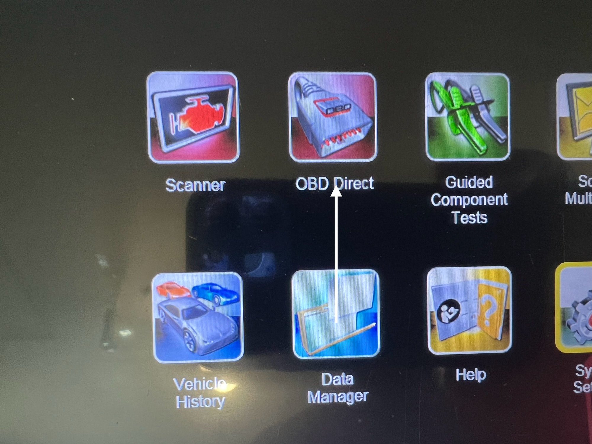

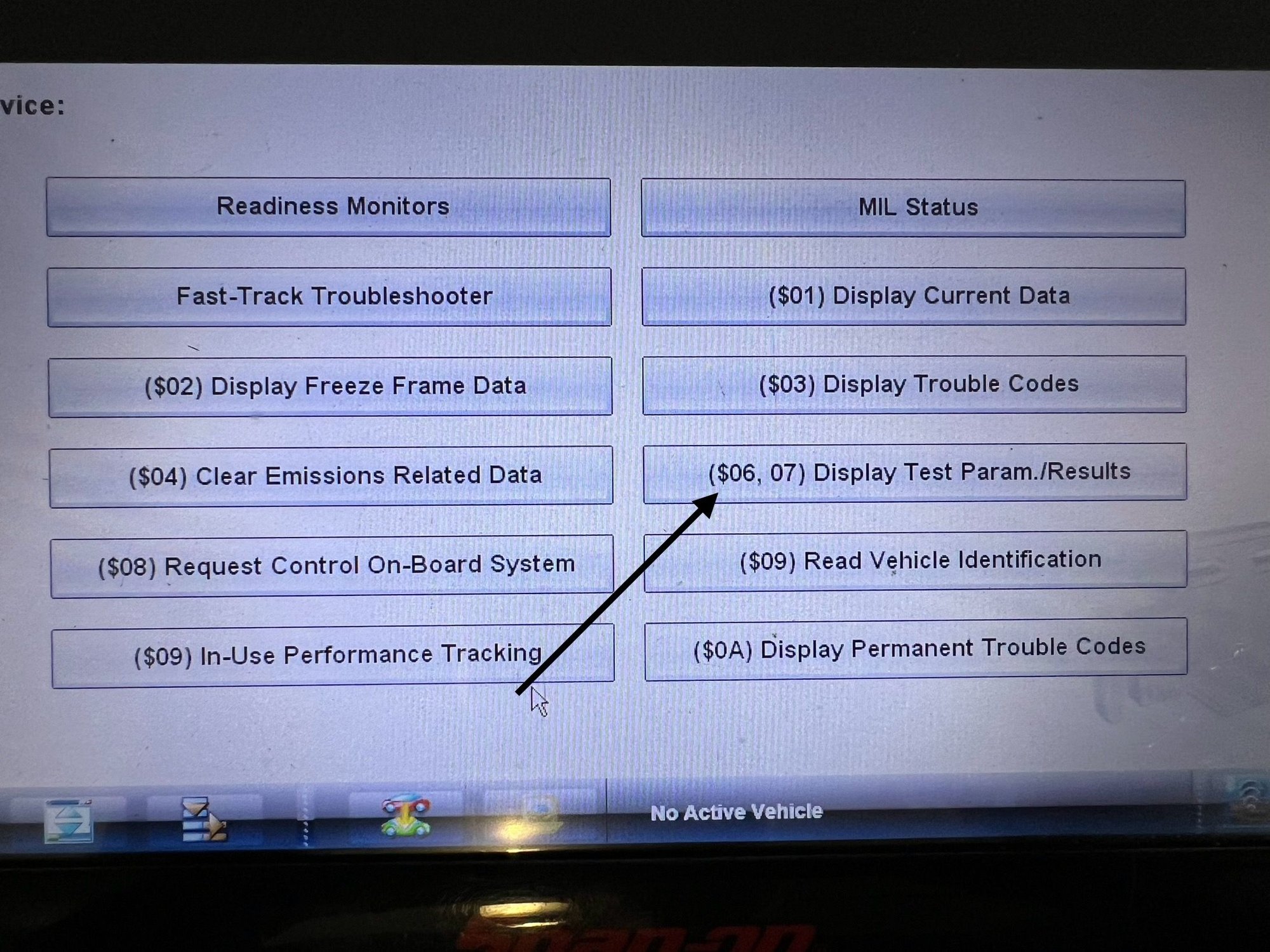

I don’t know what scan tool you are using but when you first turn it on you may see a check engine light symbol…in here you don’t enter car make, model, etc… you enter there are you would see 10 modes…mode 6 is “display test parameters” or whatever your scan tool displays…my Snap On Verus Pro menu is displayed below…your scan tool may also say OBD/EOBD !!…mine says “OBD Direct”…Mode 10 ($0A) came about in 2010 but not put into full usage till 2012..these are permanent codes which your P0300 is showing…Mode 6 video below…your scan tool may also show misfires in “Enhanced or Factory” OBD2 where you do enter make, model, etc…don’t know whether you are using a “code reader” or a scan tool ??
