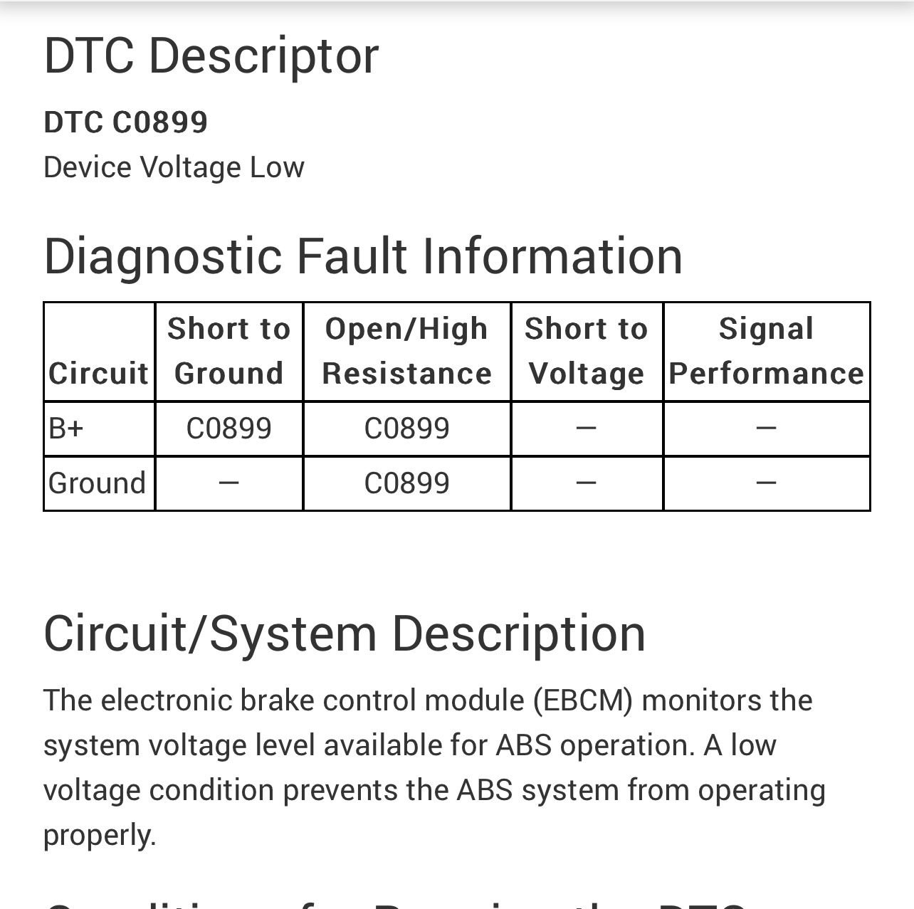

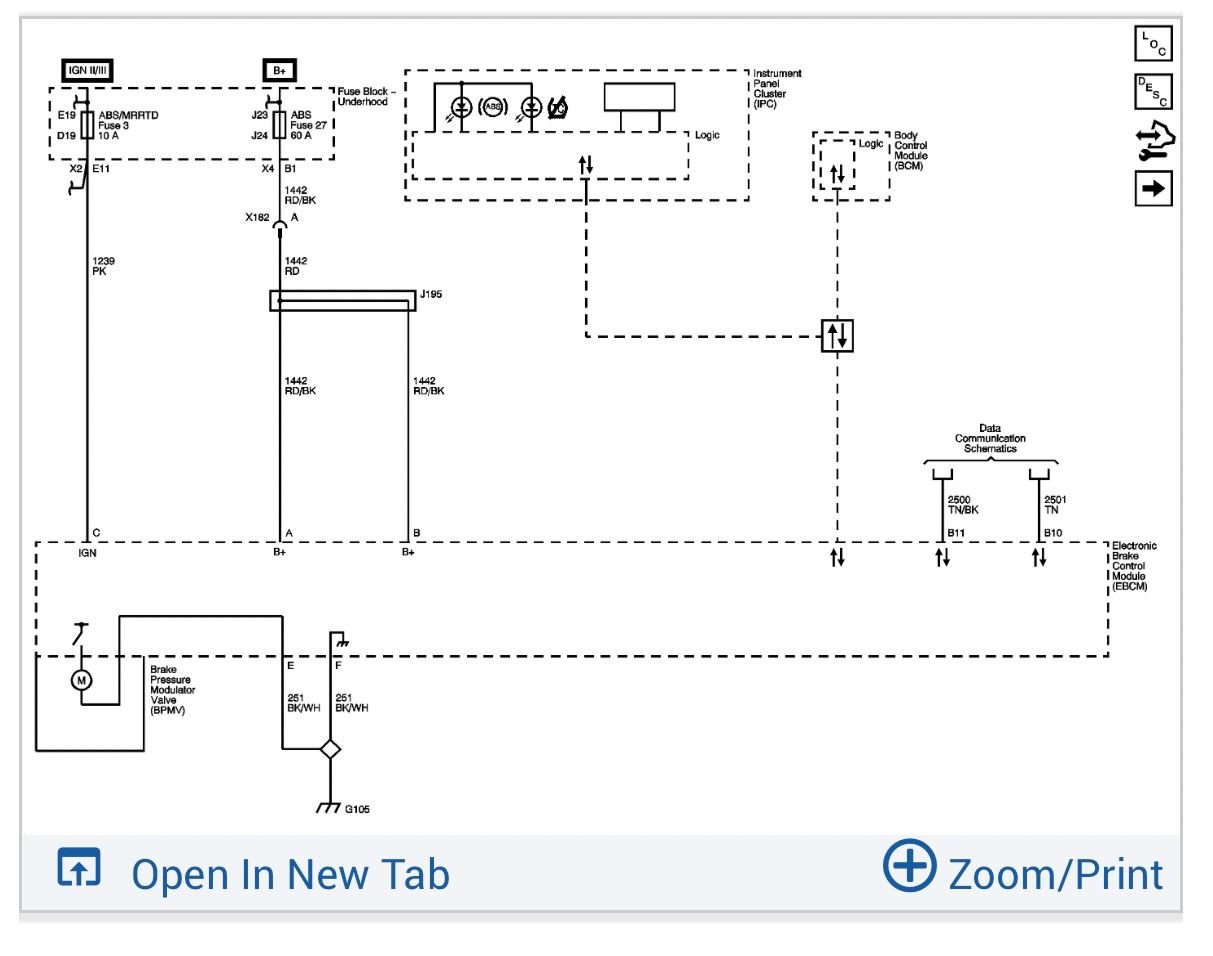

Looks like a few low voltage issues so if your battery is reading 12.5 volts that is 80% charge and if you have an AGM battery and 70% if you have a FLA battery…below is description for your C0899 so if the voltage to the EBCM is less than 9 volts for 1/10th of a second so that’s pretty quick…since you are seeing this condition during starting I’d check how low your battery voltage drops during starting…if it drops below 9 volts then you have to see what’s causing that…maybe corrosion on the battery cables at the stater solenoid and the engine block ground…you may want to remove the EBCM connector and check the terminals especially the 1 ignition feed and the 2 battery feeds for corrosion…if you are familiar with voltage drop testing I’d check the drop from each of the fuses to the EBCM…one lead on the fuse and other lead to each of those 3 terminals (A,B,C) at the EBCM…max drop is 0.5 volts but should be less than that usually 0.2 to 0.3 volts….if you clean any grounds you clean the ones that may be related to your issue…just cleaning any ground is just a waste of time.

I cleaned those ground because they where related to the BCM which had a low voltage. Ill check the ECBM it does not look like a fun job to even get at it
edit:
In reference to these code is there a way to narrow it down to a specific module? The info you posted on the OEM DTC is much more detailed that any I have found where did you get it?
