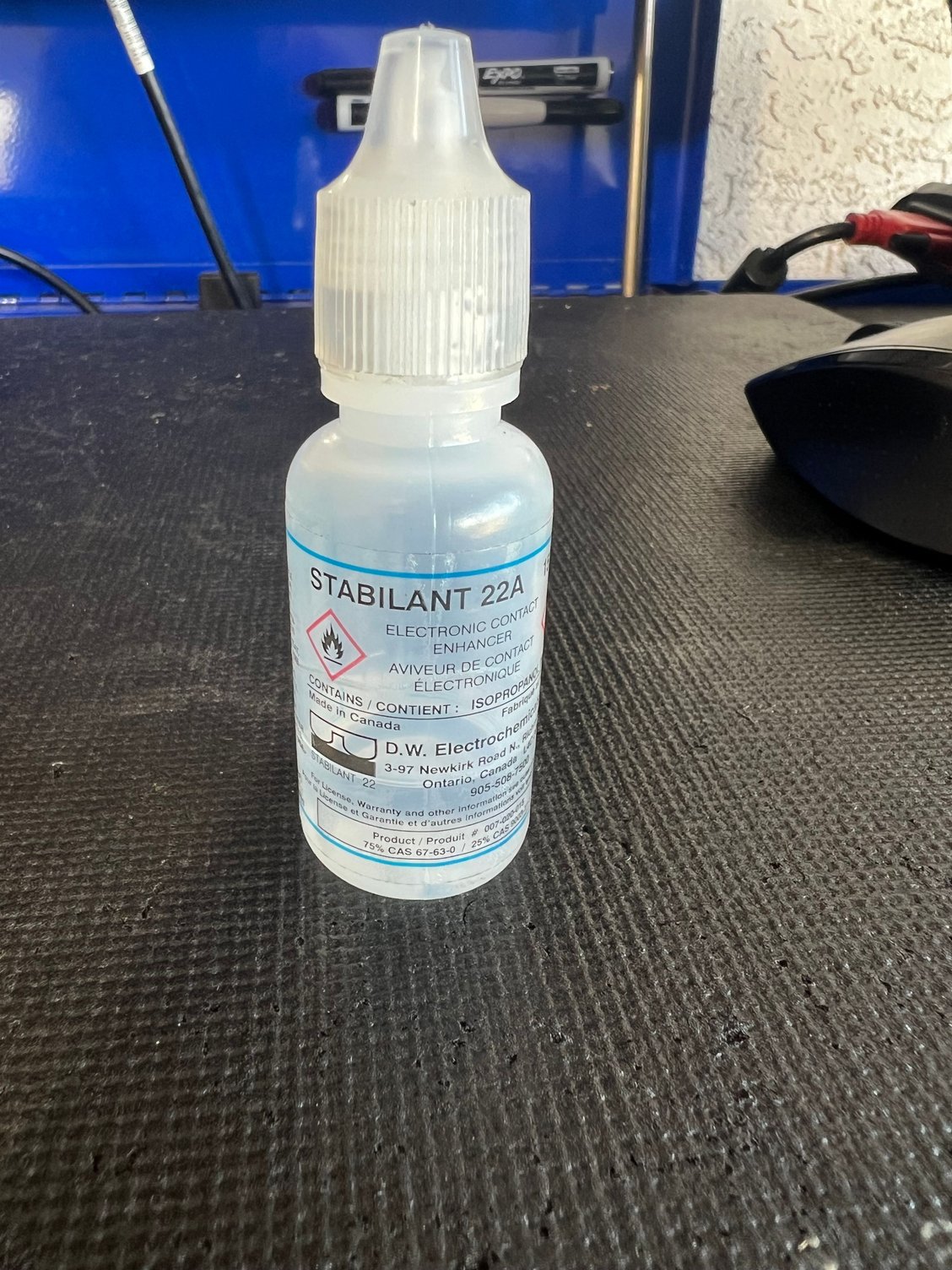

Deoxit for a cleaner and Stabilant 22 which is a contact “enhancer”…pretty expensive at $63.00 for a small 15 mL bottle but the best there is…no dielectric
grease which is an insulator in low current circuits especially air bag circuits which do not tolerate resistance…we used Deoxit in the Airline Industry exclusively.

Deoxit for a cleaner and Stabilant 22 which is a contact “enhancer”…pretty expensive at $63.00 a 15 mL bottle but the best there is…no dielectric
Also specified by BMW.
It's magic!
