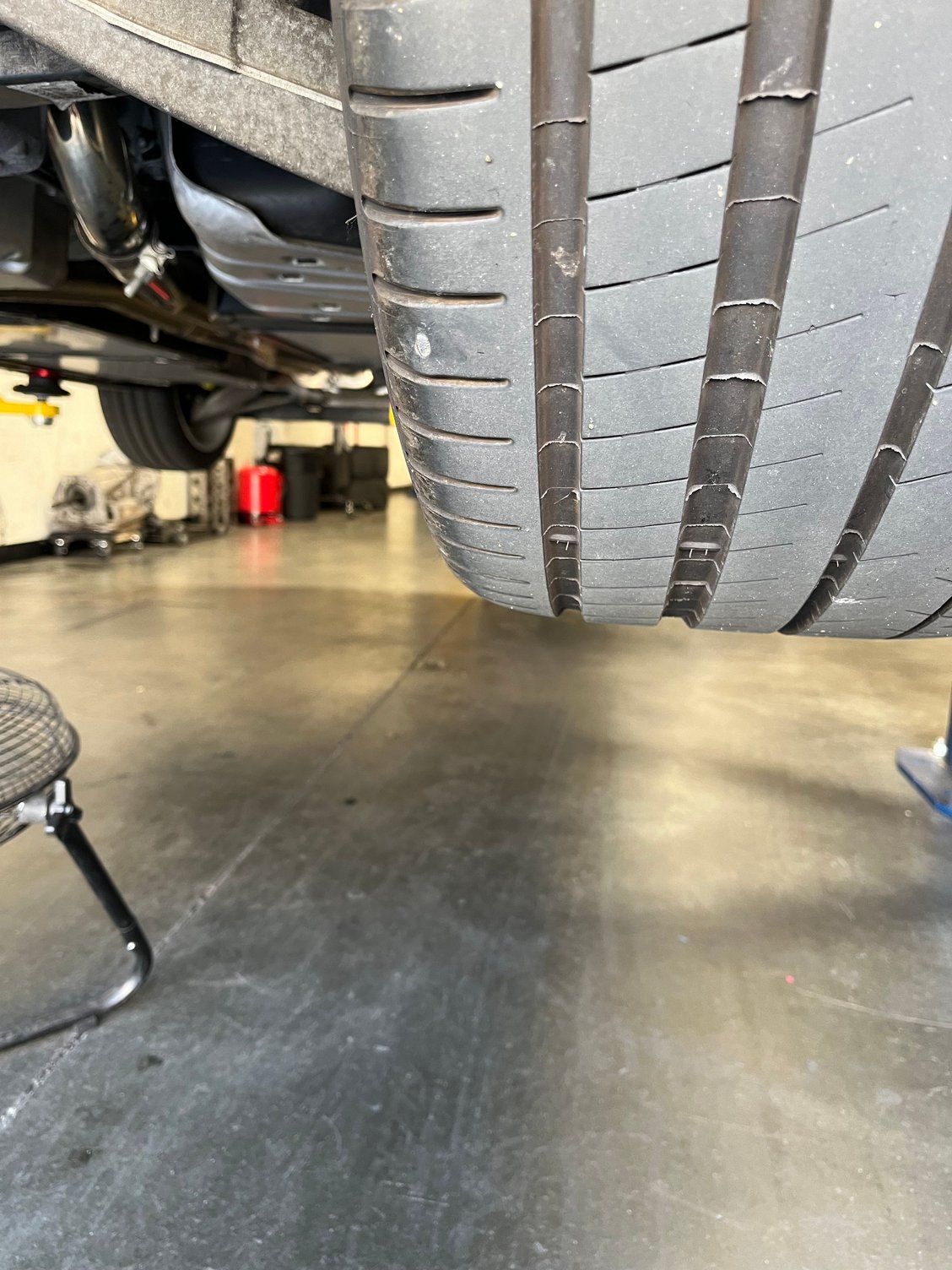

What a day. Started out good. Had my transmission and differential fluid changed. During the service I noticed a nail in my tire.
Drove to America’s Tire hoping they could fix it. When the tire representative came out, he asked me to put the car in reverse so he could see the nail. The shifter cable just moved up and down and the Corvette would not move. The nail was never looked at.

In your picture, that nail is near the side wall. That is not repairable. New tire time.

Took the Corvette to a tire shop. They pulled out the nail. It was about 1/4 inch, and cery thin. It did not go thru the tread. Somehow it went it sideways. Tire was tested and there were no leaks.
